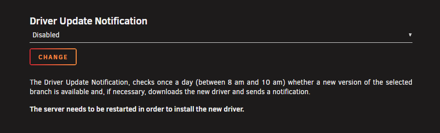

Here. If Enabled, will download the latest driver version and send a notification. When rebooted, the new driver takes affect.

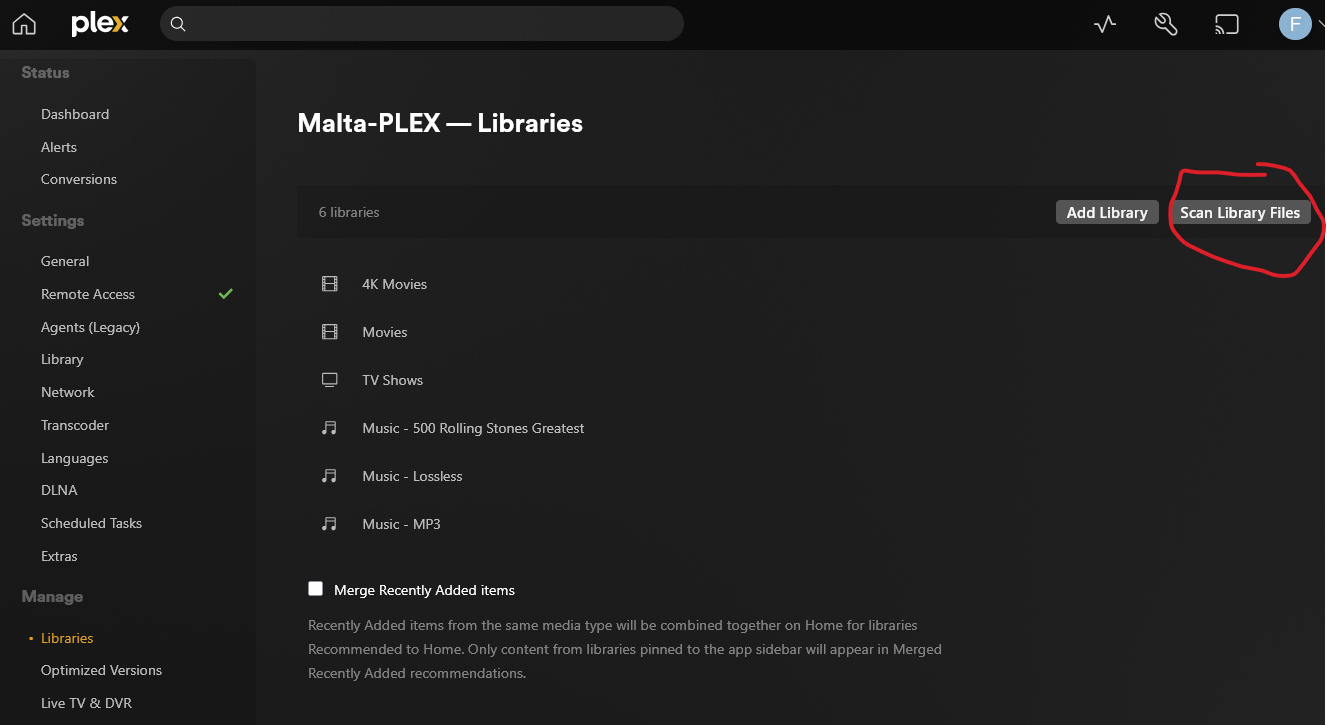

New downloaded movies not showing in Plex

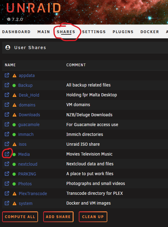

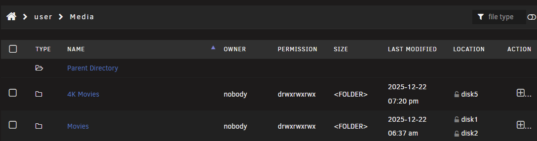

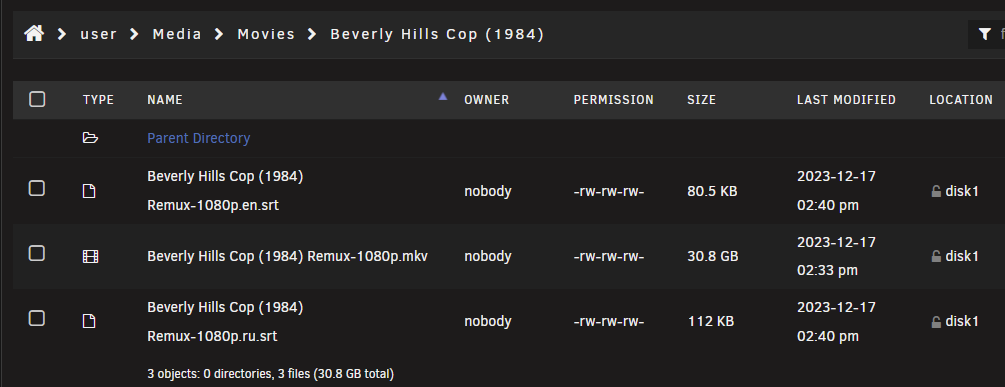

Unraid's File Manager works like most computer directory interfaces (like Windows Explorer, in Details view) Click Shares and you will see a list of your shares. My media is in the Media share (imaginative, ain't I?). A Share in Unraid is basically a top level folder in Windows. If you click on the icon to the left of the Share's name, it opens the share (folder). I'll move down to a movie in my Movies folder: Looking at the screenshots above you will see that for both the sub-folders and the media, the OWNER is nobody. The PERMISSIONS are allowing everything for folders, and allow reading and writing for the media files (you can find many video or text tutorials on Linux permissions, I'm not going there today). We have no idea how you are downloading your media, how that is configured, or if the media is where Plex expects the files to be. So you need check just where the files are (in the correct location for Plex to find?), and are the Permissions and Owner the same as the Media files Plex is able to read (this can block a program/user from seeing/using it).
This is in almost everybody's log. It means that Plex did not find any USB TV tuner device. Ignore it, unless you are one of the few people left on the planet using one. Two things to check next: Are the files in the correct place? Confirm they are in the location that is specified by Plex and your Docker template mapping. (If in the same path as other media Plex can see, you are probably good) Check file Owner and Permissions. Use the built in Unraid File Management, and see if the unseen files are the same as the one's you can see in Plex. However you are downloading files may be setting this in a way that prevents Plex from seeing them.

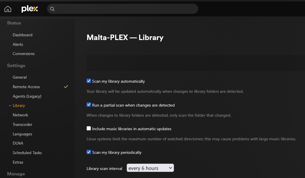

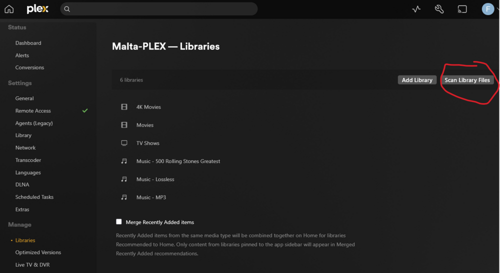

I would first check your Plex settings: If this is set correctly, new media should show up in a minute or so when added to your Library. If not, does it show after manually rescanning your Library?
