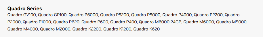

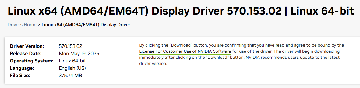

  13. Untrue. While the Quadro P Series of GPU is in line to be fully deprecated, they are still fully supported in the most current Production Branch Driver. https://www.nvidia.com/en-us/drivers/unix/
