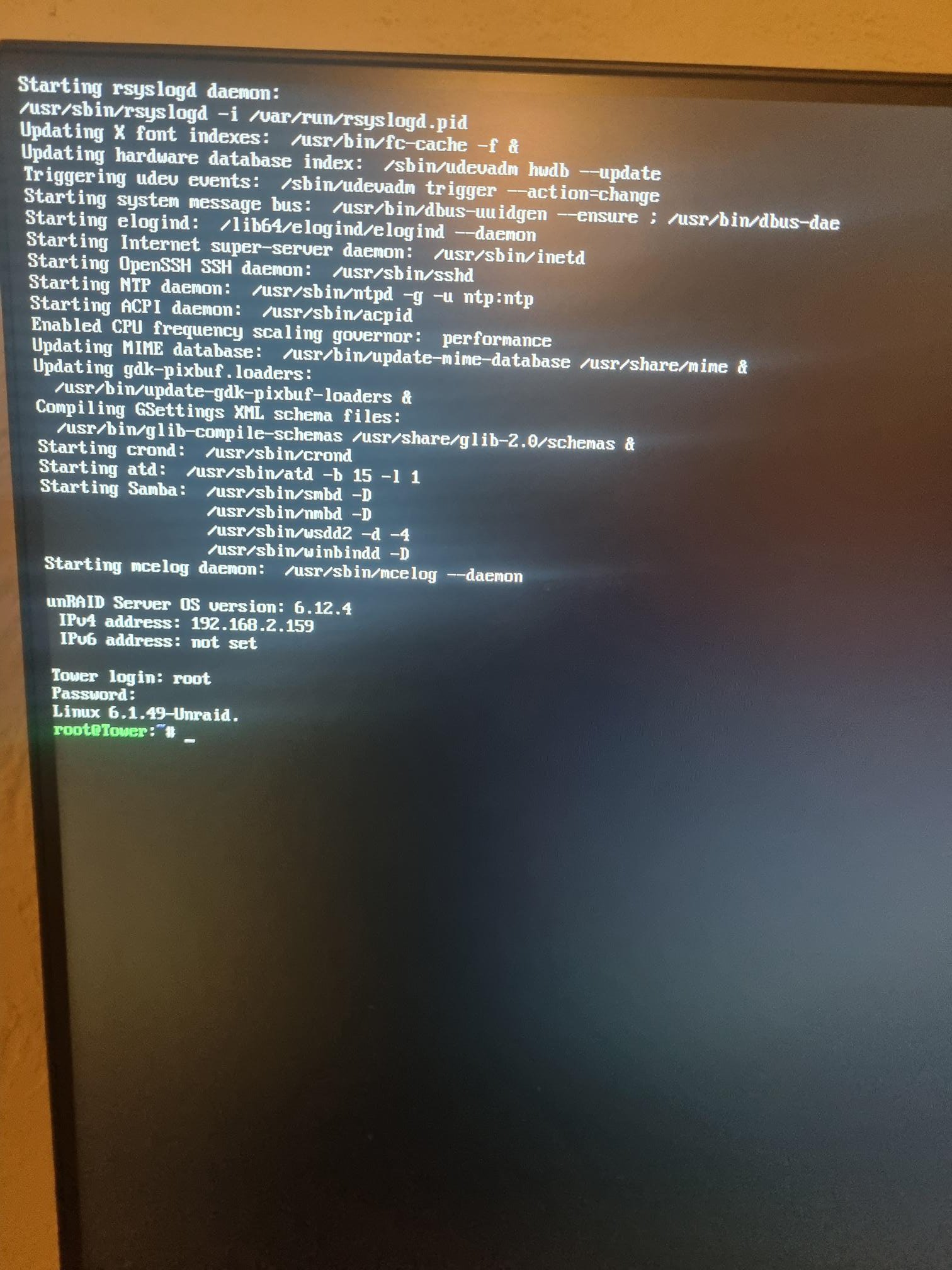

Can't acces unraid from LAN
Solved. My switchdied somehow.. I just restarted the switch and my server was back online. Thanks everyone!
Hey, I did try to reboot first. After the reboot i took the diagnostics that are in my first post. Also, before going to work this morning I tried to start up the server again but with the same issue So totally i've restarted the server 3 times now. Could it be the NIC on the mobo that are dead?
Hello, I can't acces the web gui from my LAN. It worked fine some hours ago. I have not installed or changed anything on my server the last 1 or 2 weeks.. I can't access my dockers either. So i assume that something is wrong. But I can acces the "shell". Could anyone check my diagnostics? I had similare issues a while ago when my boot-USB died. Maybe my new drive also died? Thanks.. /G tower-diagnostics-20231108-2129.zip
