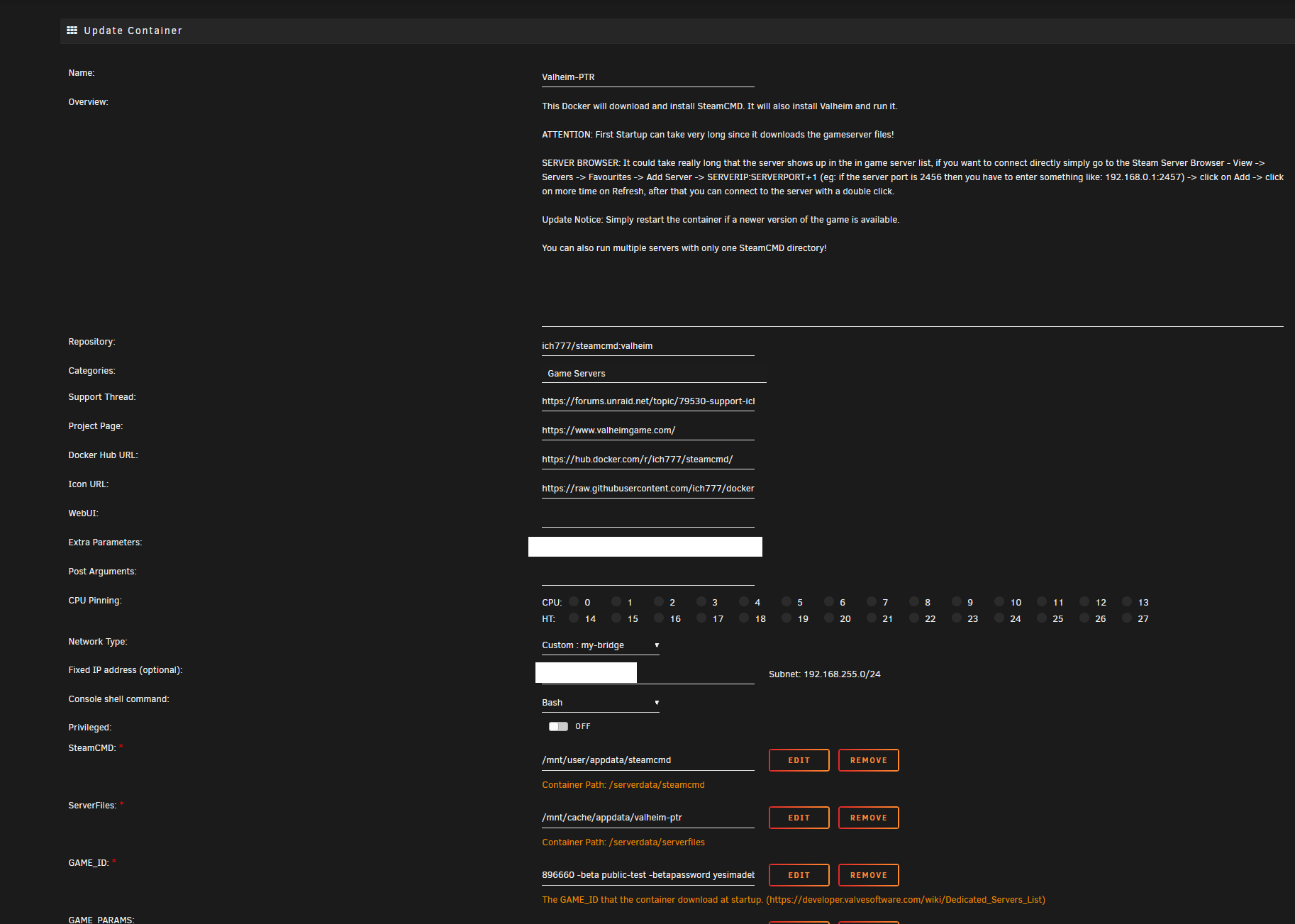

  4. A hack is using something that is meant for one thing for another. In the template, under game_ID, is just say to input gameid from a list. I also don't see anywhere that it says to use this to pass other command to steam. Maybe I got the only template without that info? Still, if a param says GAME_ID, I don't expect to input anything else under GAME_ID. Does it work? Yes, I'm not saying it doesn't. I'm saying it's far from obvious that other steamcmd should be enter under this param, specially when there's so many other variable and even a game params one. I'm simply offering a suggestion that would simply make it easier to see "hey there's a place to put steam cmd" that will change 3 lines in the exec script. In the end, you're the owner, you do what you want.
  5. My search failed when I search for the word ptr thus I didn't see this post. But again, I understand it work with the var GAMEID but wouldn't it make the template cleaner to have simple STEAMPARAM so it's explicit? This is more of a "hack" if through another param that just happen to work.
  6. Hello, I'm trying to spin a Valheim PTR server. According to doc, I just need to add "-beta public-test -betapassword yesimadebackups" to the launch. I tried adding it to gameparams but it doesn't seem to work. When I try to connect with my client, it says version missmatch. Thank you edit: I found out why it doesn't work. It's a steam command. Could you update the start-server.sh script so we can add custom Steam CMD from template like the GAMEPARAMS does for the game launcher? would be great for any of the steam game in the end. For now, I replaced the script with modified option, but since it's in a place where files aren't saved between container reload, it's not a permanent solution
