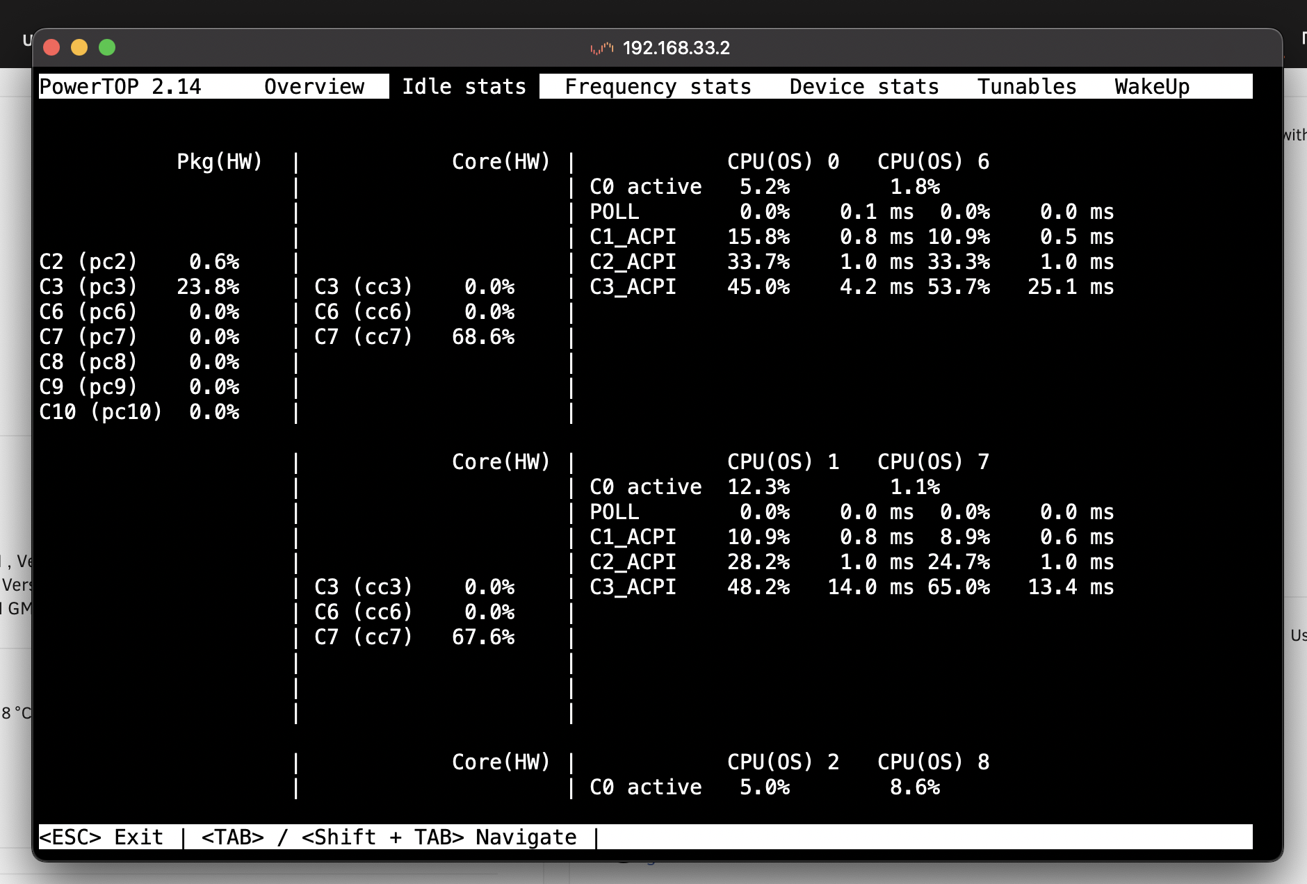

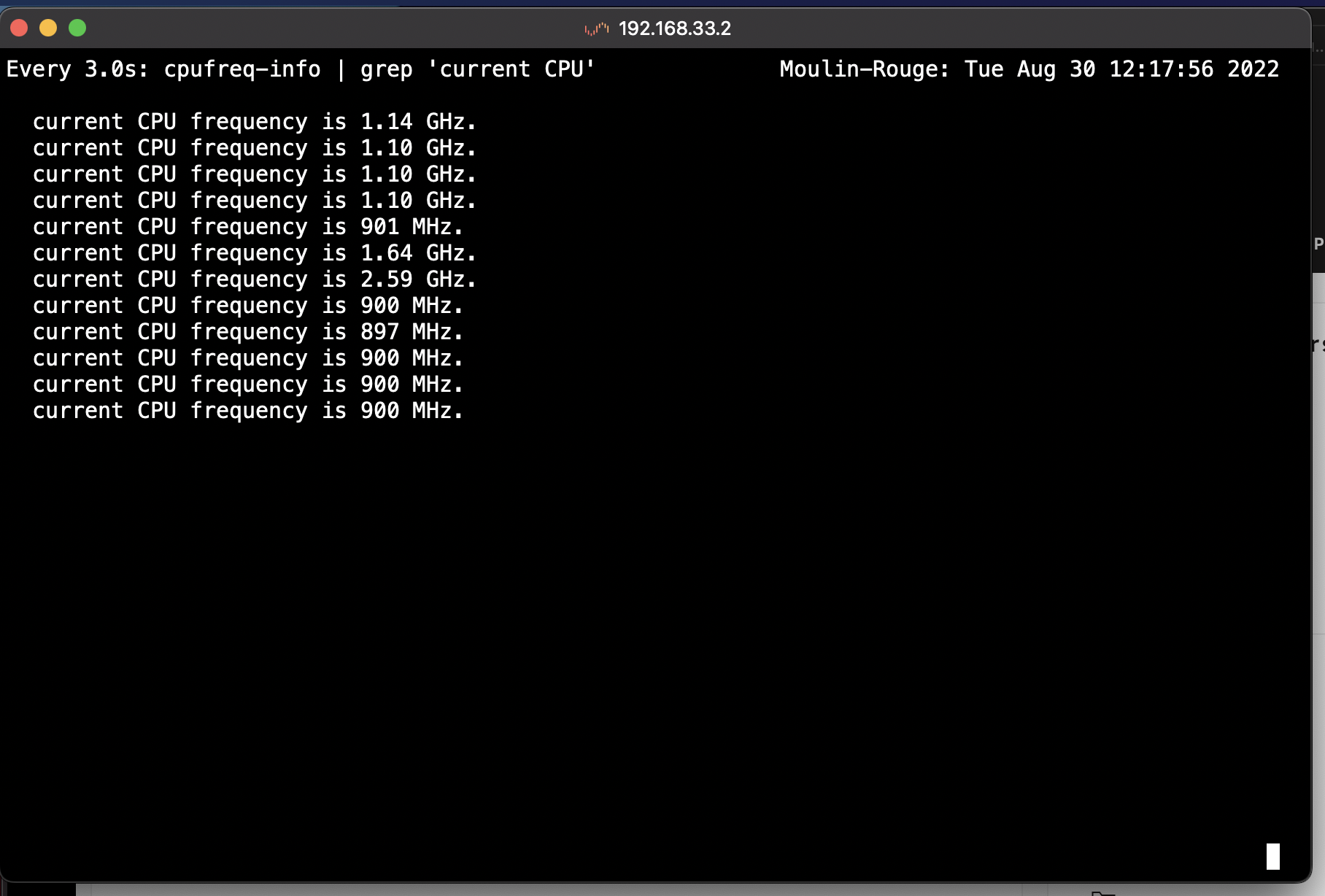

  15. Any recommendations for a x1 flex cable to fit under a GPU thats covering up a pci port? I have a gigbyte 560m d3h with: PCIe4 16x - Nvidia rtx a2000 double width GPU. PCIe3 1x - Covered by GPU but hoping to use a flex cable to run a sata extender 4x card. PCI - OLD School PCI port (no idea why they didnt stick this f*cker under the graphics card instead of the PCIe3 x1 slot.) PCI3 16x - 10g card in here - card is x4 size. I did buy this old pci sata card but obviously will be bottlenecked https://www.aliexpress.com/item/1005002598521420.html?spm=a2g0o.order_list.0.0.3bc41802TrMTlW Better option is use a flex cable and mount the PCIe3 1x card slightly higher on the OLD SCHOOL PCI space. I note you can get 10g network cards with 2x m.2 slots built in... but sata ports would be more useful... https://www.qnap.com/en-uk/product/qm2-2p10g1tb
  16. @Aldamir I couldnt get the autotune thing to work so I did it manually... Which motherboard have you got? On mine you press f12 as it boots up on the first screen. This brings up the boot loader. At the bottom is an option for setup (bios menu) Loads bios. Choose advanced menu. Tweaker. Change most things from auto to enabled. Turn turbo boost to disabled. Anything that has more settings than auto/disabled/enabled leave on default settings. etc. Other setting is under sata settings in the bios menu. Choose enable devslip for all ports. Then save and exit. PC reboots. Load unraid. Login and run pftop again and you should see most of the settings are now good rather than bad under the 'tuning' heading.

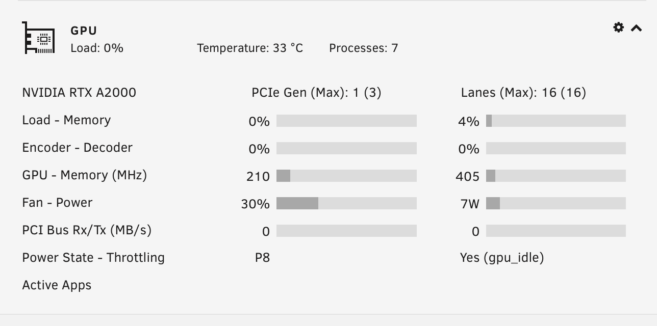

  17. I went into bio last night and changed all the tweaker cpu settings to (enabled rather than auto). I didn't touch the settings where you can completely control the cpu just enabled all the c states and disabled tubo boost. It now shows its reaching c3. You can also force the gpu to idle in p8 rather than p0 by typeing in terminal 'nvidia-smi --persistence-mode=1' This has brought the gpu from 25w down to 12w. To make it permanent you could make a little script that launches on array start. #!/bin/bash #nvidia-smi --persistence-mode=1 nvidia-persistenced fuser -v /dev/nvidia*
