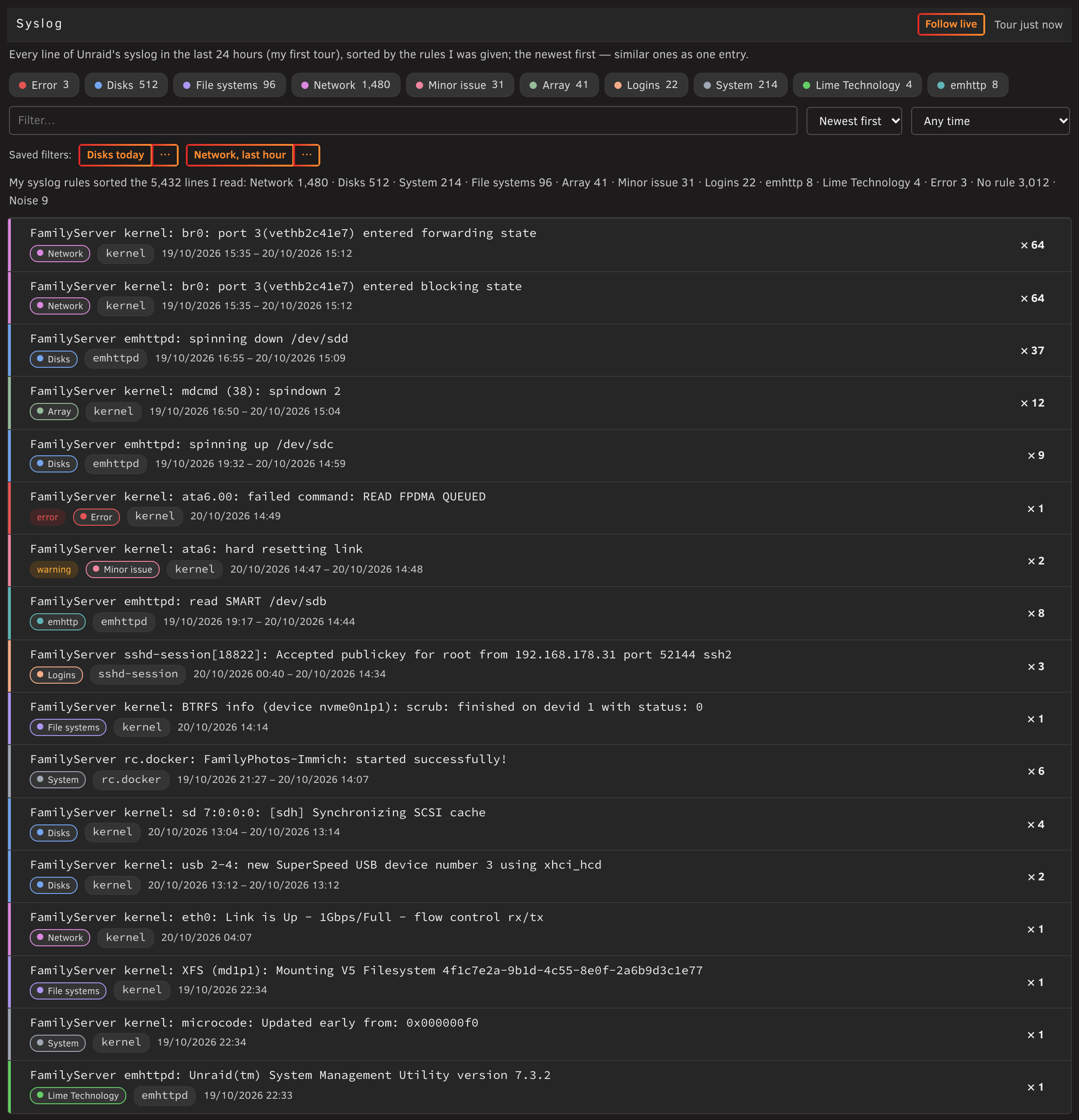

As promised, a short report back: the rule set is in. Ms. Protocolli sorts Unraid’s syslog with Enhanced Log’s rules, shipped unchanged, with Dan Landon’s copyright and the GPL notice kept in the file and the credit to both of you in the README. Her Syslog tile shows the counts per kind (disks, network, file systems, logins, system, errors …), a label shows one kind alone, and you can add your own rules and hide words on top. Thanks again for the years of work in that file. As of today the Unraid Secretary Office isn’t in Community Applications yet (the listing is in review). Until then it installs like any plugin: Plugins → Install Plugin, paste https://github.com/dropnook/UnraidSecretaryOffice/releases/latest/download/unraid-secretary-office.plg — updates then come through Unraid’s plugin manager as usual.

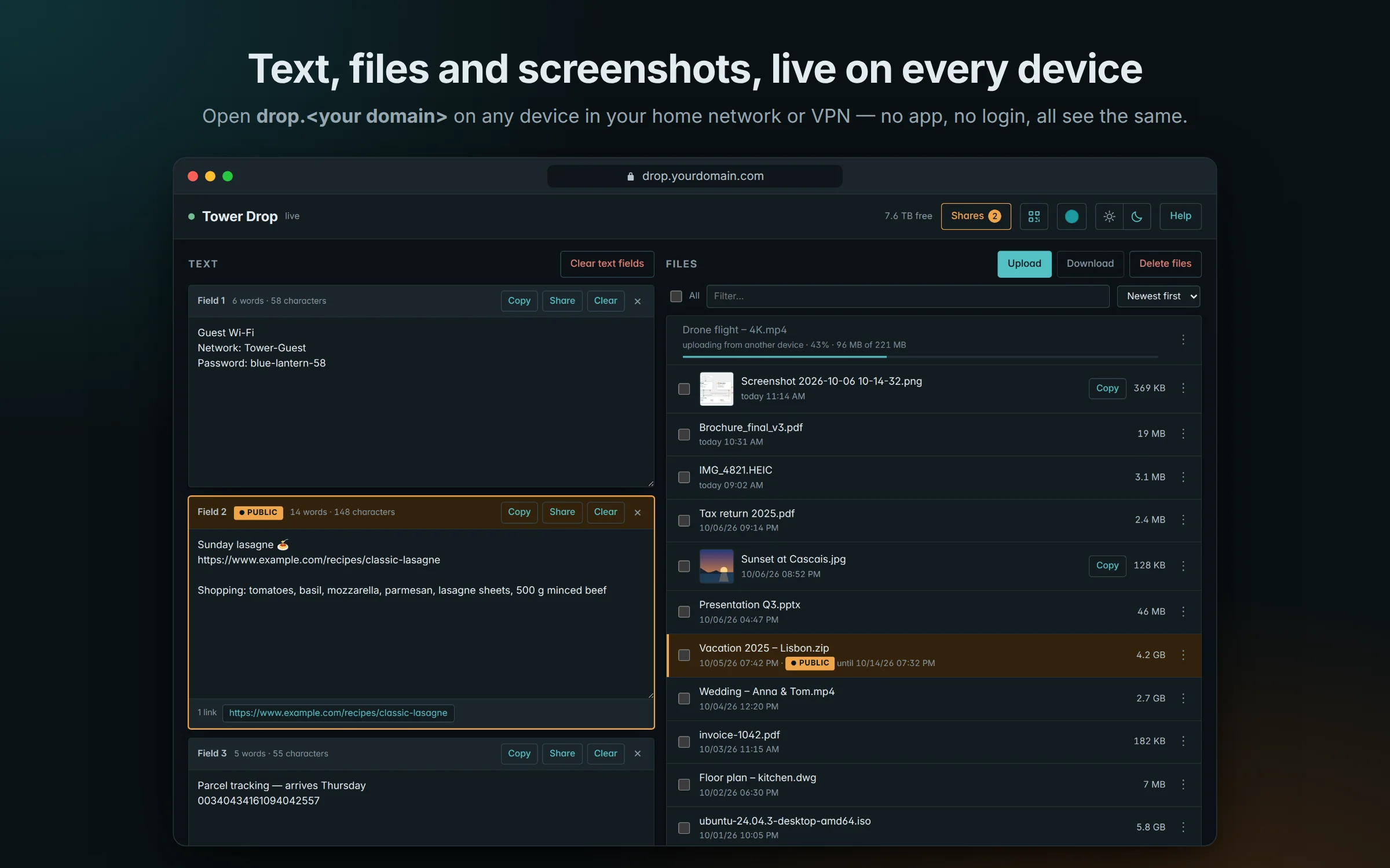

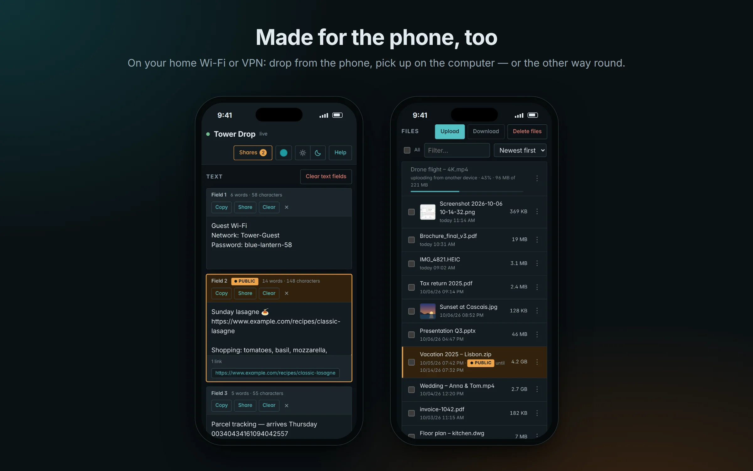

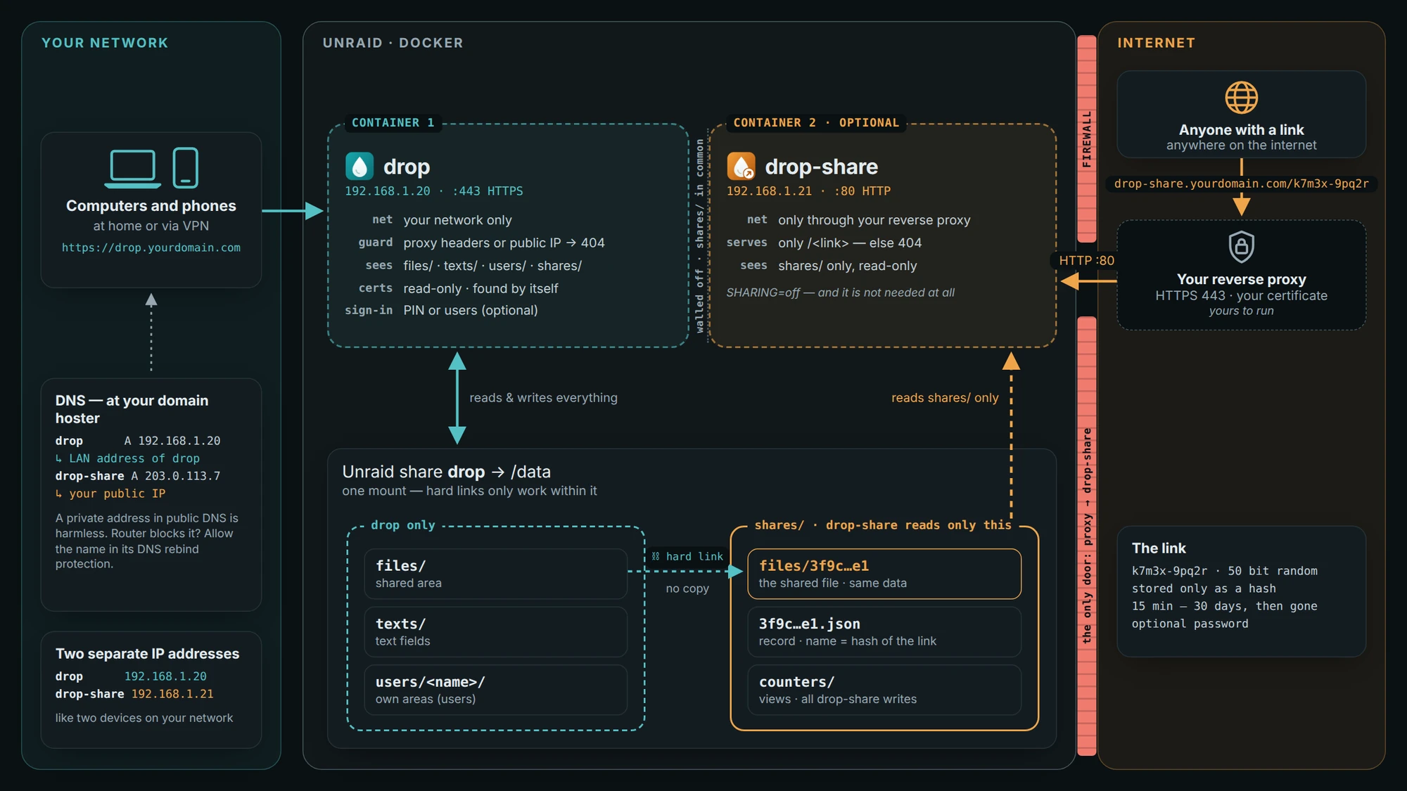

Hi everyone, Drop from Dropnook is instant sharing for your home network — like AirDrop, but for every device. Get a text or a file from your phone to your PC, from Windows to a Mac, from Android to an iPhone: open one web page, drop it in, and it is on every other device at once. No app, no login, no cloud — everything stays on your Unraid server. Made for your own LAN at home. On your devices it is simply Drop — the page calls itself “<server name> Drop”, after your server. Everything at a glance, with pictures: https://drop.dropnook.app/ What it does Text fields that survive reloads and lost connections; uploads of any size, resumable, with progress visible to everyone. Screenshots straight from the clipboard with Ctrl+V; pictures with preview, large view and Copy into the clipboard of another computer. Live room: video or voice for up to 10 people in your network — one click to join, no ringing. Picture and sound go straight from device to device; nothing leaves your network. Needs HTTPS and is meant for your private LAN only. Share to the internet: a single file or text through a link that expires by itself (15 minutes to 30 days), optionally with a password. Served by a second, locked-down container — Drop itself is never reachable from the internet. This is optional: it needs the Compose stack with its two separate containers. Optional users: up to five, each with a PIN, an area of their own next to the shared one, and their own colour. Two ways to run it — same image, pick what you need Community Applications — LAN only. Apps → search Dropnook → Install. One container (drop), reachable in your network only, sharing to the internet switched off. Give it its own address (Custom: br0 with a fixed IP) and open http://<that address>/, or use Bridge with the template’s port 8088. Create the share drop first (Shares → Add Share). For HTTPS — and so for the live room — enter a certificate (e.g. from Cert Warden) under Show more settings. Compose stack — with sharing to the internet. Two separate containers, drop and drop-share, each with its own LAN address, set up with the Compose Manager Plus plugin: Docker → Compose → Add New Stack → paste compose.yaml and the .env from the repo, fill in two free addresses, Compose Up. Your reverse proxy points at drop-share only; Drop finds your existing certificate (Nginx Proxy Manager’s folder is preset) and runs HTTPS in your network, too. Step by step: https://github.com/dropnook/drop#installation What Drop deliberately does not do: no folders (zip them), no recycle bin, no uploads from outside, no live room from outside your network. Updates: the image ghcr.io/dropnook/dropnook:2 follows every 2.x release; after an update every open Drop page reloads itself. Support: questions, problems and wishes here in this thread or as a GitHub issue: https://github.com/dropnook/drop/issues. German speakers: there is a German thread too. I have used Unraid for years — Drop is the tool I always missed for my own home network. Maybe it helps some of you, too. Cheers, Benj
