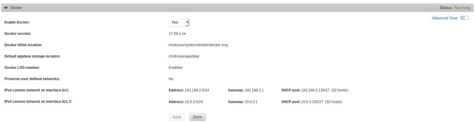

  14. You should be using 6.4.1 as it will make things simpler (unclear from your sig - syas 6.1?) Under the Docker settings (can only change while Array is down) Also refer to:

  22. I guess I was pissed. But I should have seen it coming, I just didn't get to participate the RC to have seen this actual effect. Its still annoying that its an all or nothing approach right now.you should have left custom networks with un-address-ed interfaces alone. maybe that would be a better compromise.
  23. Its not "crippled"... just that it now imposes some constraints that I consider naive and annoying. * Any interface with an IP address will have its custom docker network nuked without asking the user, and a new custom network setup based on the details of the IP address assigned. ** thus a new requirement that unRAID have an unnecessary IP in all custom docker networks. This requirement may sound trivial and not an issue, as containers can't reach unRAID on that IP, but i think users will get confused still and wonder why they can't reach unRAID on that IP. * Any other custom network is nuked away without even giving the user the option to use it. * and worse, there's no behavioral off switch. Workaround: the custom network can be defined after the docker service has started, but dockers on this custom network will no longer autostart. So now all my containers running on a separate VLAN won't even run since the custom docker network is now missing. My PHP sucks, but I think I can make a manually configured plugin to fix this silly limitation for now.
  24. I'm sorry but I'm going to consider Docker network support in 6.4 too simple and naive. With the auto clean up of docker networks, it completely broke my system post upgrade. I'm now going to have to work out a correct way of setting up custom docker networks, without assigning unRAID an IP for my own simplicity. And still having the containers come up automatically. Do you have any suggestions?
