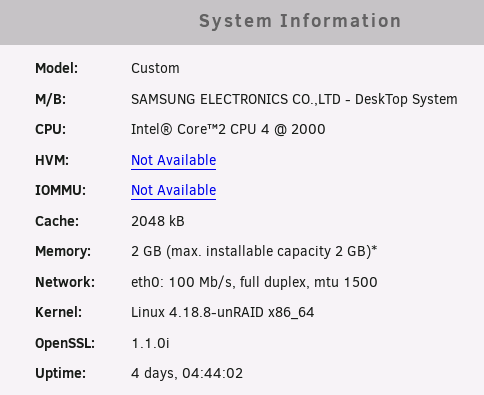

  14. Hmm... 2GB of RAM... do you manually update versions? the Update OS command fails on my brothers machine also with 2GB RAM as there is not enough /tmp space to hold both the downloaded zip file and the unpacked files.
