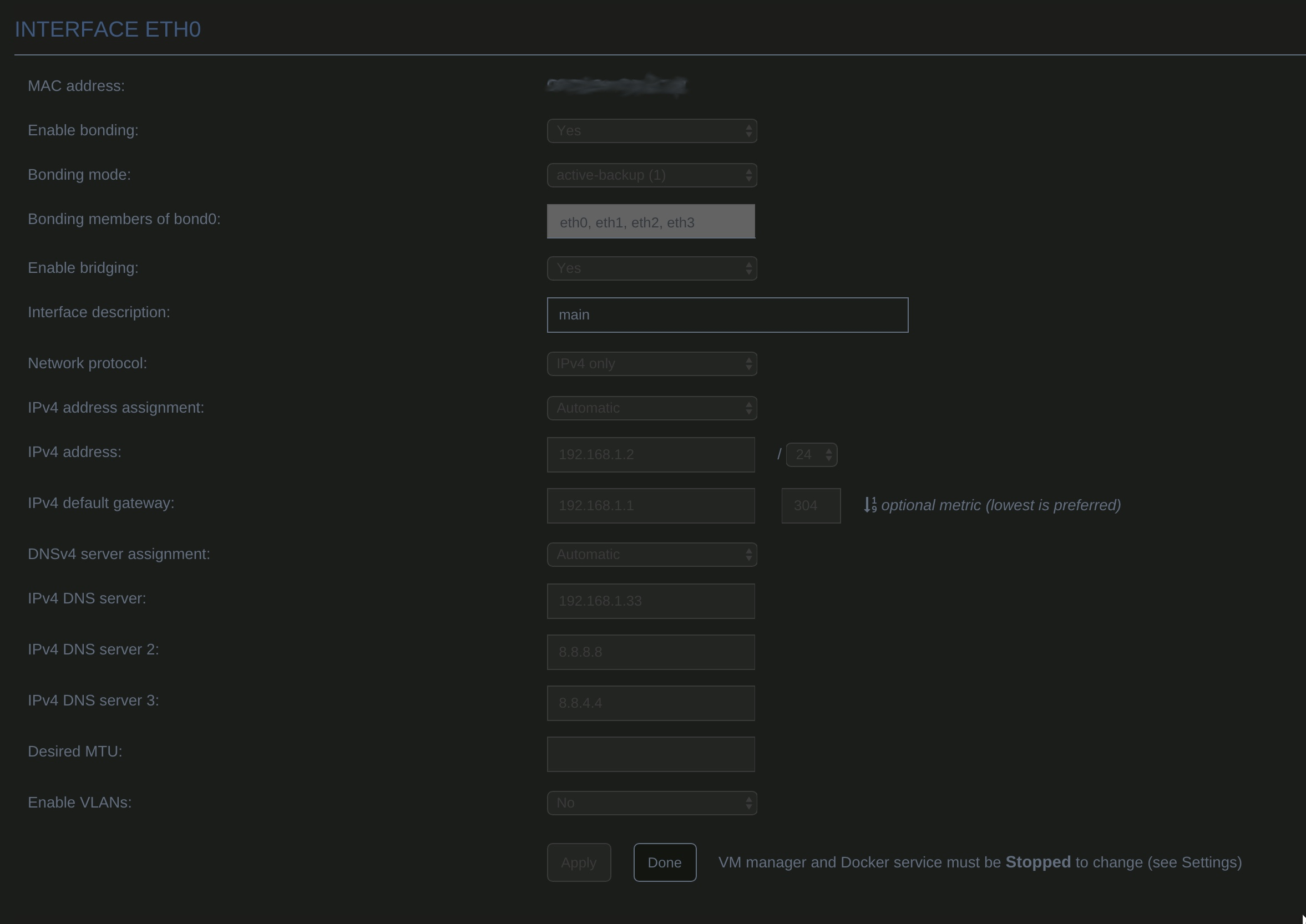

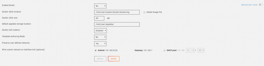

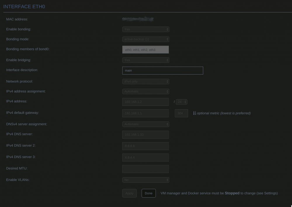

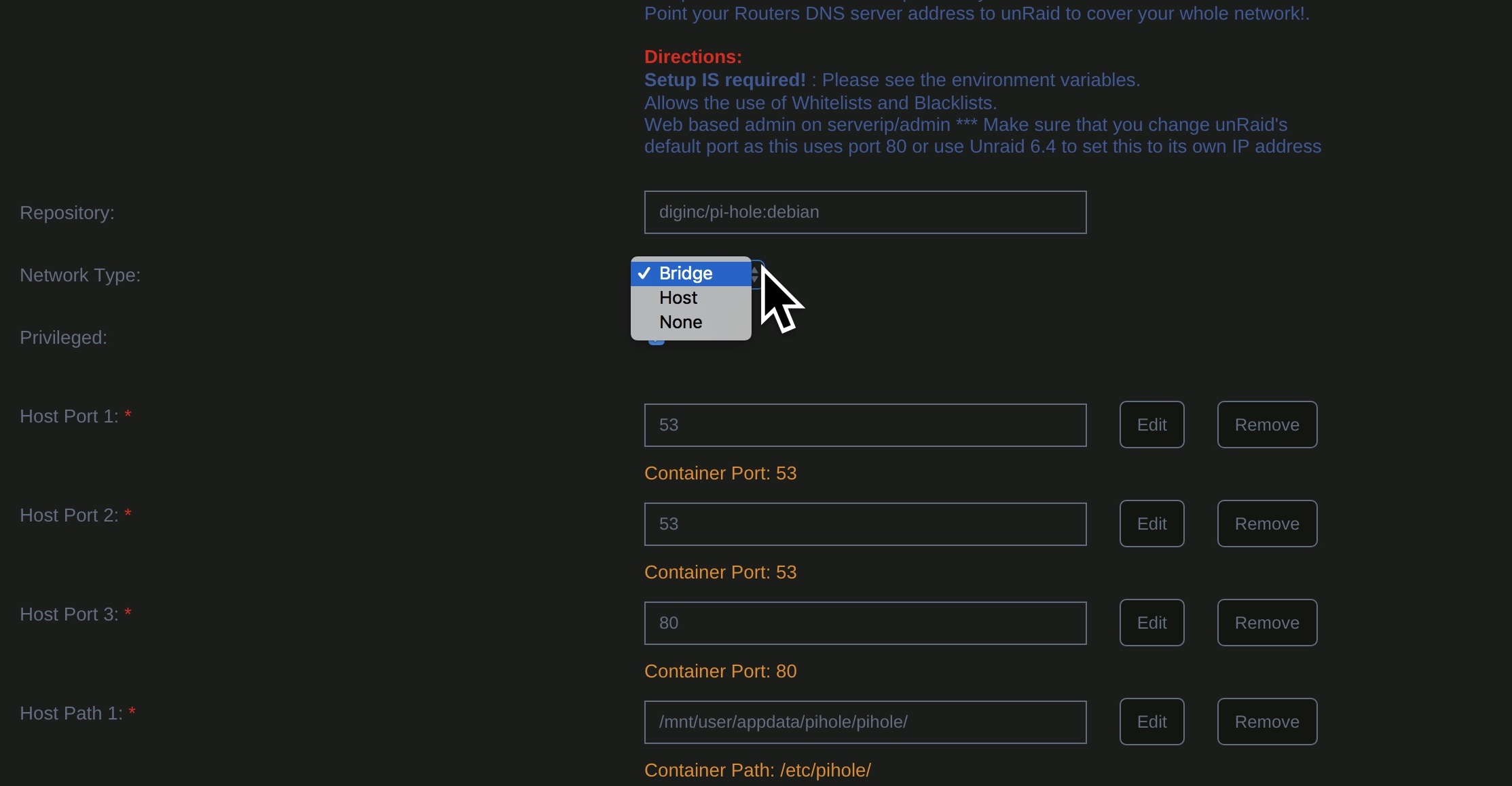

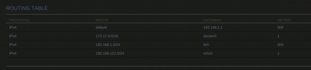

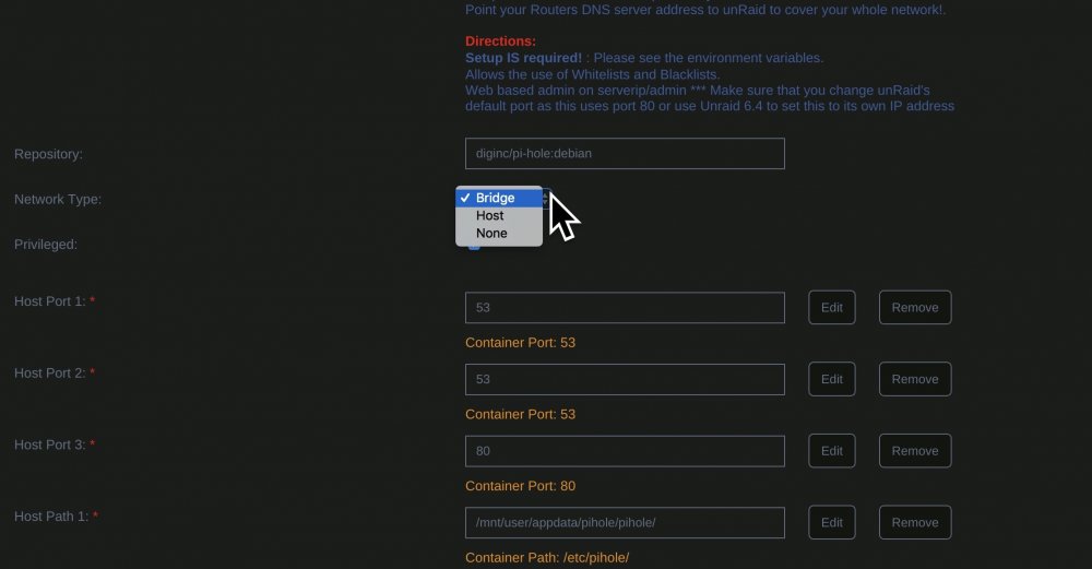

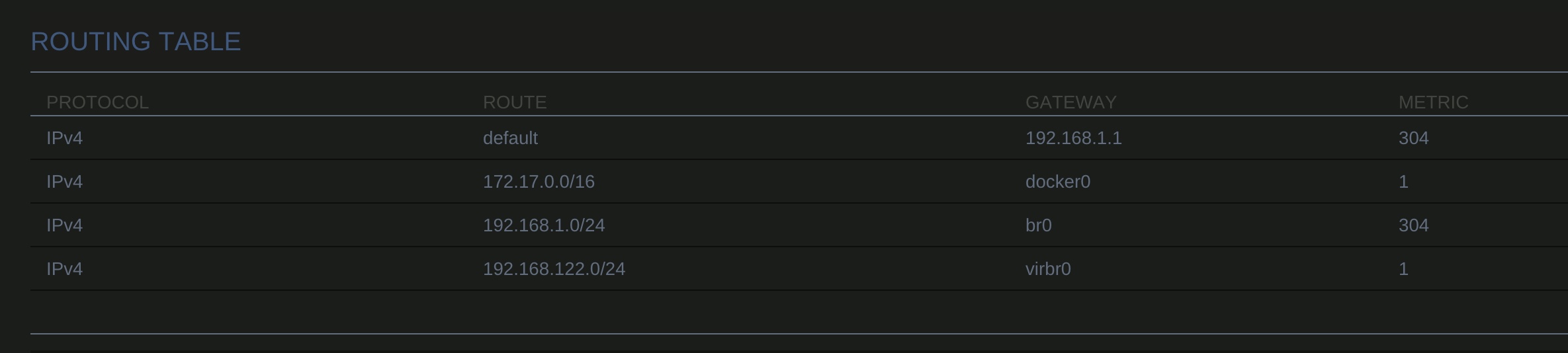

January 23, 20188 yr unRAID 6.4.0 Supermicro - X9DRD-7LN4F with 4 NICs I have a couple of dockers that I had setup and working that I had bridged to their own IP addresses. My NICs were all bonded together in active-backup mode. I messed around with the network setting to setup some of the NICs as separate interfaces. Somewhere in this process the br0 interface was deleted/disappeared. I put everything back to the way it was before (I think), but the br0 is gone from the GUI. Here's a sample from the log file; Jan 23 10:47:25 asok root: pihole: Error response from daemon: network br0 not found Error: failed to start containers: pihole And some screenshots below. Reboot server a few times, started and stopped docker and VM service many times... How do I get br0 back? Edited January 23, 20188 yr by subagon added content

January 23, 20188 yr Author bonienl, One more question... As I said, my motherboard has 4 NICs. I now have eth0 setup to bridge and therefore have the br0 interface. I've turned off bonding (this server is in my home and I don't need redundancy). So I now have the following interfaces showing up on the Network Setting page; br0 br1 eth2 br3 I want to use br0, br1, and br3 for various dockers plus file sharing off of eth0/br0. I'd like to put Plex on eth2 all by itself. The problem is I can only see Bridge, Host, None, and br0 when editing the Plex (or any) docker. I tried the commands you provided above, but without any luck. How can I add br1,eth2, and br3 to the drop down list or manually edit the Plex docker file to use eth2? Thanks Edited January 23, 20188 yr by subagon
January 23, 20188 yr You'll need to have an IP assigned to the interface you want to show up Docker network drop down. This will be fixed in a future release according to @bonienl Or you'll need to have the docker network manually recreated every startup of the docker service. caveat: If you have multiple interfaces with ip addresses in the same subnet (and are physically on the same LAN), some protocols are known to misbehave - I think Samba (Windows File Shares) is one of those. This is because broadcast and discovery sometimes get confused. caveat: The host cannot talk to dockers on the same interface as itself, so if br0 has an IP of 192.168.1.10, br1 has an IP of 192.168.1.11, container A is on br1 with ip of 192.168.1.110. Container A will fail to talk to 192.168.1.11 and vice versa. This is by design. Container A needs to talk to unRAID using 192.168.1.10 and 192.168.1.10 only. However, any protocol that uses discovery and broadcasting will potentially be confused and try to use the wrong IP at times, resulting in flaky behavior. To manual create a docker network and use it with the Plex docker container see this topic: Edited January 23, 20188 yr by ken-ji Corrected the reference post with details for 6.4

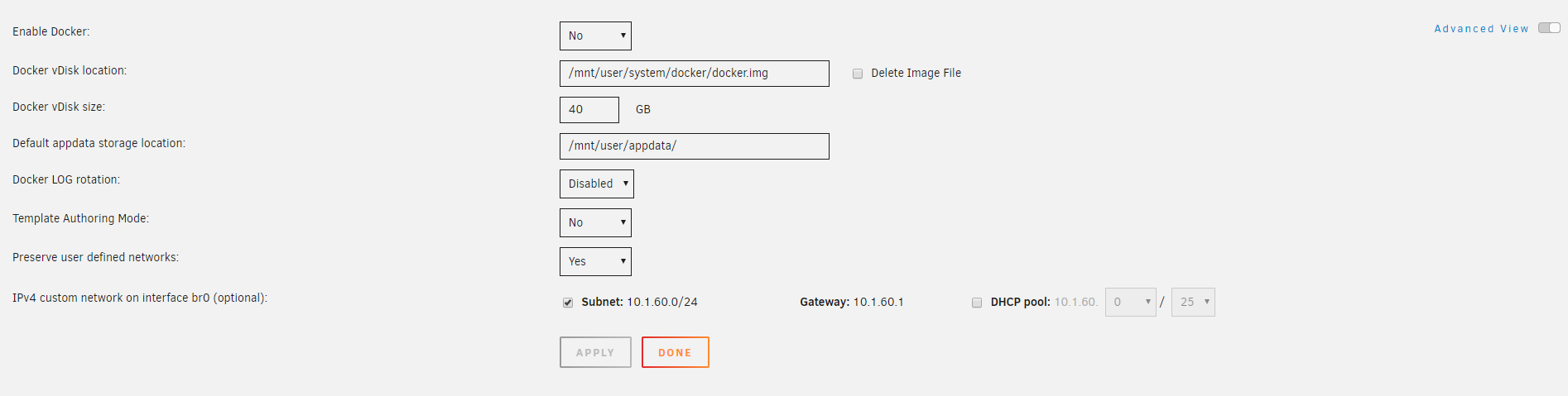

September 19, 20188 yr Post you diagnostics file. I'm guessing there's something wrong in your config that's causing the docker to treat the br0 network as a custom definition and possibly purging it. You might also want to provide the screenshot of your docker network settings 'Settings | Docker'

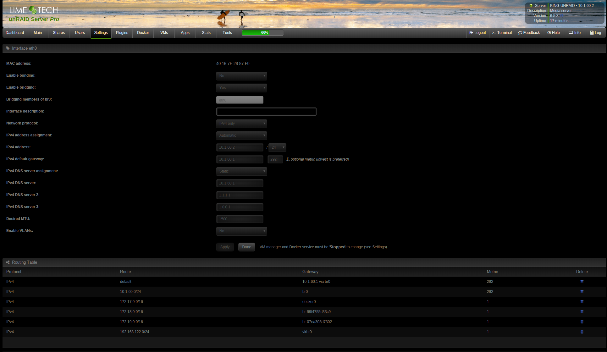

September 19, 20188 yr 11 minutes ago, ken-ji said: Post you diagnostics file. I'm guessing there's something wrong in your config that's causing the docker to treat the br0 network as a custom definition and possibly purging it. You might also want to provide the screenshot of your docker network settings 'Settings | Docker' king-unraid-diagnostics-20180918-1703.zip Edited September 19, 20188 yr by H2O_King89
September 19, 20188 yr I don't see anything wrong. except there are 4 docker custom networks defined. docker0 and three br-* networks. Can you run docker network list on the terminal?
September 19, 20188 yr root@KING-UNRAID:~# docker network list NETWORK ID NAME DRIVER SCOPE 9494a8ea6aac br0 macvlan local 2b4bf512628e bridge bridge local e8e134764a20 host host local 27a6395f1007 none null local 0dd83d63baea proxynet bridge local
September 19, 20188 yr This is weird. Other than the proxynet bridge, did you create any other bridges by cli? because the bridges in your network interfaces (from the diags) named br-* do not line up with those the docker is reporting... only docker networks of type bridge can be seen with the ifconfig -a Maybe @bonienl has some idea...
September 19, 20188 yr 1 minute ago, ken-ji said: This is weird. Other than the proxynet bridge, did you create any other bridges by cli? because the bridges in your network interfaces (from the diags) named br-* do not line up with those the docker is reporting... only docker networks of type bridge can be seen with the ifconfig -a Maybe @bonienl has some idea... just that proxy net and have reboot with no issues for months then reboot a few days ago and started having this issue and found this topic.
