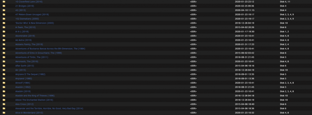

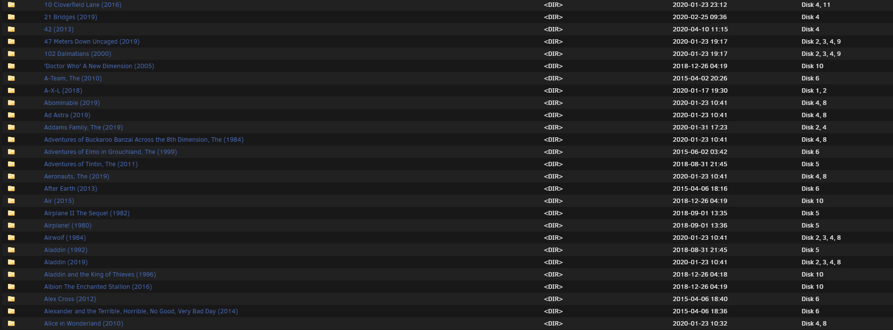

  13. Notice the right side. In the past, I had level split set to auto. Now I have it set to the movie folder level, and the TV season level. That way it fires only a single drive for a movie, or for a TV season. Unbalance GATHER function works very well to gather the files to the same drive, most of the time only taking 1 or 2 seconds since the majority of the problem folders are .txt files or .jpg files, etc. Is there a mechasism, or even a similar utility that can gather a large number of these folders at a time rather than doing them individually? As is, I have to click gather, click the movie folder, click the top listed/largest item, click next, click go. I don't want to multiple that by 2000 movies.
  14. Maybe this has been answered before. I've recently change my split levels for some shares. The function works great to move a single folder, clicking the top drive where the most data is stored. But this will take quite a long time with 2000 movies. Is there a way to automate this function. Example: gather all the files of a directory to the drive with the largest file (typically the video file, mkv, mp4, etc)?
