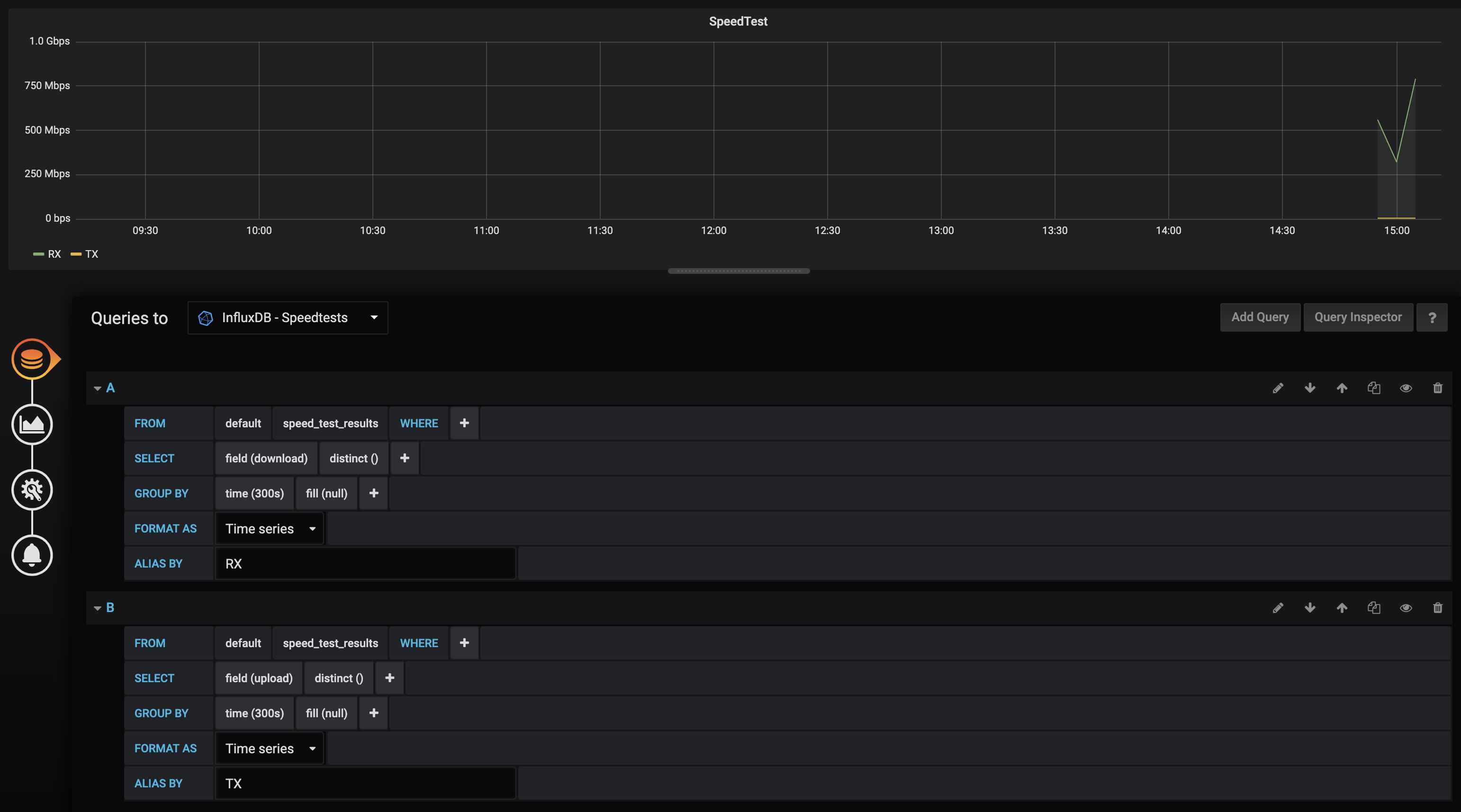

  4. I've tried everything at this point. Bridged/Host/Static network modes and every optional parameter in `speedtest-cli`. I installed it on my desktop machine on the same network, and it works there. It just won't work in this docker container, for whatever reason. It's not a measurement/reporting issue, either: stats from my network switch confirms that the throughput is actually very low upstream. There's a large upstream burst right at the start of the test, then nothing, resulting in a low Mbps reading. I'm not an expert, but it kind of seems like it's waiting for acknowledgement from the Speedtest server before sending more data, and that ACK never arrives. The current results use HTTP. There's a pull request outstanding for a socket-based option. Maybe that'll help whenever it gets integrated back into master.
  5. This is great, thank you. The downstream measurements are now roughly inline with expectations. Still can't figure out why the upstream is locked to 4Mbps, though, but at least the downstream works.

  7. These are fantastic! Thanks! I'm using the Speedtestforinfluxdb and getting some unusual results, though. I have symmetrical gigabit fiber, and show Speedtests in the neighborhood of 800Mbps down, 4Mbps up. I could maybe believe the down (though it's about 940 Mbps when tested manually), but the upstream seems straight wrong (also 940Mbps when tested manually). I'm also seeing pings in the 25ms range ("0" to 2 ms is typical manually). Any thoughts on what might be wrong? I assume I've misconfigured something, but I'm not sure what. [GENERAL] Delay = 300 [INFLUXDB] Address = <my_actual_ip_was_here> Port = 8086 Database = speedtests Username = Password = Verify_SSL = False [SPEEDTEST] # Leave blank to auto pick server Server = [LOGGING] # Valid Options: critical, error, warning, info, debug Level = info

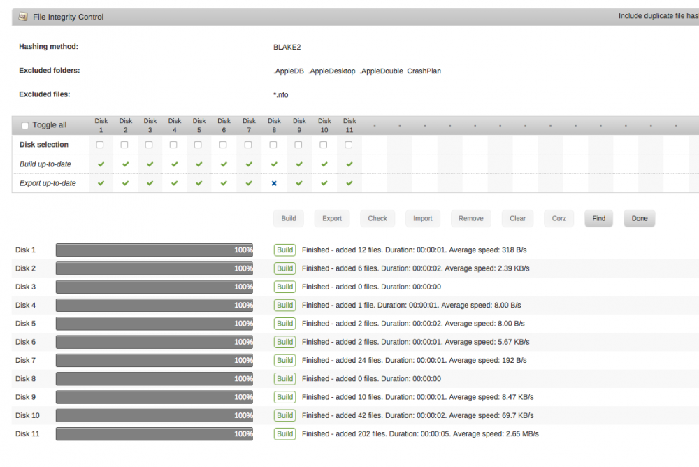

  15. Ok, performed a clear. It found a dozen or so files that needed clearing since yesterday. Ran export on all disks and grepped for ".nfo" and "CrashPlan", which are in my exclusion list. No instances of either found. So I guess the auto-generation is somehow malfunctioning. I disabled that feature, then re-enabled it. We'll see if that does anything. Just checking in. No, disabling and then re-enabling "Automatically protect new and modified files" doesn't work. Same behavior. I tried upgrading to 6.2.1 (which I had planned to do anyway), and tried both tests again. Same behavior. Edit: Ok, I've done a LOT more testing and I'm nearly certain that there's a serious problem with this plugin, at least in my setup. I took the following steps: 1) Run a build on all disks. All show green checks. 2) Export all disks to check for excluded files. All disks still have green checks. 3) Clear all disks. Hundreds of files cleared since last clear operation yesterday. All disks still have green checks. 4) Once the clear operation is complete, almost all disks show they need built (see screenshot). 5) Run build again. Hundreds of new files hashed (see screenshot). Between #1 and this step the array was idle. I can then alternate between building and clearing, back-to-back, with hashes being added and cleared with every operation. It seems like the Build and Clear operations are not using the same exclusion lists.

  17. Ok, performed a clear. It found a dozen or so files that needed clearing since yesterday. Ran export on all disks and grepped for ".nfo" and "CrashPlan", which are in my exclusion list. No instances of either found. So I guess the auto-generation is somehow malfunctioning. I disabled that feature, then re-enabled it. We'll see if that does anything.
  18. Same here. I cleared all disks last night. I then ran Build on all disks to get them "up to date". Today I have several disks that show that they're aren't up to date. I ran clear again, and it cleared more files. Seems like something's broken. How can I help figure out what?
  19. Pretty sure this is also why my excluded files were being ignored and I kept getting warnings as noted in the post above. So the verify operation ignores the exclusions, which are obeyed only during the hash generation step. If I may, it might be worth adding a note about that to the help. I made the changes mentioned and will keep an eye on it this week.

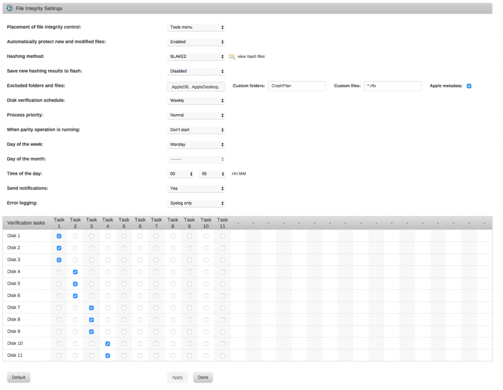

  20. So there's a lot here I still don't understand. I have the plugin setup, I think, to ignore all .nfo files and files in the CrashPlan folder. I have it configured as follows, and have the verification schedule set to run a few drives every week. If I run the Build manually, I can get all the checkmarks green. The next morning, the "Build up to date" status for some drives are orange circles, as shown in this screenshots, even though no verification was run. It's not clear how "Build up to date" could change from green to orange. All the help says is that it's an "Open operation", but no indication what that means. Automatically protect new files is enabled. Then when a verification runs, I always get some warnings about mismatches or corruption in the folders and filetypes I've specifically set as ignored. Any idea what's going on here? This doesn't make sense to me.
  21. Is it expected that the "Build Up to Date" row almost always has a few disks with Os? It says that means there's an open operation, but isn't really clear on what could trigger that. I manually force updates on all disks, then they all turn into the green checkmarks, but by the next morning two or three are Os again. The setting to automatically update the hashes when files are added/modified is enabled. Not sure what I could be doing wrong here.

  24. I'm getting what appear to be a lot of false positives when checking for modified checksums. The files being identified as corrupted are always .nfo files within TV and Movie user shares that are accessed over the network from a Windows machine running Kodi. If I look at the .nfo files, they appear intact and uncorrupted. Kodi reads them fine, and they appear to be accurate, though it's entirely possible they've changed since the last time a verification occurred. I do have automatically protect new and modified files Enabled. They're just metadata I don't really care about that's easy to regenerate, so I could add them to the ignore list, but I'm kind of curious what's going on. Any thoughts?
