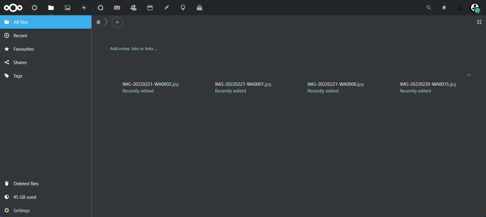

[Support] Linuxserver.io - Nextcloud
Started getting a strange issue with the files tab on the webgui... It wont populate for me at all.... Just updated recently to 23.0.2 which seemed to be fine but now this. Functionally its fine in every other aspect. Photos tab shows all the most recent uploaded photos etc. Anyone else experienced this? Have updates the container just there this evening too and the problem persists. Is this possibly a mariadb issue?
