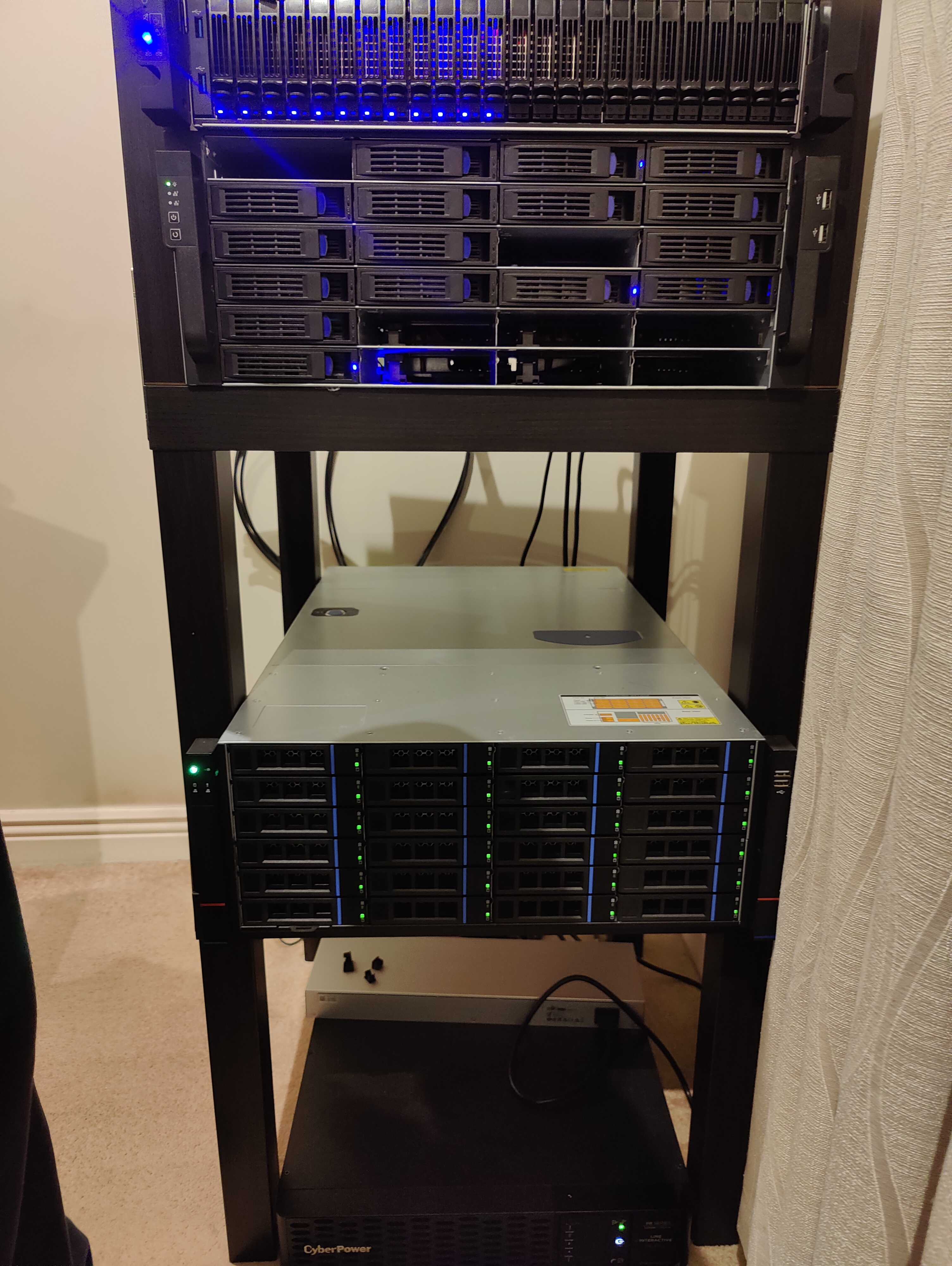

I went with 9300-16i in order to get the full bandwidth of the backplane. Like a fool I missed the fact that the H12SSL-i has no on board HBA and waisted time getting slimsas to microsas cables. I've had a lot of headaches with my setup. I have 2 9201-16e to connect to my JBOD... 1 of which now appears to be broken... Which is a pain but 1 still allows me to have 16 of the 24 bays populated. I also got some dodgy 8088 to 8088 wires which was another pain. At present I am about to fully deploy my server with 2 24bay 4u chassis. 1 of which is fully populated with array drives for ~170TB of storage. I've added 8x1 TB nvme drives to function as 4 separate cache pools. and I have 12 1TB SSD's in the Jbod at present which will be deployed in 2 raidz1 pools. I'm thinking I might wait for Unraid 6.12.0 to deploy these properly. Then I'll add 6 more array data drives as required and finally add an extra vdev of SSD's as required. My cpu will likely be upgraded at some point. In testing I think the lower clock speeds of the EPYC 7402 along with the 2666Mhz RAM are making the system feel slower in some tasks than the 3900x it replaced. But the benefits of the system far out weigh this minor issue. But I can see myself going for the 7443 as you both have to get the 4Ghz boost. I may look into a RAM upgrade if this doesnt have the desired results. But this is all long term thoughts. For now my server is perfect for my needs. Next on my list will be to look to get my shed setup to accommodate the server. Insulation and wiring still need to be done so that will be the next project.
