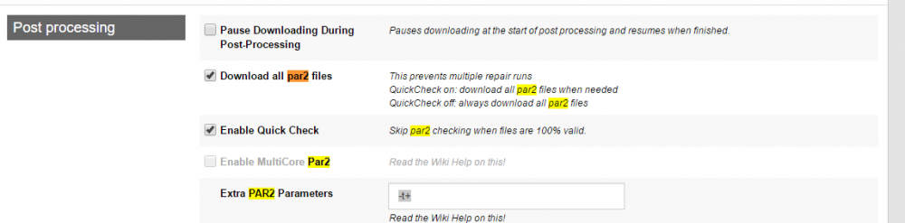

  10. I did my tests on a completely different docker host with no previous install of SABnzBD... Everythings fine until i tick "Download all par2 files" and restart. Then i lose the greyed out multicore tick. Even when i untick "Download all par2 files" and restart the greyed out multicore tick dosn't return, have a sneaking suspicion that making ammendments to any of the related PAR options would do the same...
  11. @SparklyBalls Just did the exact same test as yourself following your vid letter for letter... got the same result as you. However, when i turn on "download all par2 files" under 'settings -> switches' I experience the issue i reported, i lose the greyed out tick. Can you see if it's the same your end? EDIT: Strangely when i remove the tick from "Download all par2 files" the tick under "Enable Multicore PAR2" dosn't come back either!
  12. Sorry I mean the parameter in my screenshot. I have par2 and ionice parameters set in sabnzbd but sabnzbd complains of problems with my par2 parameters (which should be valid if it is indeed using multicore as these parameters force multicore) I was under the impression that if sab found a compatible multicore par2 executable it would have put a tick in the greyed out box for multicore as well? If anyone is running the latest pull of this container can they see how there's shows up under settings -> switches?
  13. That's great do you know if the version of par2 you guys have used in this container can use the switch in my pic? Sent from my Nexus 5 using Tapatalk
  14. Hi guys, Love your containers, and see that you've mentioned previously in the thread that PAR2 Multicore should be enabled as part of this container however when i browse the default skin and check my PAR2 settings there is NO tick in the greyed out enable multicore par2... Is this to be expected? And if it is enabled and this is related to PAR2 not being recognized as there are there any default PAR2 parameter settings that are being used straight out the box? i'm getting PAR2 switch error using the following:
