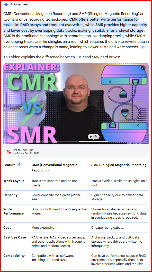

From Google's AI: You never want to assume that a HD is CMR unless it is specifically stated that it is. If any doubt exists, go to the manufacturer's website and look up the spec's for the drive model and capacity. You need to check both because there were instances where one capacity was CMR and another capacity was SMR!!! (And beware of purchasing 'shucked' drives as you never know what is inside until you get it open. Manufacturers seem to use external drive enclosures to move excess inventory!!!)

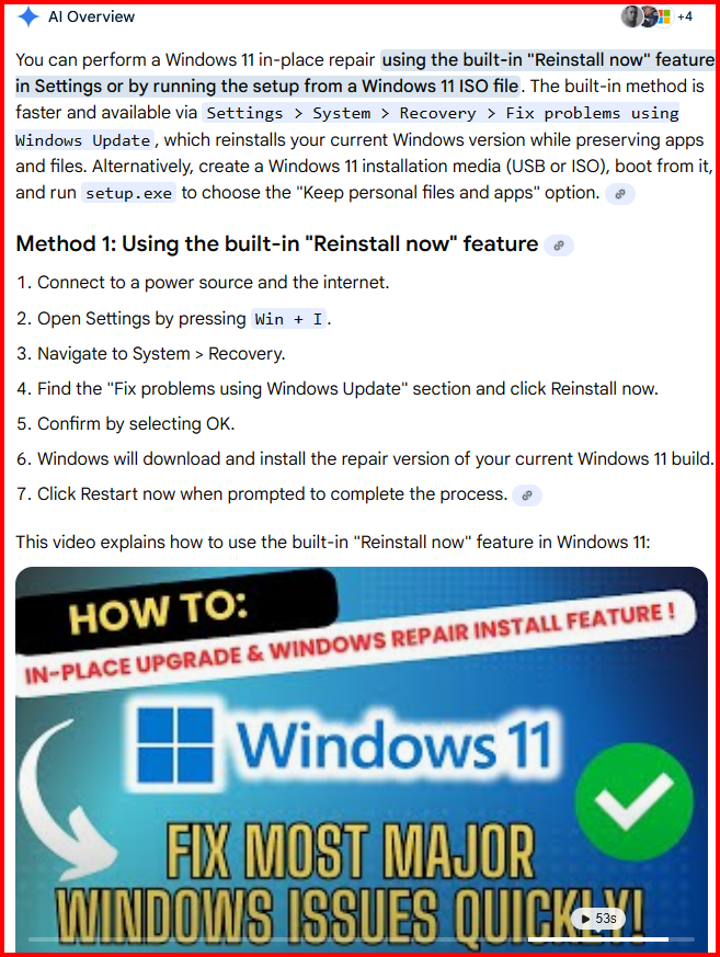

I would suspect that a Reinstall or repair is necessary. I would start by googling windows 11 repair in place. IF that works, you will not have to setup Windows the way your want it and reinstall all your programs. See below for Google's AI overview:

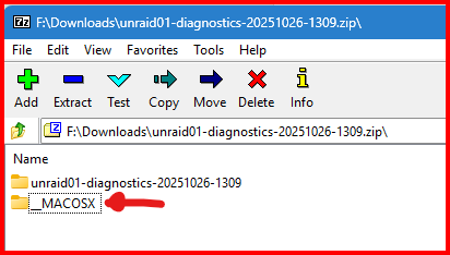

@ilium007 , there is a section of the Forum where MAC issues are discussed: https://forums.unraid.net/forum/103-macossmb/

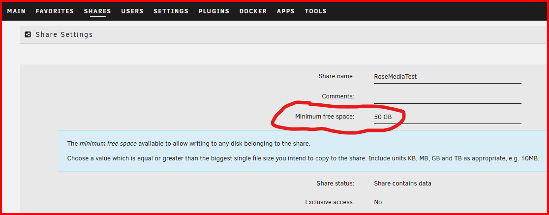

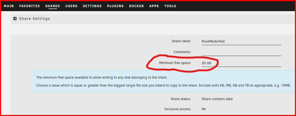

You mention that you have issues with this one file. Is this the only file or you are simply using it to maintain identical conditions: I had a look at your share settings and I would suggest that you make a change to one of them. It is shown below---SHARES >>> share-name My setting is for 50GB as that would be the largest file I would anticipate ever writing to this share.
