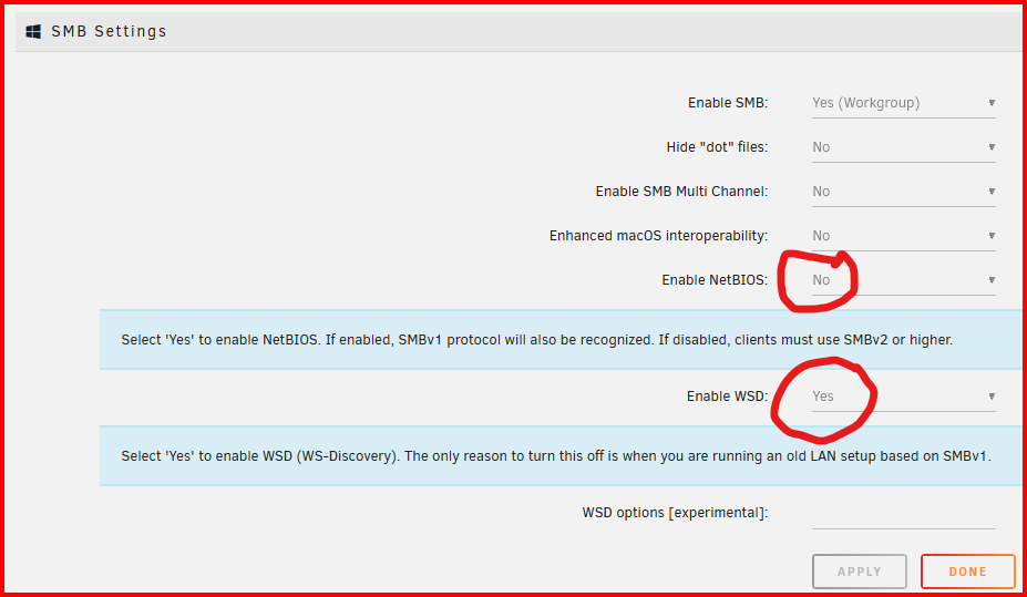

OK... Let's try this. SETTINGS >>> SMB then EDIT: You should not be using SMBv1 unless your hardware has not had a firmware/software update since about 2010!

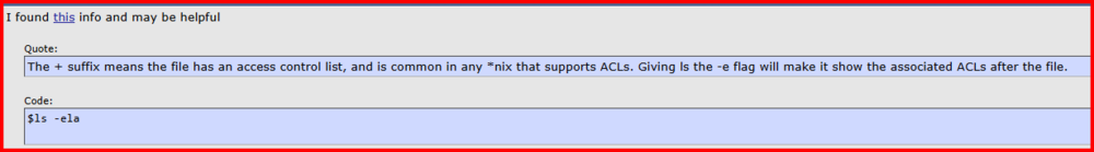

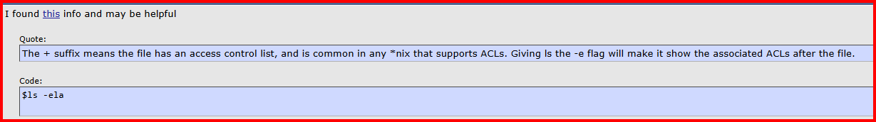

Make sure that you notice this switch for the ls command: It might show more of what is happening... EDIT: Should have check first before posting. The '-e' switch is not implemented in Unraid's Linux disto!

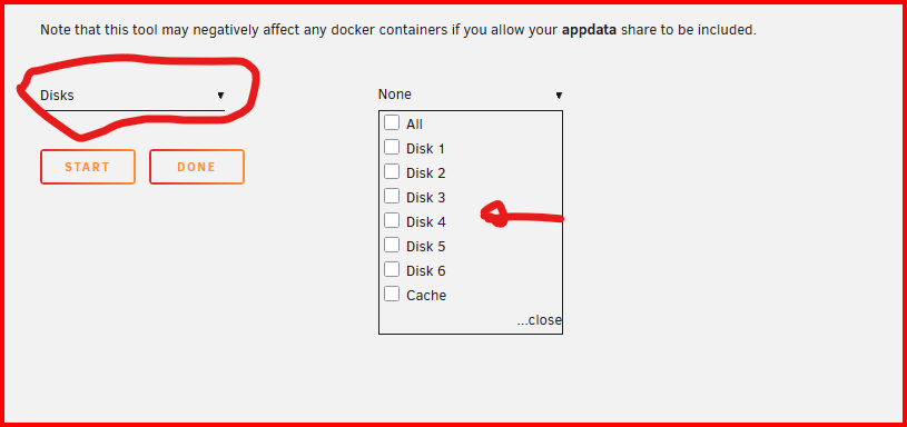

Have a look here: https://www.linuxquestions.org/questions/linux-newbie-8/what-is-in-drwxrwxrwx-915243/ and https://en.wikipedia.org/wiki/Access-control_list and https://forums.unraid.net/topic/116389-access-denied-printer-unraid-share/?tab=comments#comment-1059803 The real problem is often figuring out what set up these additional controls in the first place. (With User Shares, the New Permissions tool will usually fix the problem. I am not sure if it will for Disk Shares...)
