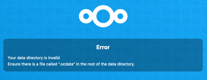

  12. Nextcloud and reverse proxy is set up with SIO`s videos help. Without duckdns.org due to static wan ip. ThenI am getting this error message when connecting thru WebUI and from outside: Any ideas how to fix is much appreciated. Netcloud docker log; GID/UID ------------------------------------- User uid: 99 User gid: 100 ------------------------------------- [cont-init.d] 10-adduser: exited 0. [cont-init.d] 20-config: executing... [cont-init.d] 20-config: exited 0. [cont-init.d] 30-keygen: executing... using keys found in /config/keys [cont-init.d] 30-keygen: exited 0. [cont-init.d] 40-config: executing... [cont-init.d] 40-config: exited 0. [cont-init.d] 50-install: executing... [cont-init.d] 50-install: exited 0. [cont-init.d] 60-memcache: executing... [cont-init.d] 60-memcache: exited 0. [cont-init.d] 99-custom-files: executing... [custom-init] no custom files found exiting... [cont-init.d] 99-custom-files: exited 0. [cont-init.d] done. [services.d] starting services [services.d] done. Your data directory is invalid Ensure there is a file called ".ocdata" in the root of the data directory. Letsencrypt logfile; GID/UID ------------------------------------- User uid: 99 User gid: 100 ------------------------------------- [cont-init.d] 10-adduser: exited 0. [cont-init.d] 20-config: executing... [cont-init.d] 20-config: exited 0. [cont-init.d] 30-keygen: executing... using keys found in /config/keys [cont-init.d] 30-keygen: exited 0. [cont-init.d] 50-config: executing... Variables set: PUID=99 PGID=100 TZ=Europe/Berlin URL=norvegr.works SUBDOMAINS=server,nextcloud EXTRA_DOMAINS= ONLY_SUBDOMAINS=true DHLEVEL=2048 VALIDATION=http DNSPLUGIN= [email protected] STAGING= 2048 bit DH parameters present SUBDOMAINS entered, processing SUBDOMAINS entered, processing Only subdomains, no URL in cert Sub-domains processed are: -d server.norvegr.works -d nextcloud.norvegr.works E-mail address entered: [email protected] http validation is selected Certificate exists; parameters unchanged; starting nginx Starting 2019/12/30, GeoIP2 databases require personal license key to download. Please manually download/update the GeoIP2 db and save as /config/geoip2db/GeoLite2-City.mmdb [cont-init.d] 50-config: exited 0. [cont-init.d] 60-renew: executing... The cert does not expire within the next day. Letting the cron script handle the renewal attempts overnight (2:08am). [cont-init.d] 60-renew: exited 0. [cont-init.d] 99-custom-files: executing... [custom-init] no custom files found exiting... [cont-init.d] 99-custom-files: exited 0. [cont-init.d] done. [services.d] starting services [services.d] done. nginx: [alert] detected a LuaJIT version which is not OpenResty's; many optimizations will be disabled and performance will be compromised (see https://github.com/openresty/luajit2 for OpenResty's LuaJIT or, even better, consider using the OpenResty releases from https://openresty.org/en/download.html) Server ready maxx-diagnostics-20200324-1919.zip
