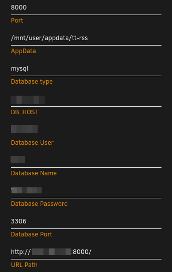

  18. Screens attached below. I tried without putting the port in the URL path and it gave an error message on the website to add the port. So *something* is working... I created the db and db user and granted the user full priv to the db. However, the db is empty; there are no tables created.

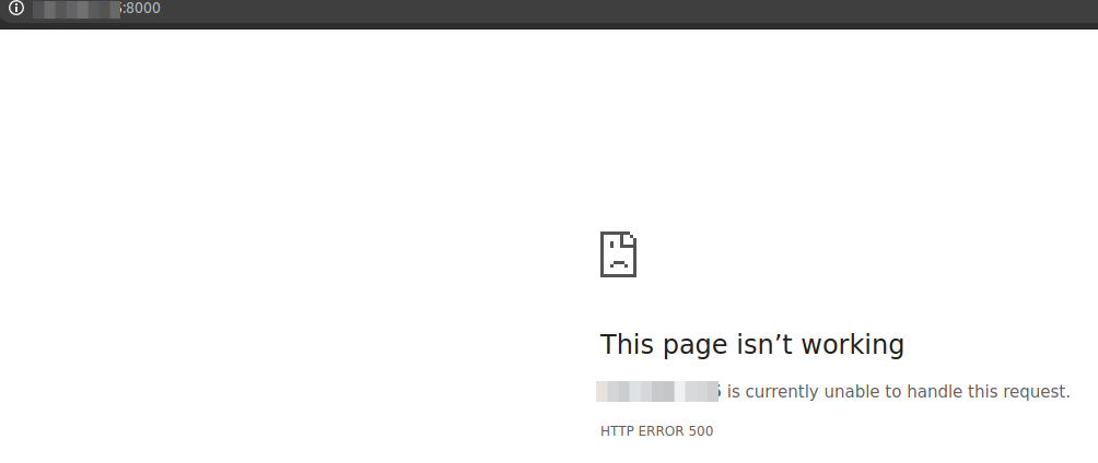

  19. Hi, just installed the lunik1/docker-tt-rss container. Configured a db and user in advance, put it into the docker config. No errors in log when starting. But going to http://serverIP:8000 gives nothing... blank page. Any ideas? Thanks!
