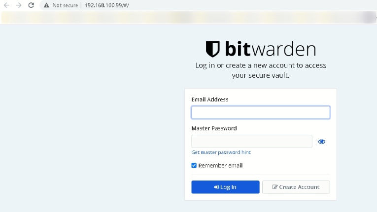

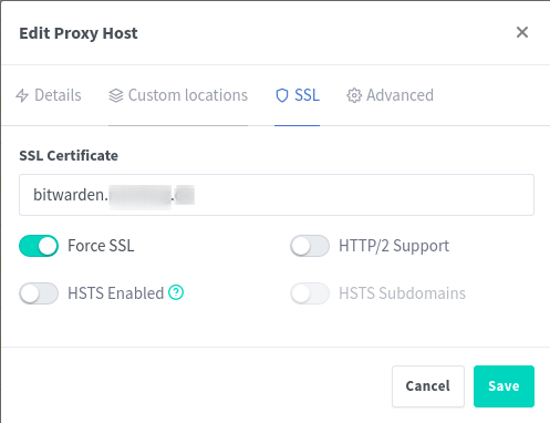

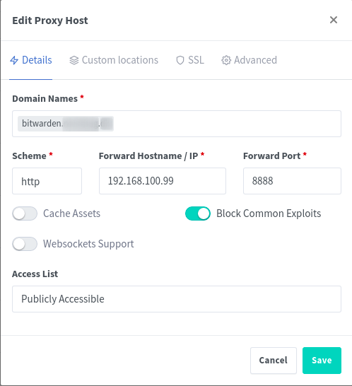

I assume you wnat me to bash into it first? the nc command just goes to the next line, like I've pressed ENTER: The curl command gives me this: I can reach the page locally: It just doens't work because of the HTTPS thing, but it worked with NPM before, but out of a sudden, it stopped working. And now, I can't even reach the page. This is the configuration in NPM: "Custom location" and "Advnaced" has nothing in it.

Hello, I'm getting a "502 Bad Gateway" error. used docker exec -it NginxProxyManager bash And pinged the container I'm trying to reach, with this result: 64 bytes from 192.168.100.99: seq=0 ttl=64 time=0.103 ms 64 bytes from 192.168.100.99: seq=1 ttl=64 time=0.117 ms 64 bytes from 192.168.100.99: seq=2 ttl=64 time=0.098 ms 64 bytes from 192.168.100.99: seq=3 ttl=64 time=0.099 ms 64 bytes from 192.168.100.99: seq=4 ttl=64 time=0.070 ms 64 bytes from 192.168.100.99: seq=5 ttl=64 time=0.080 ms 64 bytes from 192.168.100.99: seq=6 ttl=64 time=0.097 ms 64 bytes from 192.168.100.99: seq=7 ttl=64 time=0.060 ms 64 bytes from 192.168.100.99: seq=8 ttl=64 time=0.098 ms 64 bytes from 192.168.100.99: seq=9 ttl=64 time=0.096 ms I've also done this: nc 192.168.100.99 8888 GET / And got this result: BusyBox v1.31.1 () multi-call binary. Usage: nc [OPTIONS] HOST PORT - connect nc [OPTIONS] -l -p PORT [HOST] [PORT] - listen -e PROG Run PROG after connect (must be last) -l Listen mode, for inbound connects -lk With -e, provides persistent server -p PORT Local port -s ADDR Local address -w SEC Timeout for connects and final net reads -i SEC Delay interval for lines sent -n Don't do DNS resolution -u UDP mode -v Verbose -o FILE Hex dump traffic -z Zero-I/O mode (scanning) From what I'm reading, I can connect to it. It works on LAN, just not on the subdomain. Any ideas on how to fix this?
