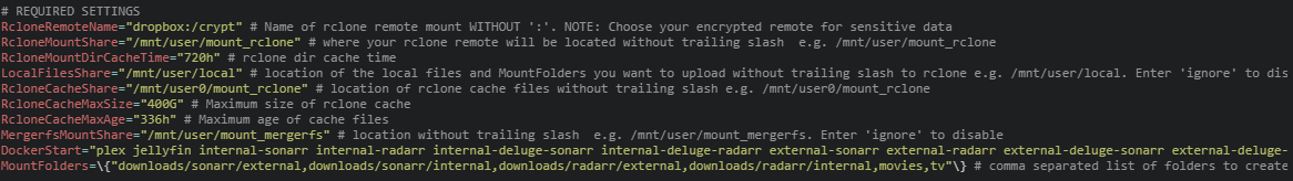

  21. The dropbox:/crypt part works, I can use the rclone commands in the terminal with it, so I'm happy with it. I'm not sure it's done the right/best way, but it works, and it took me a while to get it to work, so I don't want to mess with it Regarding the /user path, why not just point it to /user/mount_mergerfs/crypt/movies instead of pointing it to /mnt/user? It kinda makes sense so it sees it as one disk instead. If someone knows a deeper explanation, I'd love to hear it and learn from it Regarding the docker start, there's no commas in between. There dash ( - ) though, which is a part of the container/docker name that I use.

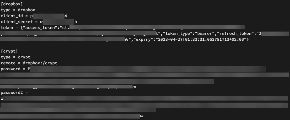

  22. Hello, I'm kinda stuck on this, and I read through the guide multiple times, but it seems like something is implicit that I don't get. For the rclone config, this is my setup (details are blurred): The terminal rclone commands works just fine. I'm not sure if this is done right: (I know there's a lot of containers and paths) and I read this sentence "To get the best performance out of mergerfs, map dockers to /user --> /mnt/user" I'm not sure what this means. Should I add a new path to Plex for with "/mnt/user/ and the same for Sonarr, Radarr and the Deluge containers, or what am I supposed to do? Also, why? I don't quite get it. I know how to setup the cronjob, but I want to make sure I get it right before I use it. Maybe someone could walk me through it?
