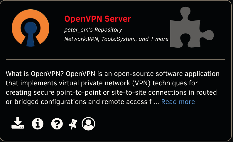

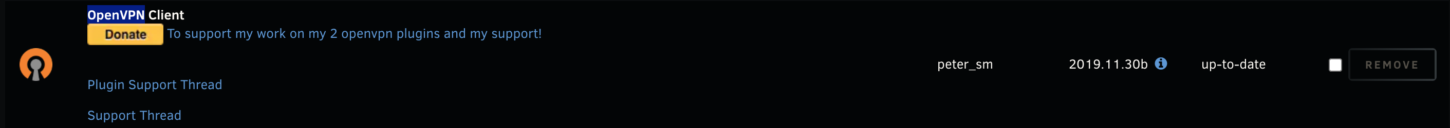

  6. @peter_sm Sorry for the dumb question but how do I uninstall it? I installed it via Community Apps. It shows from the install logs that it is installing as a plugin. I see it listed under Settings as "OpenVPN Server TUN mode" When I look under the Installed Plugins page, I don't see it. I only see the OpenVPN Client that I installed a while ago by the same author.
