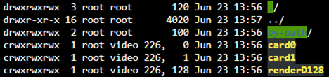

I ran this command as recommended in a guide and before are the results -v -s $(lspci | grep VGA | cut -d" " -f 1)lspci 04:00.0 VGA compatible controller: ASPEED Technology, Inc. ASPEED Graphics Family (rev 30) (prog-if 00 [VGA controller]) DeviceName: Onboard VGA Subsystem: Super Micro Computer Inc ASPEED Graphics Family Flags: bus master, medium devsel, latency 0, IRQ 11, IOMMU group 10 Memory at f6000000 (32-bit, non-prefetchable) Memory at f7000000 (32-bit, non-prefetchable) I/O ports at d000 Expansion ROM at 000c0000 [virtual] [disabled] Capabilities: [40] Power Management version 3 Capabilities: [50] MSI: Enable- Count=1/4 Maskable- 64bit+ Kernel modules: ast supposedly i should be seeing the Intel igu populating here, specifically "i915" as the KENNEL MODULE Sent from my Pixel 5 using Tapatalk- i915 w/ Plex causes Errror s1003 and will not play any video w/ h/w transcode enabled

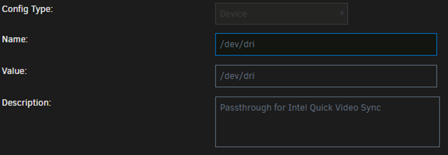

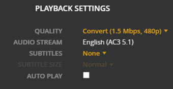

I changed the parameters to: --device=/dev/dri , and I'm even more confused after some more testing. Video files will now play with the transcode enabled in Plex, but it doesn't seem to actually transcode at all. Below is my playback settings along with the dashboard showing the corresponding stream:- i915 w/ Plex causes Errror s1003 and will not play any video w/ h/w transcode enabled
I'm trying to enable hardware transcoding in Plex. Initially I had a hard time getting the i915 module to be detected by unRaid. Only the mobo ASMEDIA ast VGA module was detected. After trial and error I found that I was changing the wrong setting in the BIOS. I changed that and now the system sees the igpu. My Hardware: supermicro MBD-X10SLH-F-O xeon e3-1246 v3 haswell unRaid upgraded to v6.10.3 during testing things i've tried: via BIOS, switched "VGA PRIORITY" to OFFBOARD since reverted back to ONBOARD installed INTEL_GPU_TOP plugin I haven't tried blacklisting i915 as suggested in the plugin's support forum, since that seems to be in response to newer hybrid CPUs like Alderlake+. I might be mistaken though so let me know please if that applies to my Haswell Xeon also. modprobe i915 command manually created /boot/config/modprobe.d/i915.conf file added device to Plex container added extra parameters: --device=/dev/dri:/dev/dri Ran : chmod -R 777 /dev/dri -results after running CHMOD Please let me know if any logs or commands would be helpful and I will post those ASAP. I have just exported fresh diagnostics.zip and attached. It's probably something simple that I'm overlooking. I haven't messed with hardware configuration on my system in any great depth, or at all for a while really, so I'm quite lost as to what to try next. Most of the results I get searching are geared towards discreet cards or issues utilizing i915 with newer CPUs. mootower-diagnostics-20220623-1915.zip- Ultimate UNRAID Dashboard (UUD)
