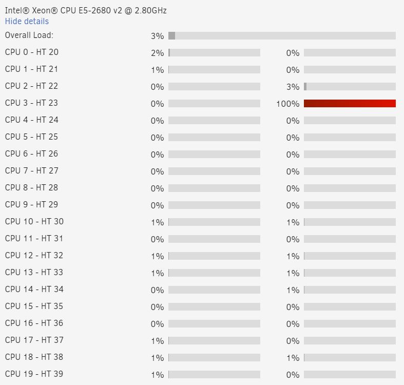

I cannot agree with you. I have similar experience as jpporter. I have Ryzen 3700X thats not slow CPU, 2x1TB Samsung 980 PRO NVMe as chace drives and 3x12TB WD Gold HDDs one of them parity drive. Every time when parity check starts one thread is pegged to 100% and all my work must stop, shares are usually not accesible during that time and services like Plex or HOOBS are not working or at very limited speed/laggy. That includes shares which are only in cache drives(game libraries), because CPU is struggling with that kind of load. It would be awesome if this proces would be multitreaded, not because speeding up, i dont care how long it takes, but because I could access data. It's maybe issue just for Ryzen CPUs caused by architecture and one 100% pegged thread can cause this trouble. But I'm really unsatisfied by performance during parity check.

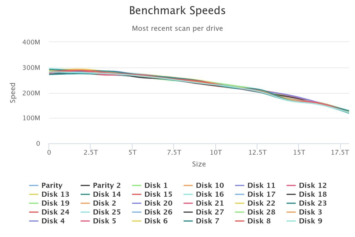

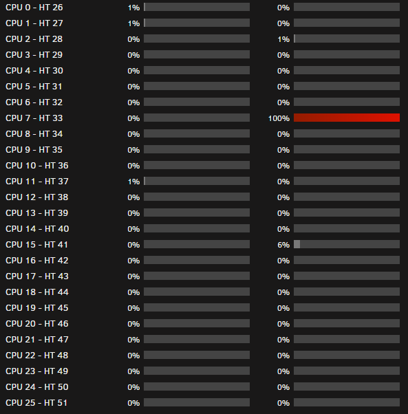

Just found this thread because i am running into the same issue. I was wondering why i was only getting 89MBs and the type 260MBs of my drives (mg09aca18te) i do have 30 of them in a pool with 2 parity. One core of my Gold 6230R CPU is pegged at 100% for 3 to 4 days to do a parity check. I have almost no iowait on avg. Since it is limited to a single core i only get a total read speed of the array of 2.6 GB/s when it should be close to 7.6 GB/s. All hdds run though 3x LSI 9305 and have dedicated pci lanes so the throughput should not be a issue. Am i missing something or this just something i am going to have to live with?
Edit: so after trying to get as much single thread performance as possible I found out that turbo is not enabled by default on my motherboard. Now with all that squared away i got up 110MBs per drive and 3.2 GB/s array.

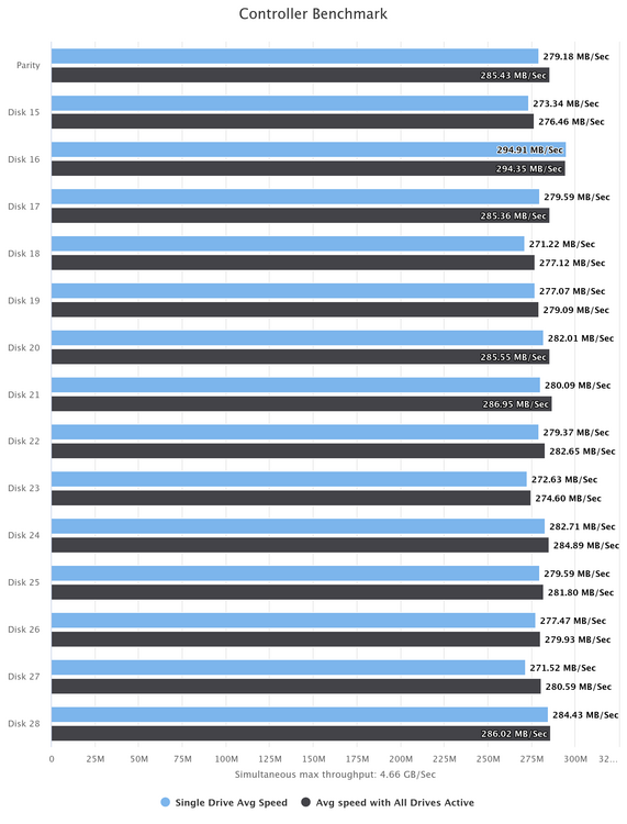

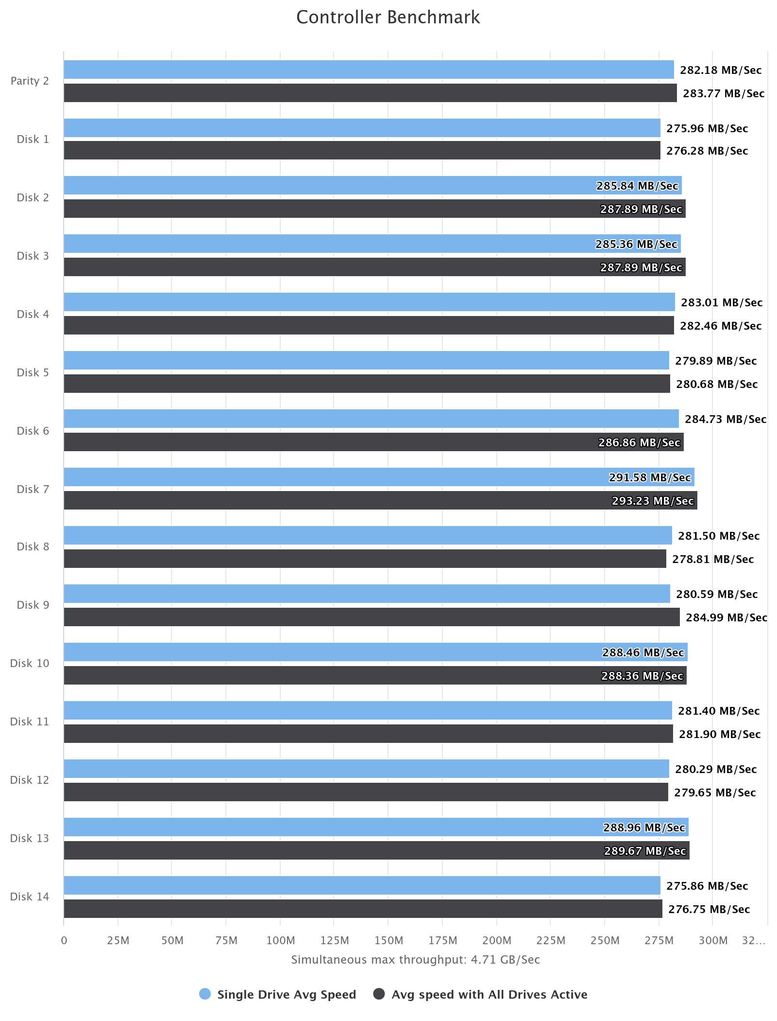

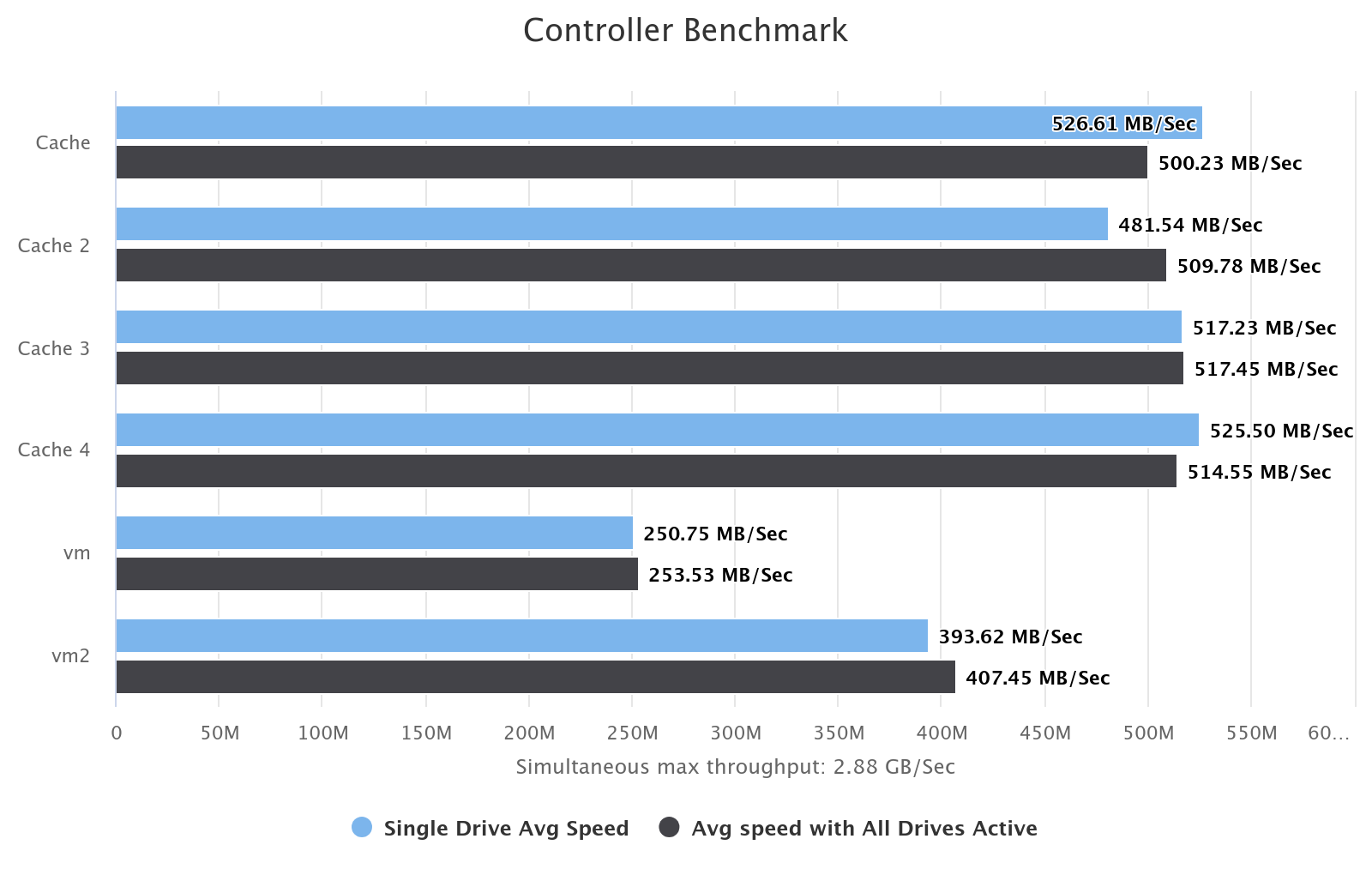

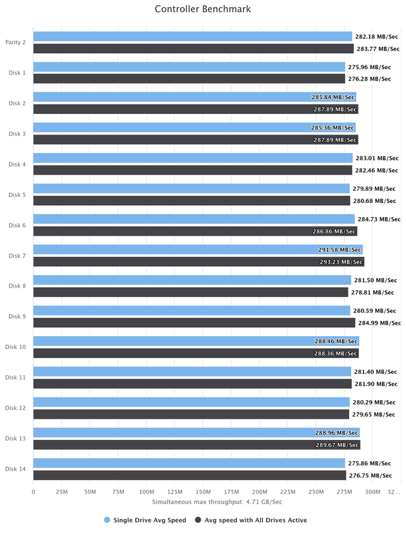

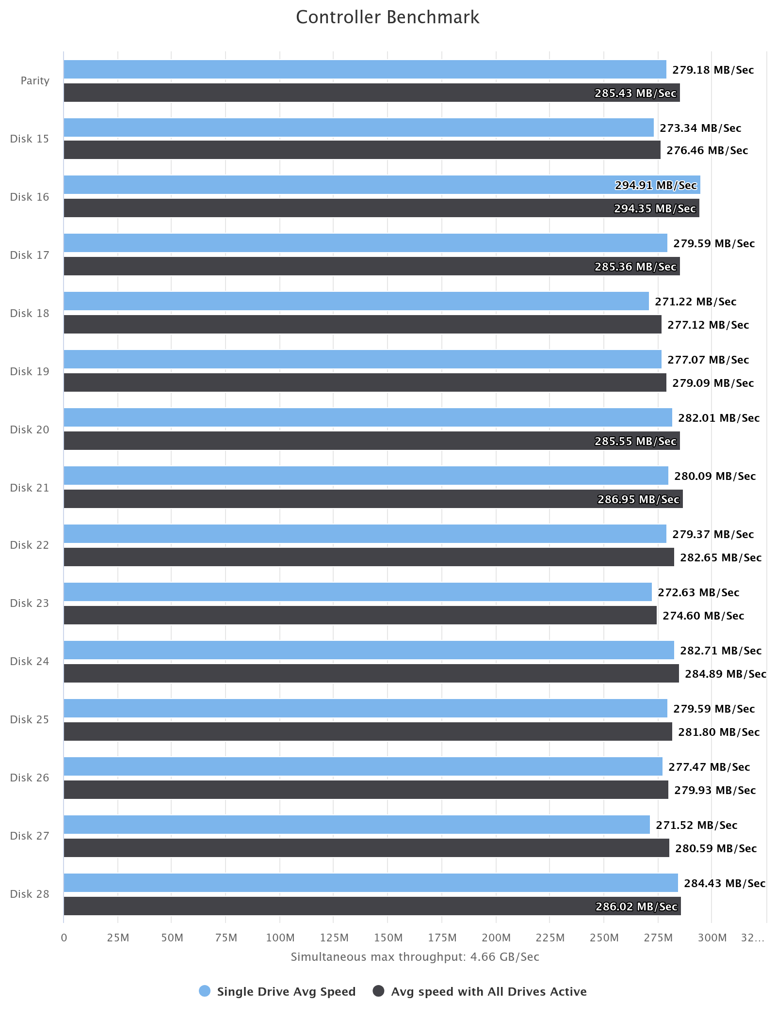

Thank you for the update! I did benchmark everything like you asked. I don't see anything out of the ordinary. All ssds are on their own controller.
Each controller need 4.7GBs so brings the total to 9.4GBs for a parity check?
Edited by utilitybee
Everything looks good there, you are certain that there wasn't anything else accessing the array during the check right?

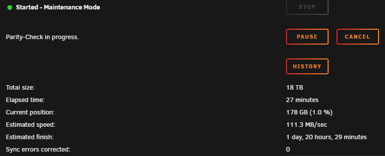

I was pretty sure there was nothing but i wanted to make sure. So i put it in Maintenance Mode and got the exact same result. 😢
image.thumb.png.4ea59213f1b2f17392ac875d28689148.pngimage.png.1cc4471bfd944d7ee172214b6e803d66.png
I don't see anything wrong, do a quick CPU test to see if the CPU is performing normally:

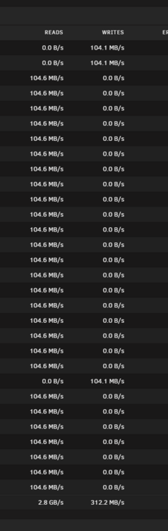

Something i thought was interesting is that my array is always capped at this speed. I moved a single large file from the cache to the array with roughly the same speeds.
