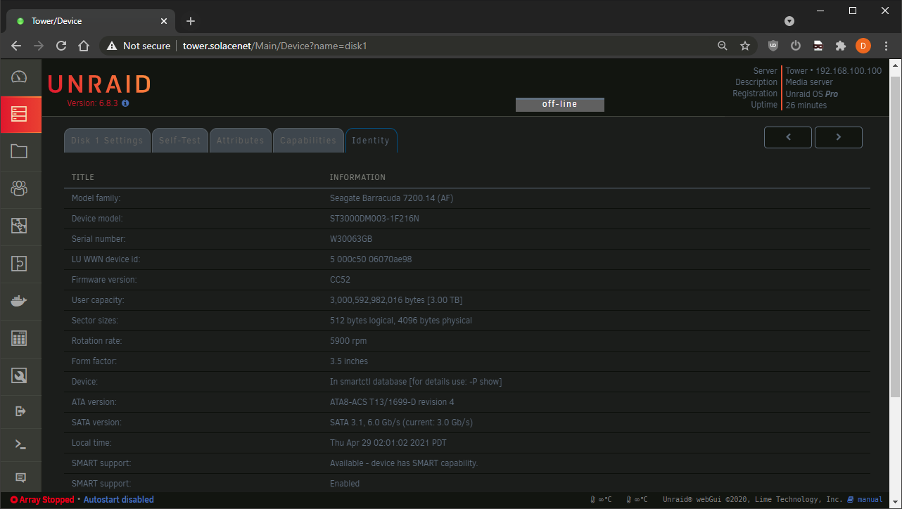

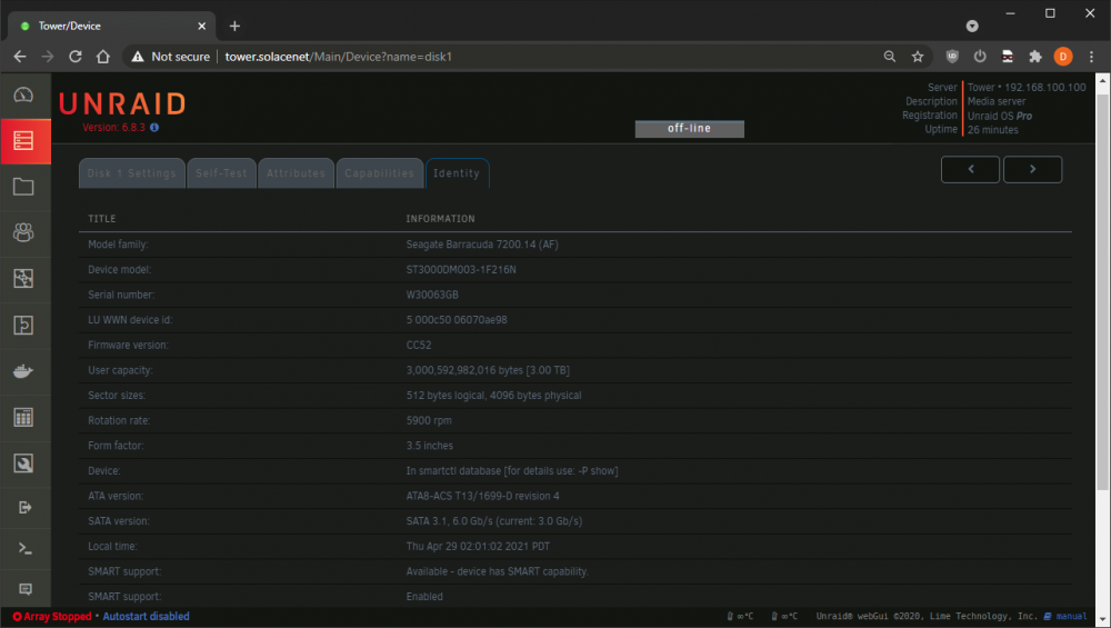

Important to consider -- if you don't have SMART data coming back from your drives, you don't know if they're failing. If they're failing and you're running long-stretch operations like parity sync checks over and over, you're thrashing a failing drive, which might make it fail faster, and destroy your data.
Maybe throttle back for a moment, and let's do some forensics. First, do you see valid SMART data for your disks? I have a few non-default UI options, but go to the Main tab, click on a disk's label (ie Disk 1 ) and locate the Attributes and Identity information.
If that sort of information is missing, you're going to need to set up SMART settings that are arcane and difficult and the source of much frustration, OR connect your devices to a good quality USB adapter (or directly to another PC, etc) and examine their SMART data with a valid tool.
Windows- CrystalDiskInfo is free. https://crystalmark.info/en/software/crystaldiskinfo/
Linux - smartctl from the terminal, or just ssh to your unRAID box, since it has all the same tools.
If the data is there, check for phrases like Pending Sector, Uncorrectable, Bad Block -- look for FAILING_NOW or IN_THE_PAST anywhere on the left, as some error triggers can be persistently flagged. Ignore HUGE numbers like "Raw Read Error Rate" -- it's actually a set of values encoded into one number.

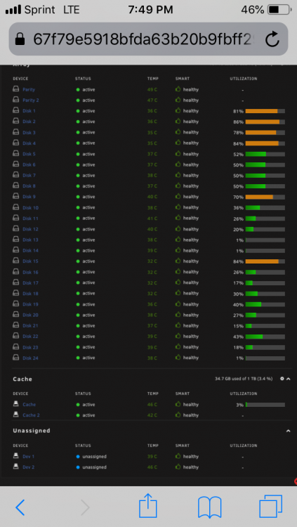

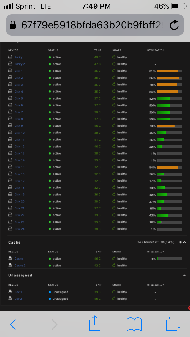

Thanks for the responses. I’m at work now but when I get home I’ll repost diagnostic logs. All of the drives are showing good smart data, at least sense I last looked. I also looked again this morning before leaving and saw that the speed is back where I’m used to seeing.

I apologize - I'm just starting out trying to help out here, and I missed the SMART data in the diagnostics you attached. It's there, and seems okay.

About to come home. Only 6 sync errors so far. I checked the drives smart status on break. Disk 13 has some reallocated sectors but I don’t know how long ago it was, it’s an old drive and the warranty is expired on it. It could be c-states, does that relate to sleep?  I had tried to use sleep once but turned it off a while ago, long before this. Should I stop the parity check and post the diagnosis now or wait till it’s done. It’s about 68%. Here’s a quick screenshot from my phone of their status.
You can find when the last few SMART errors happened by checking in the webUI under the disk's Self-Test section, click Show under SMART error log. If you're not confident interpreting it, we'll see the same data in the diagnostics.zip once it's uploaded.

Also.. I checked Drive 13's Smart error history, and it doesn't show anything...  "No Errors Logged"
