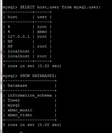

I then installed mySQL as per post 1 following the instructions up to step 2. I had no issues here. the only major difference is that instead of installing into the cache drive (or any other disk), I installed it in an SSD drive mounted through SNAP. The path is /mnt/disk/apps. I have this set up to work with crashplan without issues.
So then I installed XBMC at my desktop and added the sources, and this is where I can't get it to work. The steps I have followed are:
