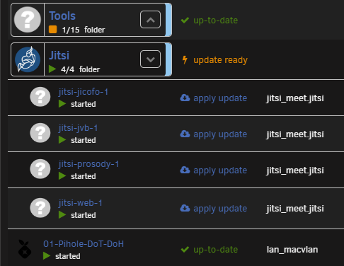

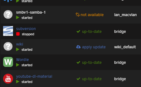

22 minutes ago, alexbn71 said:
how is this patch applied?
Settings, Compose, Patch UI...
I did enable it and click patch and can't see a difference though. 6.11.1
If the patch applied correctly, the patch button should disappear and on the docker containers page all of your stack containers (created with the compose plugin) should have "not available" in the version column.
The button is gone and one of the containers shows not available but the other 5 still have "apply update". I've tried doing an "Update Stack" on them, no change. I have the Docker Folder plugin installed in case that might have something to do with it.
I have absolutely no idea how the patches might interact with Docker Folder.
