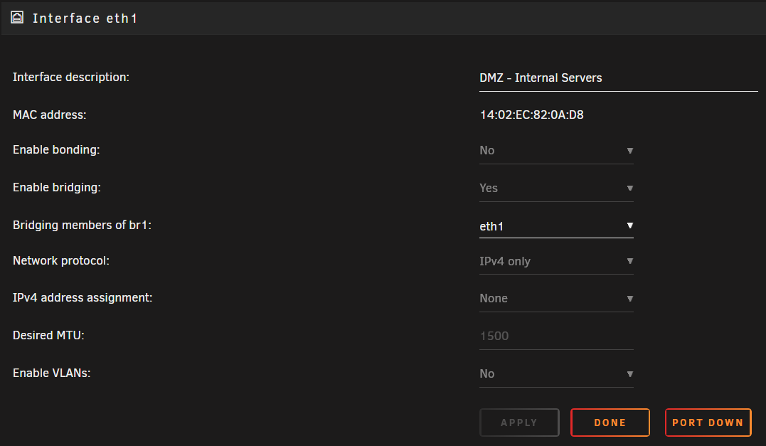

Can anyone help me with  this docker compose?
I have my dockers in general with a fixed IP on my network in the internface br1, I use macvlan
This is my typical network config
So I want nextcloud to have a fixed IP in my network and communicate with the other dockers, redis, mariadb, over an internal docker network no published in my network.
This is my coked compose file, but I'm not sure how to configure the network part, or what is the purpose of the volumen parameter at the beginning. I would appreciate any help or any other improvement you might see.

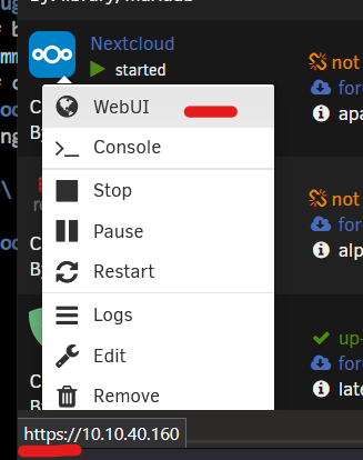

Another issue I have is that the first time I put the WebUI label I did http://[IP]:[PORT:443]/ by mistake, I have changed it to http://[IP]:[PORT:80]/ and http://[IP] but I still get this in the webuiimagen.png.82e910953779937a8bc78064c036acb7.png
Thanks in advance

Can some with experience in docker compose help me with this?
 It's related with this docker compose

I'm trying to update the dokcers in the compose above using watchtower but when It tries I get this error
The container has access to internet so I can't really figure out what the problem is

If I try to access to the url https://registry-1.docker.io/v2/
I get this
