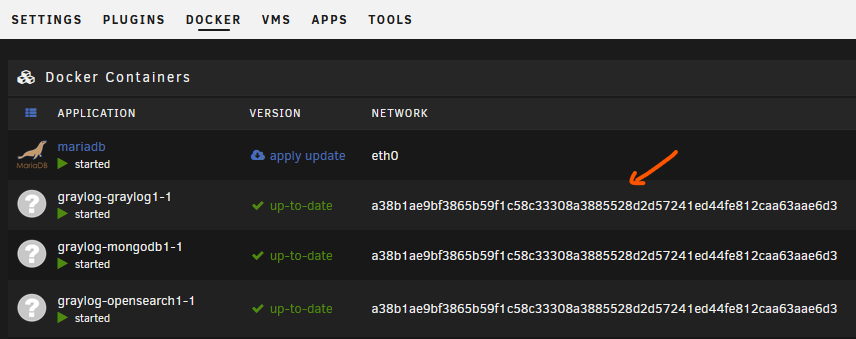

Hello,
I just want to check if this is normal in this plugin?
I'm running a normal docker compose to test the plugin.
Each of my services are running like this, example:
graylog:
    networks:
      eth0:
        ipv4_address: 10.10.10.20
networks:
  eth0:
    external: true
The Docker tab doesn't show the name of my network, instead it shows the id of it.
I'm using macvlan, "no bridge" and "no bonding"
root@Tower:~# docker network inspect eth0
        "Name": "eth0",
        "Id": "a38b1ae9bf3865b59f1c58c33308a3885528d2d57241ed44fe812caa63aae6d3",
        "Created": "2023-11-18T17:02:18.576907217-08:00",
        "Scope": "local",
        "Driver": "macvlan",
        "EnableIPv6": false,
        "IPAM": {
            "Driver": "default",
            "Options": {},
            "Config": [
Why do you name a custom network "eth0'" when there's likely already a physical interface named that it would conflict with?
6 hours ago, hrv231 said:
Hello,
graylog:
    networks:
      eth0:
networks:
  eth0:
    external: true
        "Name": "eth0",
        "Scope": "local",
        "IPAM": {
            "Options": {},
            "Config": [
I have the same config with the same result. Everything is fine the problem is unRAID compatibility with docker compose to represent the config in the webui
I didn't name it, it is the one by default when you turn off bridging and binding.
Thank you.
So.. you just use it like that?
It can show the network name correctly in the past, at least when I upgraded to Unraid 6.12.0. Not sure when and why it started showing network id only. Everything works, but it just looks odd.
Edited by sjtuross
It was an update to docker compose. They changed something about how they reference networks, which interacts badly with how unRAIDs webui detects network names.

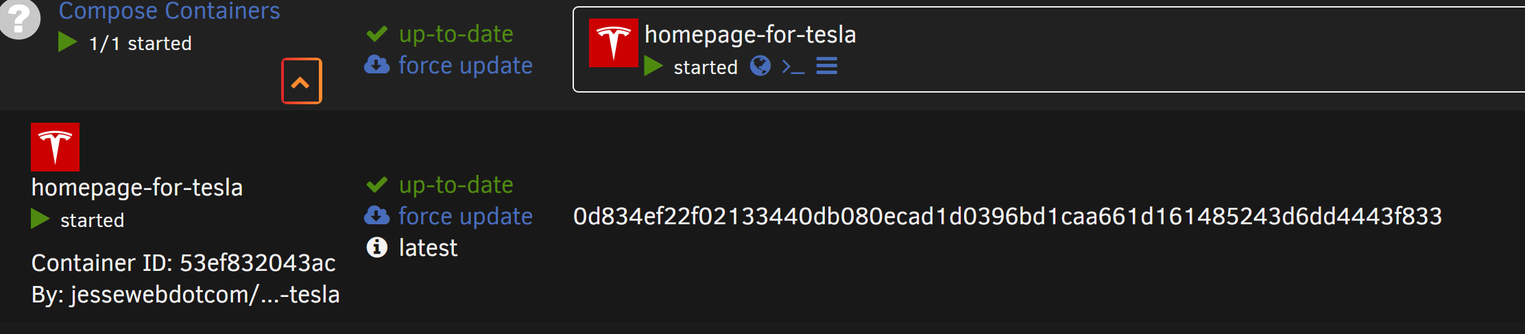

Haven't been working with Docker for very long and even less with compose.
I have a project that I was trying to get working in compose as there's no template for it is the UR app store.
https://github.com/JesseWebDotCom/homepage-for-tesla
I have a MACVLAN docker network already in place (eth0.2) for some other external services so I was trying to interpret what I found on other sites on how to add those settings to the compose YAML. I must have something wrong as it's not working at all. It doesn't crash but I can't access anything from the IP I assigned it.
If it's easier to create an UR template rather than crack the compose mystery then I'm all for that. Mind you, I don't have a clue how to do that yet either lol.
version: '3'
services:
  app:
    image: jessewebdotcom/homepage-for-tesla:latest
    volumes:
      - /mnt/user/appdata/homepage-for-tesla/bookmarks/bookmarks.json:/app/public/bookmarks.json
      - /mnt/user/appdata/homepage-for-tesla/images:/app/public/images
    ports:
      - "80:80"
    networks:
      eth0.2:
        ipv4_address: 192.168.202.70
networks:
  eth0.2:
    external: true
version: '3'
services:
  app:
    volumes:
    ports:
      - "80:80"
    networks:
      eth0.2:
networks:
  eth0.2:
    external: true
You may need to use a name without the `.` in it. So like eth02 or something. Then specify the name with the name key.
So:
networks:
	eth02:
		external: true
So:
networks:
	eth02:
		external: true
Unraid itself named the VLAN eth0.2 when I created it in the UR network settings. Perhaps if that is creating an invalid naming convention the UR devs should be notified that this needs fixing @JorgeB.
I did manage to get this working with some help from a Reddit post I put up a few days after my post here.
While it is working, it is presented differently in the UR Docker list. The network shown is the hex ID of what appears to be a new network. But it does work.
Edited by aglyons
