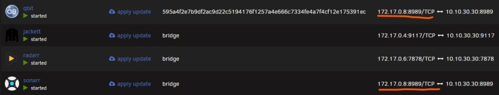

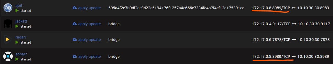

Hello,
I'm still having a problem with the plugin, when the docker compose has a mix of bridge networks and macvlan networks.
Docker compose:
services:
  qbit:
    image: linuxserver/qbittorrent:latest
    restart: unless-stopped
    environment:
      - UMASK=000
      - PUID=99
      - PGID=100
      - TZ=America/Los_Angeles
      - WEBUI_PORT=8090
      - TCP_PORT_6881=6881
      - UDP_PORT_6881=6881
    ports:
      - 6881:6881
      - 6881:6881/udp
      - 8090:8090
    volumes:
      - /mnt/user/appdata/qbittorrent:/config:rw,slave
      - /mnt/user/qb-completed:/completed:rw,slave
      - /mnt/user/qb-incomplete:/incomplete:rw,slave
    networks:
      eth0:
        ipv4_address: 10.10.30.90
  jackett:
    image: linuxserver/jackett
   //reduced info
    network_mode: bridge
  radarr:
    image: linuxserver/radarr
    //reduced info
    depends_on:
      - qbit
      - jackett
  sonarr:
    image: linuxserver/sonarr
    //reduced info
    depends_on:
      - qbit
      - jackett
networks:
  eth0:
    external: true
This is what the GUI shows:
As you can see, the docker that is supposed to have the real ip, is not showing that IP, and for some reason unknown to me, it shows the same IP as one of the dockers from the same "docker compose"
Is someone else seeing the same error?

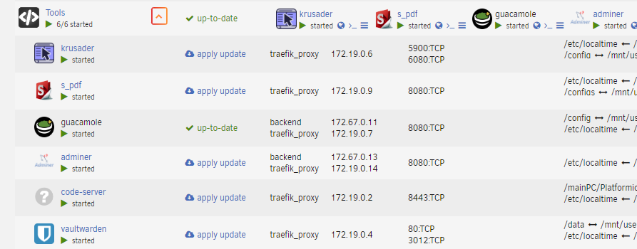

Hey everyone.
If my compose file references an existing network, in Unraid's UI the network is referenced by its ID instead of its name.
First screenshot is the UI (in the list of containers), second screenshot is the output of `docker network ls`.
Content of my docker-compose (top-level):
networks:
  default:
    external: true
Looks like a bug, because it's all working. Not sure where to report it, and maybe I'd like to get a confirmation first that is indeed a bug.
One other thing you should know is that unraid recreates these networks on reboot, so the ID will change and break the compose managed containers, unless you have the “recreate containers on startup” setting on. If not, you will need to compose down/up after each reboot
Edited by apandey
Its a known issue with the way dockerman shows networks.

On 3/10/2024 at 7:18 PM, MichelPigassou said:
Hey everyone.
networks:
  default:
    external: true
Having the same problem. Reverse proxy seems to work as I can connect to the container with the docker hostname, but it sucks not being able to see which containers use which networks in the Docker Webui.

On 3/10/2024 at 7:15 AM, hrv231 said:
Hello,
Docker compose:
Hi there, I have the same issue.
I have a feeling this is related to various other network display issues for non-dockerman containers (such as the correct network name not showing).  This just got merged:
https://github.com/unraid/webgui/pull/1616#issuecomment-2040820998
It shows multiple networks and the associated IPs.
Ports seem to not correctly show which are internal and which are exposed for compose stacks at present - I'm currently working on a fix.
