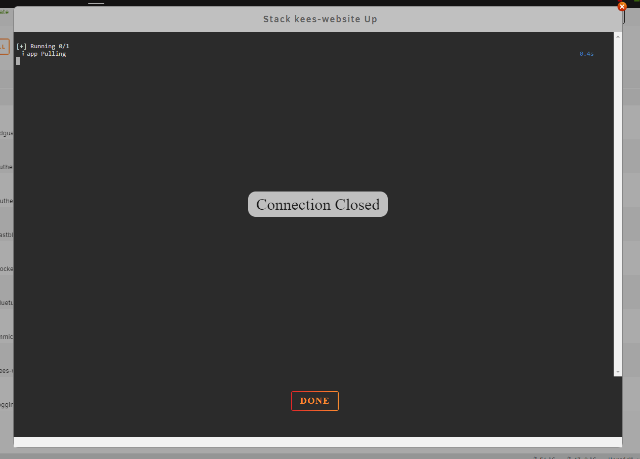

hey guys. I suddenly have an issue, where I click anything, compose up, or update stack, it opens the Modal window, and instantly disconnects. So nothing happens. Any ideas? I cant update or run most of my stacks now. I'll do it manually for now, but it's weird.
Has anything changed on your system recently? Any changes with your stacks? Anything in your system log?
Edited by primeval_god
hey. I've started noticing it didnt work anywhere. Any modal was throwing errors. The web dev console showed 507 responses I believe. That the server didnt have sufficient storage:
507 Insufficient Storage (WebDAV)
I dont know why WebDAV though? Or if they mean memory...anyway...
So i figured let's dive deeper. And multiple thing started to act weird. I then looked at my memory allocations, and usage. And it seemed there was no more free memory. At least, not real "free" memory. There was allocated memory for cache/buffer. but even that was starting to lower. At it's peak, memory used was 32GB, the rest cache/buffer (total 47GB).
So i shutdown the system. and restarted. And now it's back to normal (25GB used, 11GB cache, and 8/10GBfree). I do already see a slow incrementation in my Grafana Chart. But i guess that could also be grafana itself at the moment? This eating of my memory started when i started to setup all my monitoring (Grafana, Prometheus, Telegraf, Loki, etc.) to play around. So I'll keep a close eye on that.
Edited by Kees Fluitman
