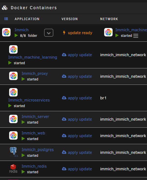

@primeval_god Could you please share the commands you use in the plugin to run compose up/down and update?
On the other hand I have this bug where this containers are detected like all of them have an updated while is not true
and when I click on apply update I get this message
"Configuration not found. Was this container created using this plugin?"
If you enable the debug option the plugin should print the commands it uses to the system log when a button is clicked.
This is expected behavior. At this time dockerman does not correctly display the update status of containers created by other plugins such as compose and the update button it provides cannot be used to update such containers..

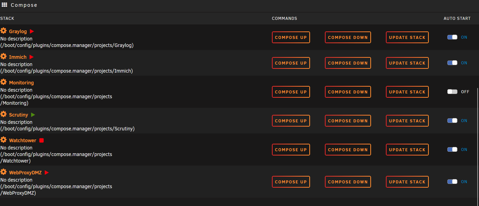

Some of my compose containers fail to start at boot, I'm under the impression that this is because some network components or other things of the OS are not ready so early. Anyone is experiencing the same thing? any way to fix it or add a delay?
I'm using only the autostart feature that comes with compose manager,
Thanks in advance.
What network are they using?
This configuration or similar (different names on the internal network)
networks:
  br1:
    driver: macvlan
    external: true
  graylog-network:
    internal: true
In a clean restart fails some of the compose fail to start, so I have to stop them and start them again.

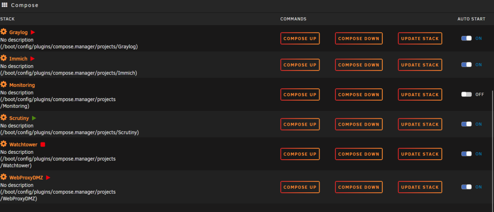

this is how it looks like after restarting the array

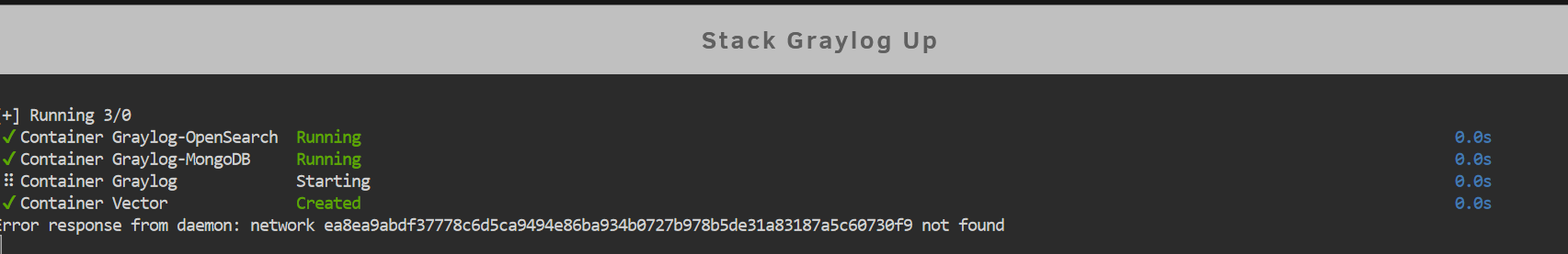

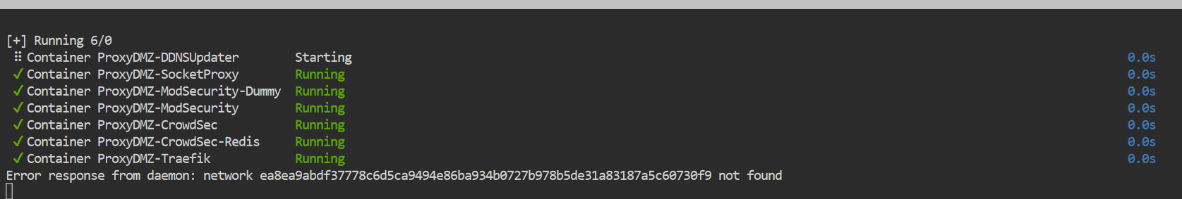

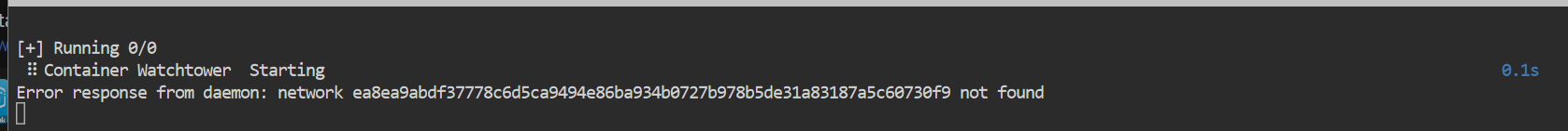

and if I try to start some of them
I have to stop them and start again to work.
Maybe a delay won't fix it and the issue is another but in any case delay and order features would be nice.
Edited by L0rdRaiden

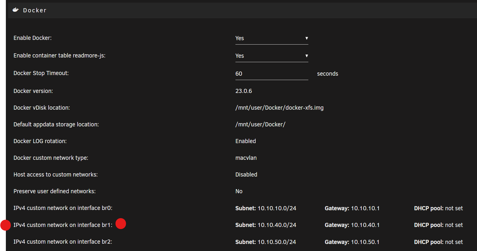

It won't, the problem is that the brX networks are recreated from scratch on each boot. The stack references the network by ID, but when it's recreated it'll get a new random ID so the network referenced in the stack will never exist. Clicking Compose Up recreates the whole stack so it now references the new network.
If you need macvlan/ipvlan for compose stacks you have to make your own network and enable "preserve custom networks" in docker settings. There should be a few posts in this thread about it.
Edited by Kilrah
If you need macvlan for compose stacks you have to make your own network and enable "preserve custom networks" in docker settings. There should be a few posts in this thread about it.
but br1 is a network created by unraid
the internal ones are only docker compose, do you mean that those networks are the problematic? in any case might be something that can be solve in the plugin side, it doesn't make sense that if the plugin launches the compose file it doesn't work and If I do it manually pressing the button it works.
Using brX is usually only required in special cases where the container needs a specific IP to have access to all ports. From a compose stack it requires the workaround I mentioned, but normally you should not need to use brX and thus not have the problem in the first place. So what's the reason for using brX in this case?
Because autostart just starts the existing containers that have been created the last time Compose Up was clicked. The Compose Up button however deletes the existing containers and creates new ones.
Edited by Kilrah
The composeman autostart runs a compose up on each stack. There should be no difference between the Compose Up button and autostart. Regardless i would bet that your diagnosis of the overall problem is correct.
My guess is that as @Kilrah is correct that the issue is the br1 network is recreated thus when compose tries to start the existing containers it fails, regardless whether it is via the button or autostart. If i understand your posts above you are doing compose down first then compose up to restart the stack. This makes sense as compose down followed by compose up removes all containers and then recreates them whereas compose up alone would just start existing containers.
Oh right, had to do a down first when I had the issue.
Therefore is a problem with the plugin, because compose manager should do a clean stop of the compose files before restart or shutdown, so on next time it will autostart without issues.
I need brx for security reasons, I need the containers to be in different vlans/networks and to setup different firewalls rules between hosts. This won't be possible if everything is behind on IP with a layer 3-4 fw.
