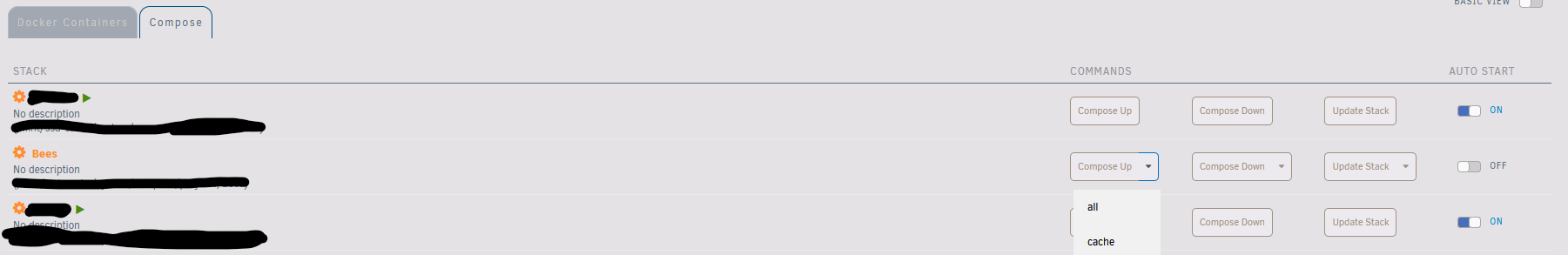

Would there be any way to include support for docker compose profiles? Currently if you click the `Compose Up` button and the compose file uses profiles, it just throws `no service selected`. If full profiles support seems unreasonable, maybe just support to start every profile in the compose file, i.e. `docker compose --profile a --profile b up`?
Basic profile support already exists. If your stack has profiles defined then the up/down buttons should appear with dropdown arrows that let you select a profile to target. Clicking the button itself will still execute the base command without a specified profile.
That's curious, i definitely have profiles defined in one of my compose files, but there are no arrows or dropdown in my ui.
Thats what it should look like.

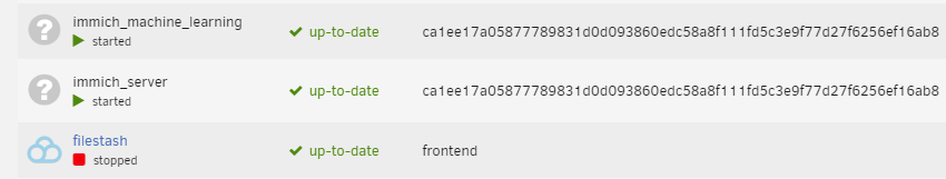

Hi.
How can I get the networks to display the correct name?
The compose file contains:
networks:
  frontend:
    external: true
Thanks
