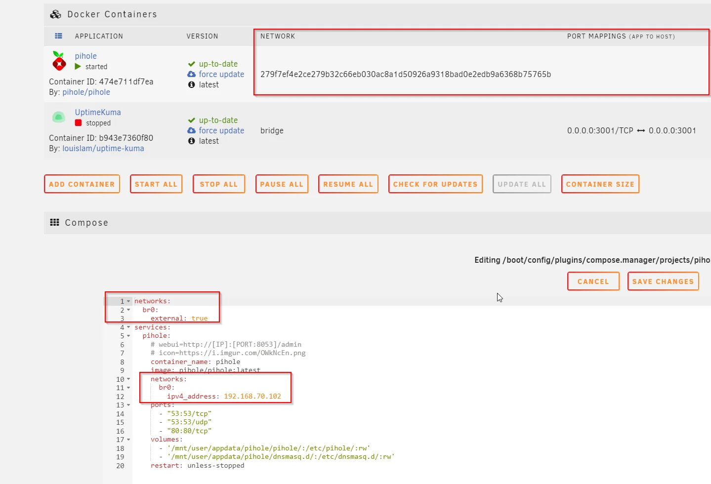

Docker Compose Manager br0 Network error
So I recently had to recreate all of my docker containers, and decided that transitioning to docker compose was a good idea in case this happened again, because I can easily recreate multiple containers at once. The issue I'm running into is I'm stuck trying to assign containers to the br0 network to assign them a static within my networks existing subnet. I've attached an image to demonstrate with my pi hole compose file. It crates a hash of some kind for the network type, and doesn't map an IP or ports at all.
Using "network_mode: br0" instead will connect it to the br0 network and assign it a DHCP address, but I can't assign it a static IP that way.
docker-compose-manager-br0-network-error-v0-85wp92h9h9tb1.png.thumb.webp.43e304ae73f19e80a301a759446c39fb.webp
I get the same but in my router pihole takes the static IP that I assigned here. Can you access the pihole webui? http://192.168.70.102/admin in your case.

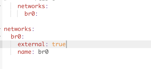

Pretty sure you need the name: key, at least it works here
Also
You can reinstall multiple at once from Previous Apps.
yes I can.
Also
I tested this:
and no change...
The hash being displayed is normal. Question is does it work?
EDIT:
yes I can.
Seems so, so what's the problem?
Edited by Kilrah
EDIT:
