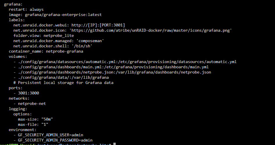

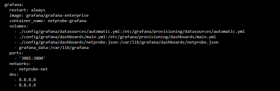

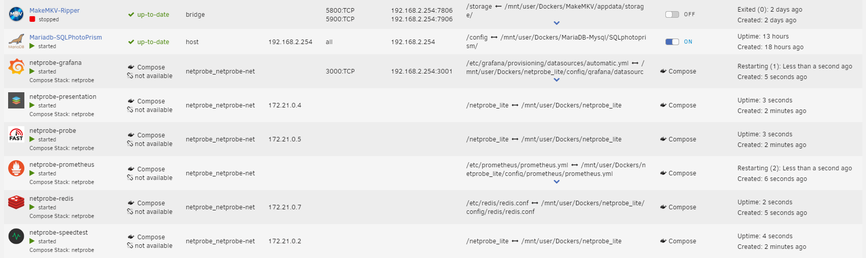

4 hours ago, primeval_god said:
@bmartino1 I cant really tell from your post what the issue with your grafana stack actually is. Is it something to do with the webui link or a continually restarting container? This plugin is not currently tested against unraid v7 (by me at least) so I am not yet familiar with the docker system changes for the beta3 version. If the issue is with the container rather than the webui integration could you tell me what version of the docker engine unraid v7 has?
Was a weird issue I encountered with how dockers get information and wirte to docekrs configs. mainly affecting grafana docker only that i found. For me a issue within netprobe.
as it only affected the grafana regardless if it was a compose file or not. (I even used the non compose form the ap store as well....)
it was more a issue within the grafan image and a change in how its environment and variable code where grafan wasn't getting a ipv4 address nor a ipv6 address while having a hostname set(seen within the bug report). Then calling this for web UI access when the webserver failed.
a glitch that only affect Grafana where when the unriad webui calls [ip] [port] I got its hostname continually with no connection as the ip wasn't resolvable and grafan webserver not running.
I had to do quite a bit to fix grafan from deleting it image and reform compose, trying it standalone, same thing.
I now have a working netprobe once more after updating the docker compose for grafana. Weirdness on unraid v7 beta 3.
Reached on with a bug report, here and on the support for the appstore graffana image. Just bring it up.

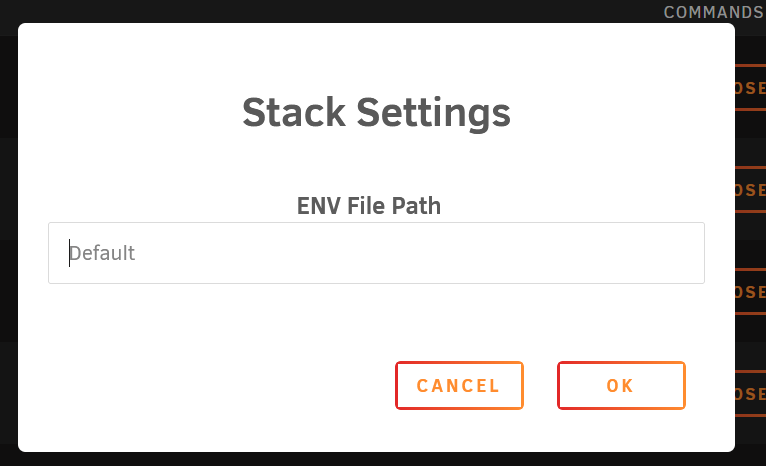

2 hours ago, L0rdRaiden said:
@primeval_god I'm trying to do this
https://forums.docker.com/t/how-to-reference-several-env-file-with-absolute-paths/144653
Is there any limitation on how docker compose or docker is implemented in Unraid that doesn't allow my to do it?
Basically I want to use several .env files in different places in the same docker-compose.yaml
Thanks
I'm only aware of the web ui and compose plugin allowing 1 env file you would need to combine all the env files in 1 .env file.
Thanks
As far as I am aware there are no limitations that would prevent you from doing this. There is no support for editing the extra env files in the compose manager ui however.

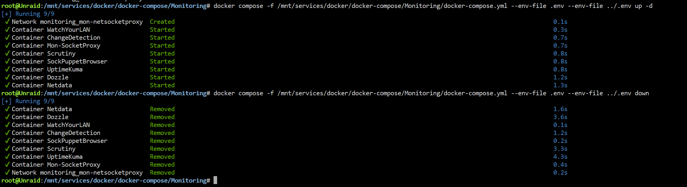

Ok, but I guess I would need to setup a script to run this on every array start with absolute paths (not relative like below) for all the docker-compose files that I want them to use 2 ENV files. And them in the same script do the compose up for all the docker compose files. Right?
docker compose --env-file .env --env-file ../ininventory.env up -d
Edited by L0rdRaiden
Apparently i didnt read the info closely enough. It looked to me like they were showing referencing multiple env files by absolute path from within a compose file.
I finally found the solution but it would be perfect if it would be integrated in compose manager
The change is "simple" it simply requires to add additional parameters to the up/down compose command
docker compose -f /mnt/services/docker/docker-compose/Monitoring/docker-compose.yml --env-file /mnt/services/docker/docker-compose/Monitoring/.env --env-file /mnt/services/docker/docker-compose/.env up -d
docker compose -f /mnt/services/docker/docker-compose/Monitoring/docker-compose.yml --env-file /mnt/services/docker/docker-compose/Monitoring/.env --env-file /mnt/services/docker/docker-compose/.env down
Can you add support to this? like allowing several env files in the stack?
