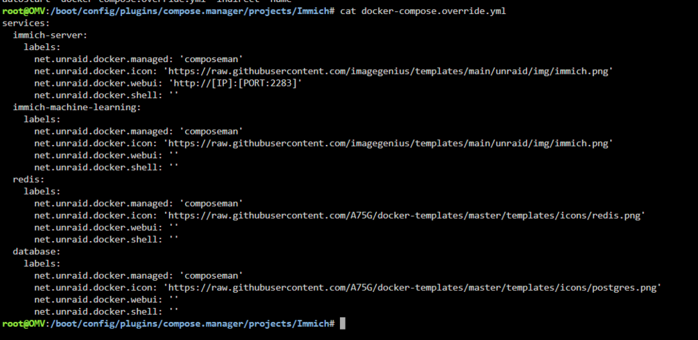

I keep my docker compose files in version control and apply them to unraid server using ansible. The reason it doesn't work for you is because the unraid managed labels get overridden in a separate docker-compose.override.yml file sitting next to the docker-compose.yml
assuming your stackname/docker-compose.yml has the following:
services:
  serviceA:
    image: something:latest
    labels:
      some.non-unraid.label: some-value
then create a stackname/docker-compose.override.yml with something like below. I use folder view plugin, and have some unraid labels there too, but you only need to include what you want
services:
  serviceA:
    labels:
      folder.view: Network
      net.unraid.docker.managed: 'composeman'
      net.unraid.docker.icon: 'https://url/to/icon.png'
      net.unraid.docker.webui: 'http://[IP]:[PORT:8443]'
      net.unraid.docker.shell: '/bin/bash'
you can check the contents of /boot/config/plugins/compose.manager/projects/<stackname>/ to see the structure (I also deploy name and autorun files to fully automate my setup)

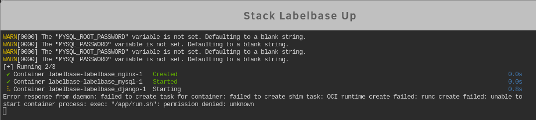

I'm trying to get this set of containers up and running:
https://github.com/Labelbase/Labelbase/blob/master/install.md
So far, so good, but I'm getting a permission error when it tries to start the Django container.  Is that an indication that it needs to be run with elevated privileges, or is there something else going on here?  I don't really like running these as root.  Feel it's not worth the risk and I don't have the time (or knowledge frankly) do look under the hood.
Thanks all, great plugin so far!
This thread is for questions about the composeman plugin itself rather than specific compose stacks. As this is pulled from github, (not the envisioned use case of this plugin) I might hazard a guess that some of the file permissions are incorrect as unraid doesn't really have users other than root. How that interplay with permissions withing the container environment I dont know.

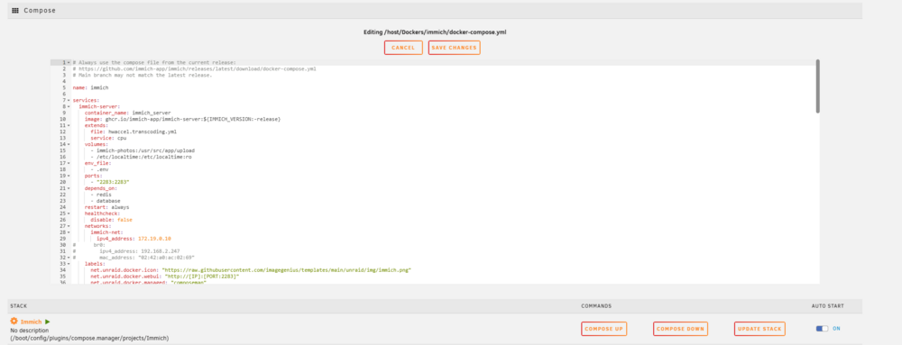

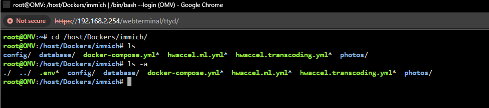

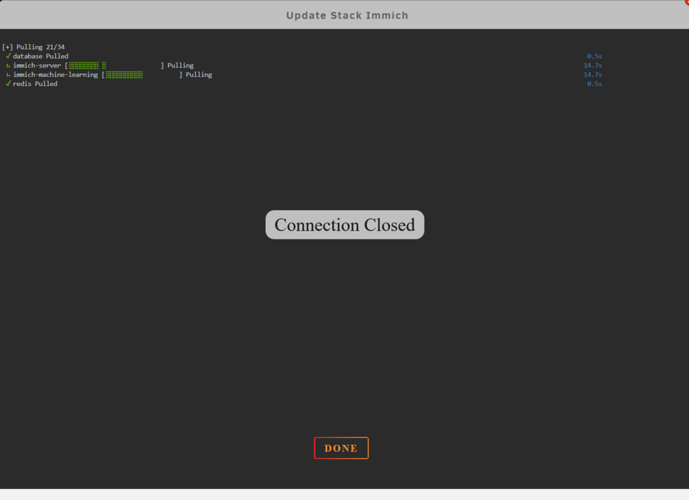

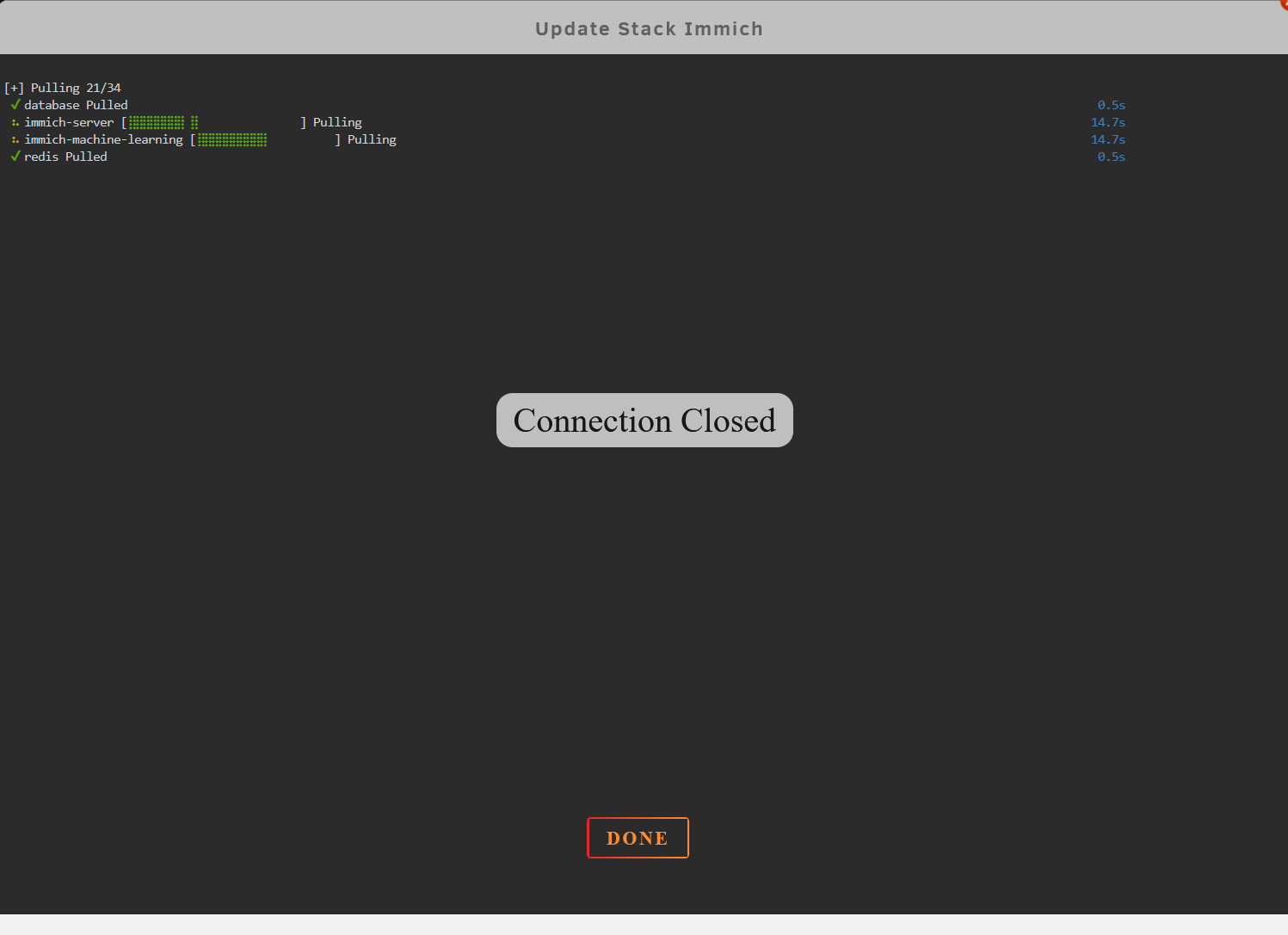

Hi:
I'm having a issue while trying to update a stack, I get a connection close before it pulls all the containers images:

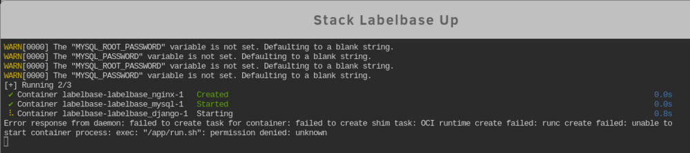

Hey thanks for your response!  Didn't realize I was in "off-label" territory.  You were right in the sense that it was some kind of permission issue.  I had it in the folder /boot/config/plugins/compose.manager/projects/ but was unable to chown on it there for some reason.
I was able to fix it by moving it to /mnt/user/appdata and:
chmod -R 0777 /mnt/user/appdata/Labelbase/
chown -R nobody:users /mnt/user/appdata/Labelbase/
Yeah this plugin is really designed for simple, single compose file, single env file stacks created via its webui. Stacks that are pulled from elsewhere can quickly start to get more complex than this plugin was designed for.
