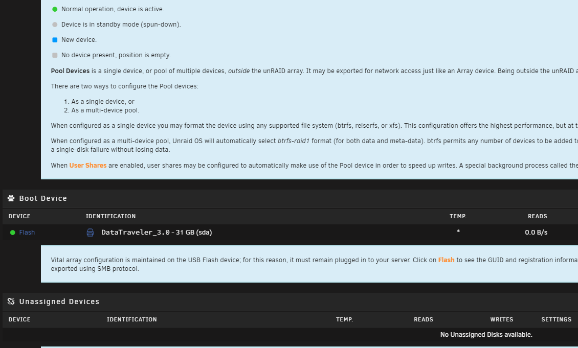

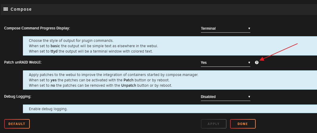

I think there is a bug when activating the help on compose settings, here:
If you keep this activated and moves around the GUI all tooltips are activated and if you turn it off one of these they are still active returning to the same page. You have to turn off "?" on compose settings to bring it back to normal GUI behaviour.
The help icon switches the global help on in unraid. You should be able to turn it off by unclicking the help icon in the side bar.

Is there a way to change the log level? I would like more info.
Edited by VideoVibrations
Check the settings page.
