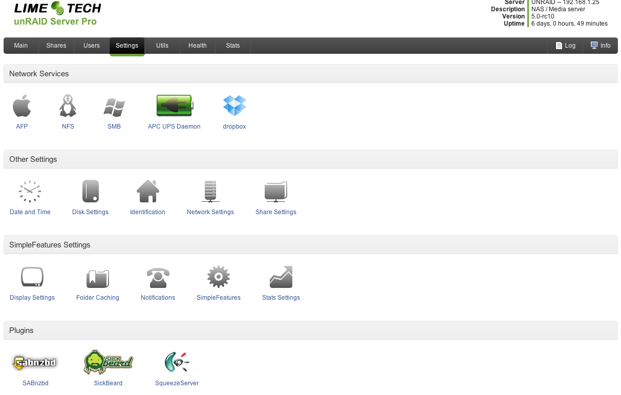

There is a APC UPS plugin that can be used in SF. I'm using this one:
http://lime-technology.com/forum/index.php?topic=15583.0
Ha! Thanks Jowi, that is exactly what i was looking/hoping for! actually, i did see this plugin being listed, but wasn't aware that it would be this cleanly integrated into the SimpleFeatures UI.
Since i'm such a noob with the Terminal, would you mind sharing with me where on the Flash i need to copy it, and how to install/invoke it? is it one of those "install on every boot" things, or do i only install it once?
what terminal commands will i have to execute to get it to work?
sorry for being so ignorant about it, but i've got everything dialed in so nicely right now, that i don't wanna take a wrong step!
The first post in the link explanes how to install, pretty simple :)
Once installed, it will show up in SF.
