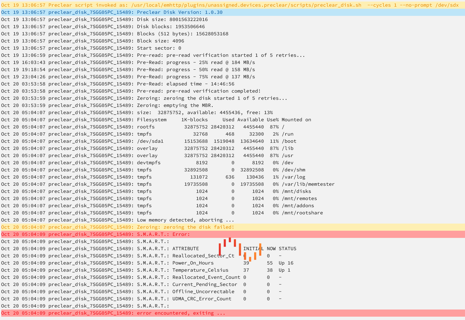

when I run preclear any disk, it seems to fill up rootfs which is usually only at 3% usage. At some point, the GUI will become inaccessible and I am unable to pull the logs. On my most recent attempt I left the preclear log open and this was all I could get from it before the error happened again. Any idea on how to troubleshoot this?

#   Airflow_Temperature_Cel     39      -                                                          #
#   Current_Pending_Sector      0       -                                                          #
#   Offline_Uncorrectable       0       -                                                          #
#   UDMA_CRC_Error_Count        0       -                                                          #
#       Report genereated on: December 21, 2024 at 23:14:07                                        #
Can't tell if there's any particular errors here or not to be honest - is this just normal? The speeds seem to be reasonable (~240MB/sec on both drives), and the process is happening at the same time, so it's not like it is pausing one to progress the other - they both pause and unpause within a few seconds of each other...
I believe both of these drives are connected to an HBA card rather than directly to my motherboard, I suppose it's possible that running a preclear on both might be overtaxing that card? I haven't done much with the server so the other drives attached to the HBA are mostly spun down.
Any ideas appreciated! Not sure if I should attempt any SMART tests while the preclear is running?
