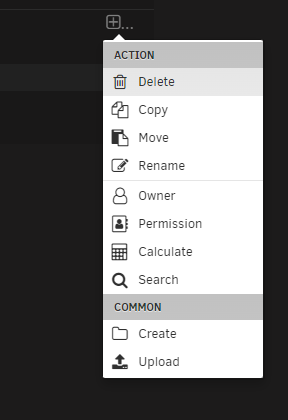

  • What I like to see in a future release:   1.) The breadcrumbs disallows copy&pasting the path: Without plugin: Maybe you could add a "copy to clipboard" feature or
When opening the menu on the right there seems to currently be no way to close it again, clicking outside of it just leaves it there, obscuring the + icons for files below it. Have to change page and come back.

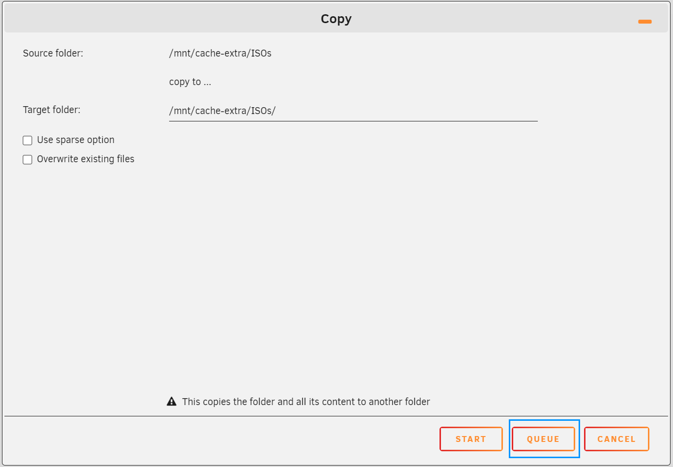

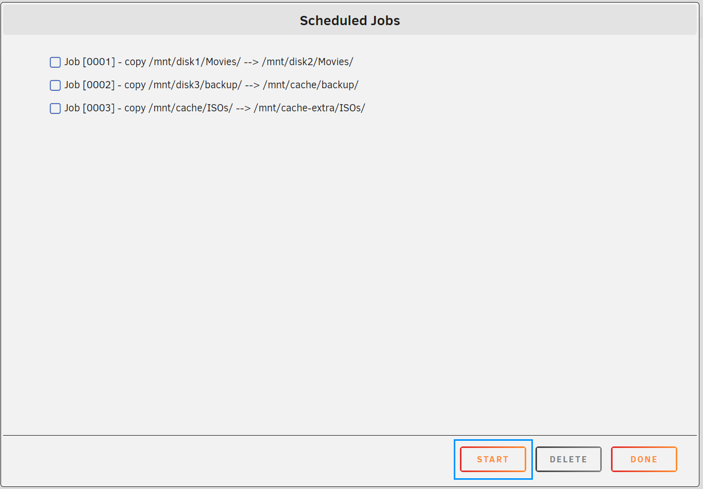

I am happy to announce that the next version of DFM has scheduled jobs.
This feature allows to create one or more tasks and put them in a queue, which can be executed upon request.
This version is a major rework to make everything possible. Quite a lot of effort was put in developing and testing to ensure correct operation is in place, but please report anything unusual.
Once the queue contains operational tasks, these can be viewed by clicking on the JOBS button.
Clicking the JOBS button opens a new window, which shows the scheduled jobs in the queue.
The user may delete any unwanted jobs before starting, therefor select the jobs to be deleted and then click DELETE, this will reorganize the list or make the list empty when selecting and deleting all scheduled jobs.
Click  START to begin the schedule.
Jobs are executed in the order they appear and the next job starts when the previous job is completed.
There is no check for correlation between jobs, it is the responsibility of the user to make sure jobs do not interfere with each other. Once started, progress can be followed in the footer.
Press the DFM icon to open the current job and see the details of the operation.
To hide the window click the minimize icon at the top right and progress goes back again to the footer.
When you CANCEL the job, then the current job terminates, but other jobs in the queue stay there (the queue is not emptied) and the remaining jobs can be started or revised by following the steps as explained before.
Hope you like this new addition :)
Same situation with me on Firefox, Edge and Chrome on windows 10 (all last versions)

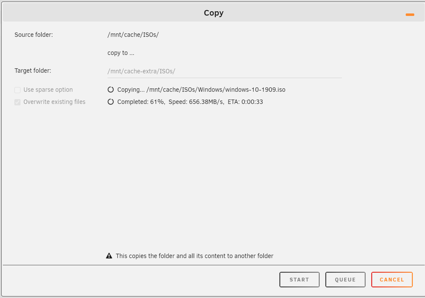

I think I found a small bug:
Being in the Dynamix file manager GUI on the Unraid server, I used "upload" tab to copy an ISO file from a client PC to the Unraid ISO share. It worked without any issue, but I saw that the speed indication next to the percentage of already copied data is wrong
The speed indication shows kB/s which is wrong
Correct should be MB/sec
with kByte/sec speeds, the copy would take hours and hours... but in reality it was quickly finshed...

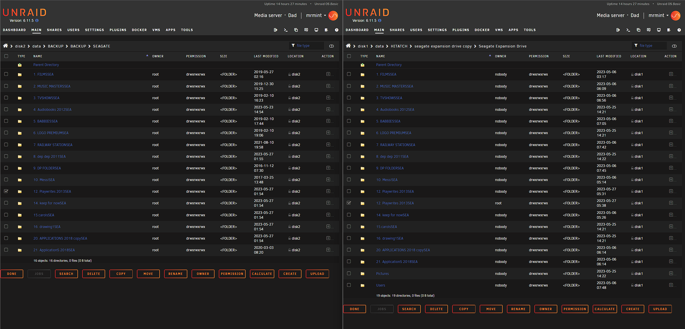

Hello, looking for a little advice on how to use this plugin to suit my needs.
Current I have two copies of the same folder on two different disks for one reason or another I am not sure which one is the most recent so I would like to simply 'move' folder from disk 1 over to folder a in disk 2. However, even when I click on overwrite existing files it seems to create a new folder with the exact same name which is no what I would expect. See screenshot and folders 12 and 13 on the right widnow.
Also I have search everywhere, what does the 'use sparse option' do. I cant find it being mentioned here and the documentation one page one appears to be out of date.
Any clarity one the above would be appreciated.
Cheers
There can't be 2 folders with the same name in the same location so likely there's a different character in the 2 names (note it's case-sensitive too). Maybe list in terminal, might be more obvious there
Hi. There appears to be from what I can see. Anyways, can you help with my questions above. How can I copy from one disk to another and overwrite the same folders without creating a duplicate?
Also what does the  'use sparse option' do?
Thanks
Edited by mrmint
As said that can't be so look in terminal, the GUI might be hiding a difference. If different then fix that so they're the same then it'll work.
Sparse is for files e.g VM vdisks that are allocated as sparse, i.e. even if the file is supposed to be 100GB it'll only use what's actually needed until all of it gets actually used, saves space. Copying without the sparse option would make them use the full size, the option however retains the savings.
