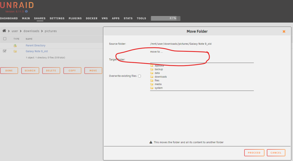

4.) Typing the target path should automatically update the dropdown accordingly
5.) Typing a path should auto-complete (TAB would be a dream to confirm)

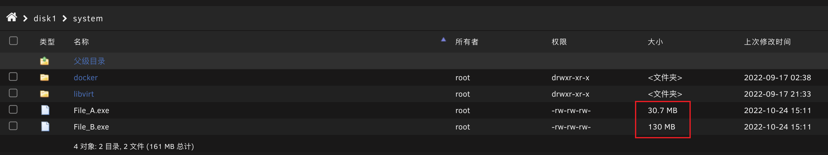

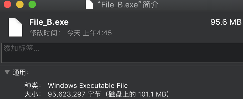

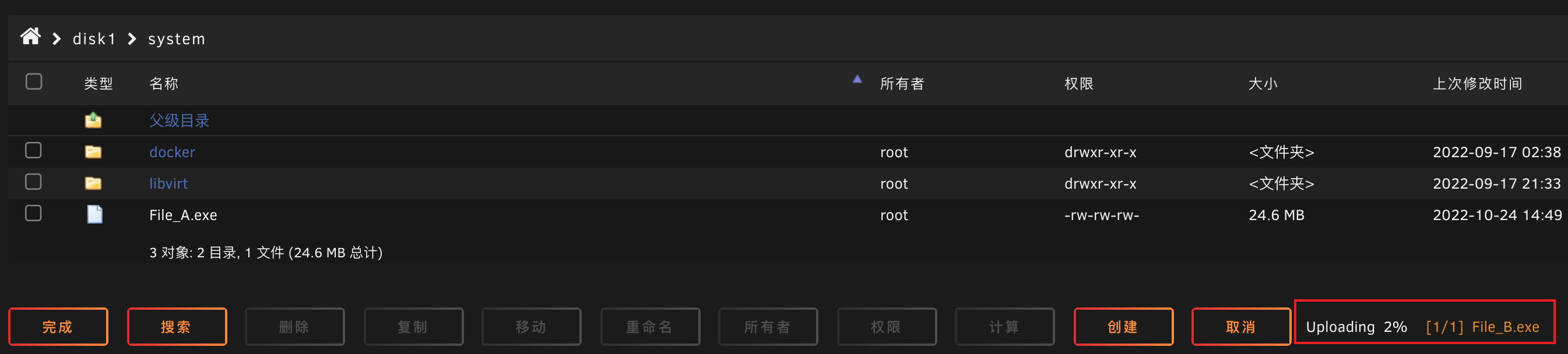

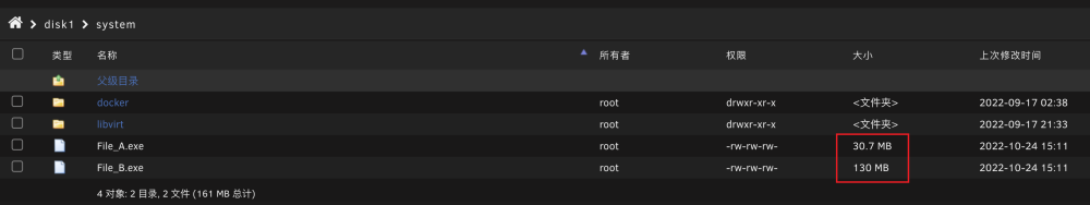

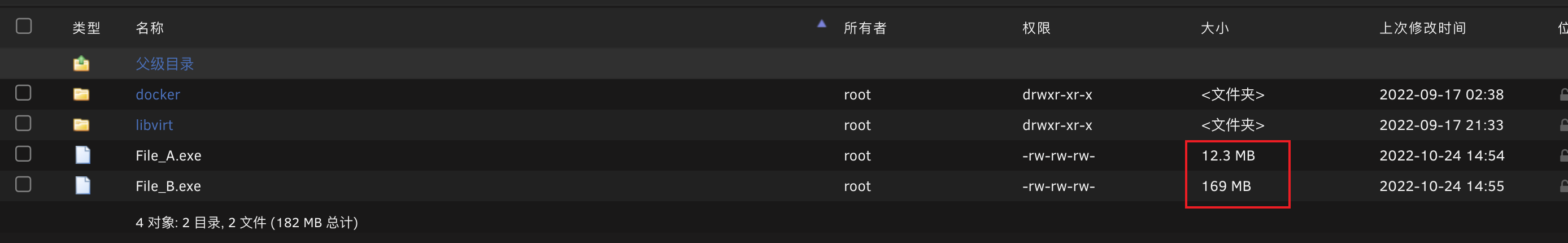

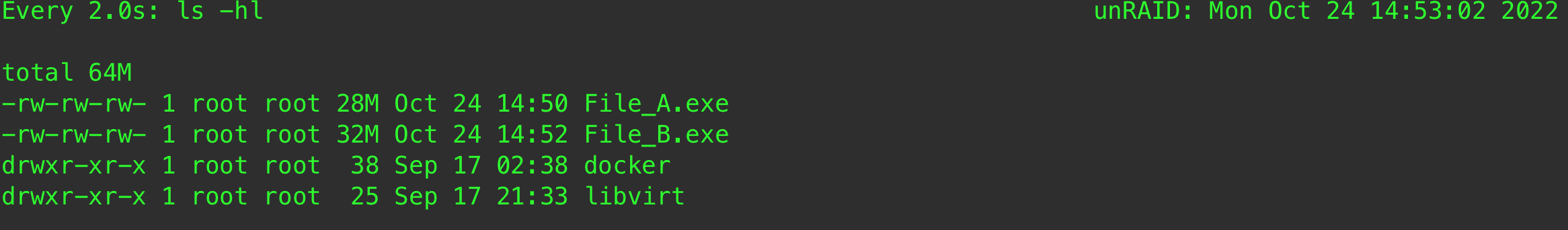

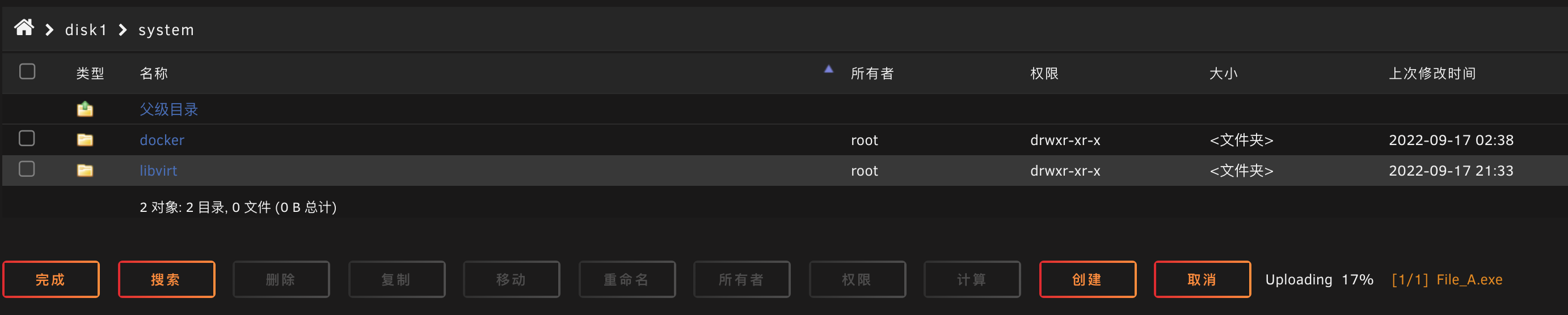

Several problems were found during use:
unRAID version: 6.10.3
Dynamix File Manager version: 2022.09.07
1. Multi-process upload is not supported
    (1). Open two browser windows to upload files respectively, first upload "File_A" in the TAB_A window, then upload "File_B" in the TAB_B window, use "watch ls -hl" in the shell to check the file changes, and find that only "File_B" "Uploading, and "File_A" appears to be interrupted after "File_B" performs the upload operation.
2. In some cases, the uploaded file is corrupted
    (1). The operation steps are as above. After the "File_B" transfer is complete, the file size is different from the original file. The original file of "File_B" was 95.6MB, but after uploading to unRAID it was 169MB, the file size of "File_B" seems to depend on how much "File_A" has already uploaded.

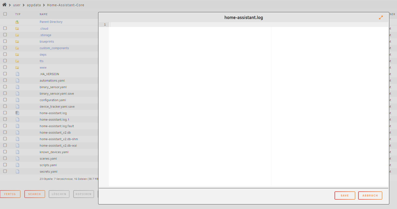

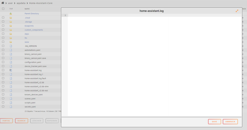

Hi, I like the plugin very much but I have a problem with it. If I want to open a config file or a log file, all files are displayed empty. Does somebody know the problem and how to fix it?
That looks like an actual empty file, what's its size?
Hi Kilrah, thats the point. It looks like an empty file but it isn't. The file size is 3.43 KB. All files look like empty files. thats my problem :)1749085760_Screenshot2022-11-02095742.thumb.png.61b059a0d0b37397214135840042b854.png
Edited by Truebsal
typo

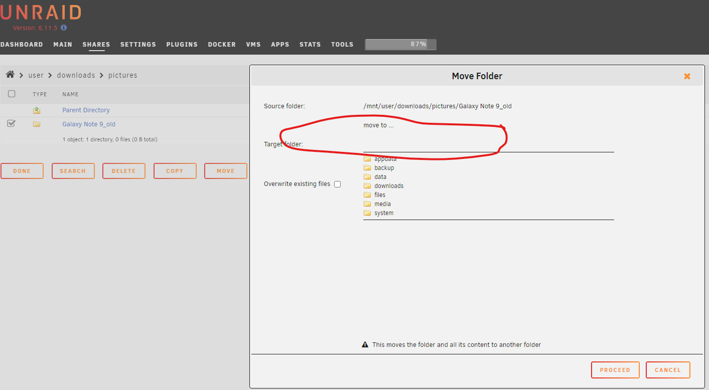

Is there a way to move/copy files from a share to an UD?
I cant seem to find a way to move/copy any files from any of my shares to a mounted external HD.
I would like to remove a bunch of files from my server and store them on an external HD.
Any help woudl be appreciated!
Thank you!

On 12/9/2022 at 4:51 AM, Kilrah said:
You can do it from the GUI, from the terminal with cp/rsync/mc, from containers like krusader,...
UD drives are in /mnt/disks/[mountpoint]
Thank you for the response....
I have been using the terminal for years...with the GUI I figured it would be nice to move items off the shares to my external UD drives, but still see no way to do it.
When I try to move files from a share to a UD...the option to pick from /mnt/disks/[mountpoint] is not there...even if I enter the UD share manually, it will not move the files...
Maybe this will be added to a futer version of the GUI file manager??
Edited by airbillion
You need to access from the file manager button, not from "view share" on the shares tab
That puts you in /mnt.
Edited by Kilrah

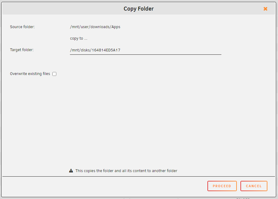

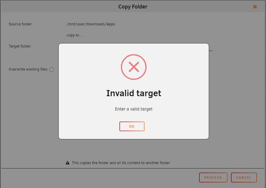

Hello,
Yeah...I have tried that already, but still not possible to use the GUI to cop/move files from a share to a UD unfortunately...
If you try and select a /user/<SHARE> you cannot then copy/or move the files to a UD:
If you manually enter the UD...it errors out with "Invalid Target":
Hopefully this will be added in an update!
Ah yes, that might be intentional. Can do from diskX to UD though.
Terminal, or mc, or krusader etc then.
Edited by Kilrah

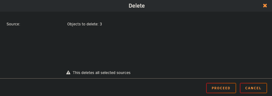

this plugin is a big help - thank you! I have one suggestion for a future release though:
when I select a single item to be deleted, copied or moved, the confirmation prompt shows me the full file path of the item I want to process. However, when I select more than one item to be deleted/copied/moved, the confirmation prompt just shows "Objects to [operation]: n", although it occupies the same amount of screen space as it does when printing out the full path of a single selected item.
I'd suggest to also output the full paths if multiple items are processed, as this can make it easier to review which items will be affected. The list could be printed into a scrollable container similar to how e.g. output for app updates is displayed, so even printing dozens of file paths should not be an issue while using the same amount of screen space.
