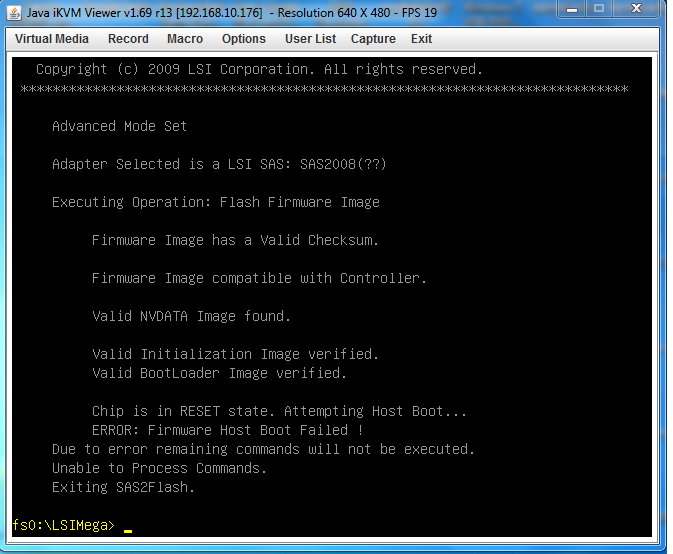

I got stuck yesterday flashing my IBM M1015 using "LSI MegaRAID to SAS2008(P11).zip". The initial 3 steps worked fine, but step "5it" failed.
Steps "5it" and "6" I perform with sas2flash.efi.
I tried that too with this result: What am I doing wrong?

Can you please exactly describe how you did that. Which BIOS version? Which sas2flash.efi version. I have a X9SCM-F but keep getting a chip is in RESET state, trying to boot host error.
What version of firmware do you have on the card now?  What version are you trying to flash to?
The card had the original IBM M1015 firmware on it and was erased. Now when I try to flash the IT firmware (P11) I get the error shown above.
