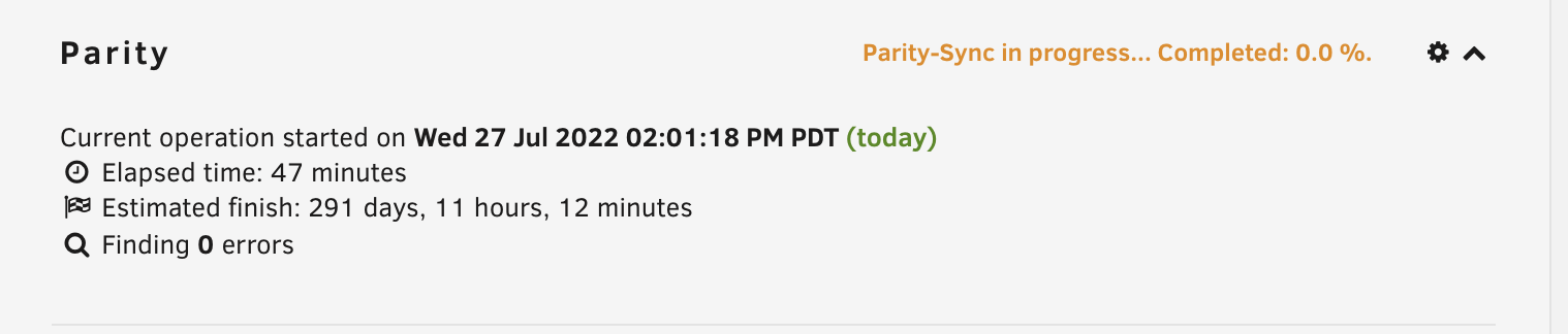

July 27, 20224 yr I configured my array with parity2 16 TB disks with data disks 4 16 TB and 9 14 TB disks. 2 14 TB disks as cache. When I started the array, Parity sync started with 291 days which ridiculous. I'm afraid that I bought the pro license unnecessarily. I was using Truenas which was so good even though its free. So any help on this will be appriciated.
July 27, 20224 yr Community Expert Need to know more about your setup. Parity build will read from all data disks at the same time (and write to both parity ones), you need an appropriate hardware setup to not run into bandwidth bottlenecks. Using HDDs as cache makes little sense, that's a job for SSDs. Edited July 27, 20224 yr by Kilrah

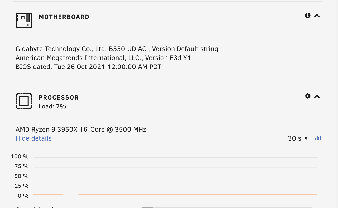

July 27, 20224 yr Author Thanks for quick response. I know the its no sense using HDD for cache. My thought to make this cache is to transfer the data from my old Trunas server to new unraid server. If I try to write the data to parity enabled array. Its too slow like 40 MBps. So thought that I can 1st transfer the data to cache with 10 GB network port with some 350 Mbps and transfer the data to array. My Setup contains AMD Ryzen 9 3950x with 64 GB 3600 DDR4 RAM and Nvidia Quadro P4000 GPU. SCSI Raid Card ASR-78165 (6 GBPS) in HBA mode.

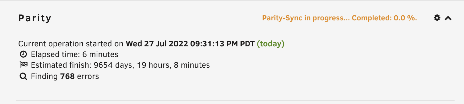

July 28, 20224 yr Author I tried that too 1st I loaded the data and then added parity. For sync it shows around 9000 days.
July 28, 20224 yr Community Expert 20 minutes ago, NetPlex said: I tried that too 1st I loaded the data and then added parity. For sync it shows around 9000 days. The point was to make initial data load faster since parity isn't involved. Remains to be discovered what is the problem with your parity sync.
