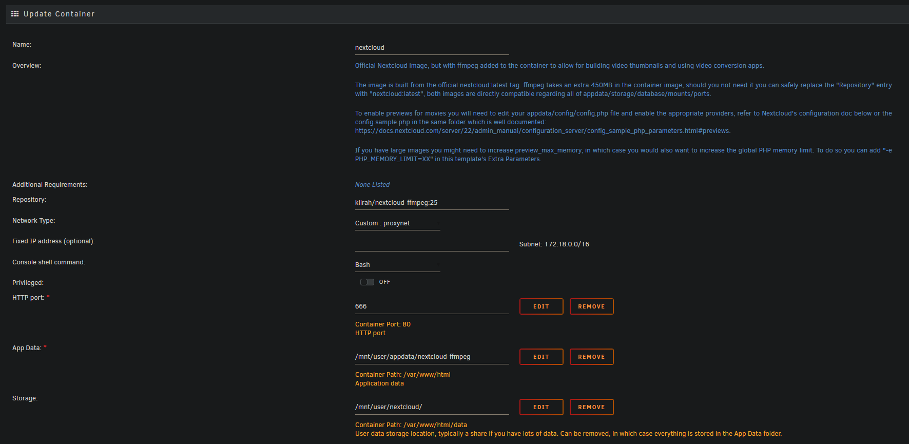

If you mean the container template then sure:
Else you might need to tell me exactly what you need :) Hopefully this is it tho!
Usually I don't mess much with templates unless absolutely needed (like going for the :25 version of yours and ports)
Edited by kftX

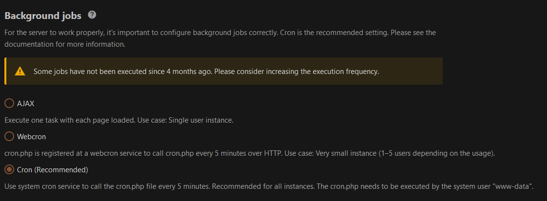

After running this I was still getting the same error, so I went to the cron settings on a whim and changed from AJAX to Cron
And now the error has gone away, so is it fixed or did I just do something to make it not trigger?
I changed back to AJAX afterwards and I still get:
So now I'm very confused lol
Link to comment
Just now, Kilrah said:
Ah, never tried AJAX.
Recommended method is Cron, with the Nextcloud-Cronjob container as described in the first post.
Yup, I'm gonna play with that next and that's why the red message go to me. I've never played with cron so it's just another chance to learn. In any case, it seems fixed! Thanks for your help :D

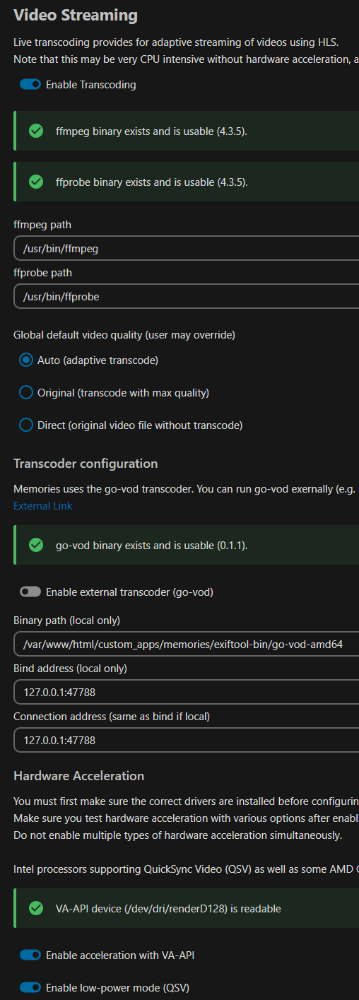

I found the Memories app and then your container. I shifted the repository of my nextcloud instance and pulled it down. Running fine but the memories app doesnt see the ffmpeg binary. Is there a location I could tell it?
Also Im getting VA-API device (/dev/dri/renderD128) has incorrect permissions. What does this mean?

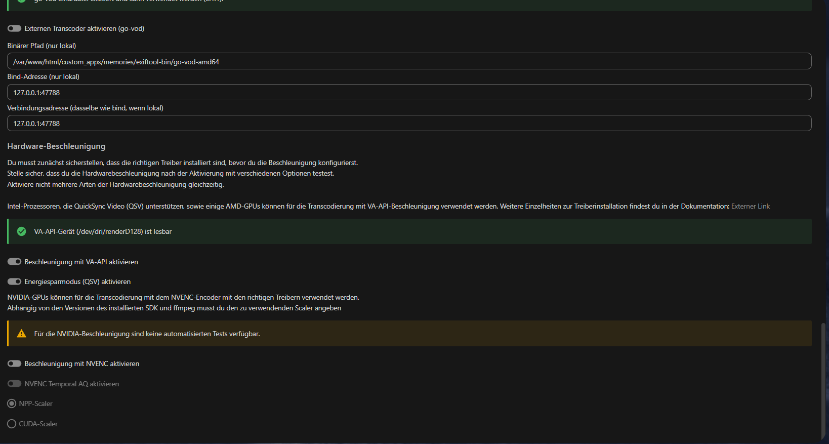

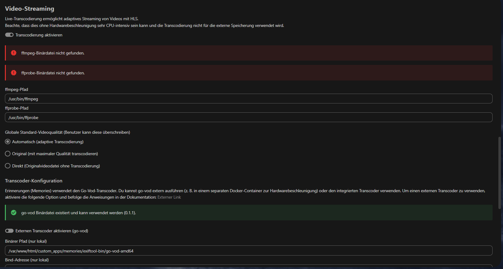

Hello everyone, I am currently using the official Nextcloud container from knex666 in connection with MariaDB.
I have now discovered the Memories app for myself and also passed my iGPU (Xeon E-2176G) through, but ffmpeg still seems to be missing.
Can I now just stop docker and use this one instead?
