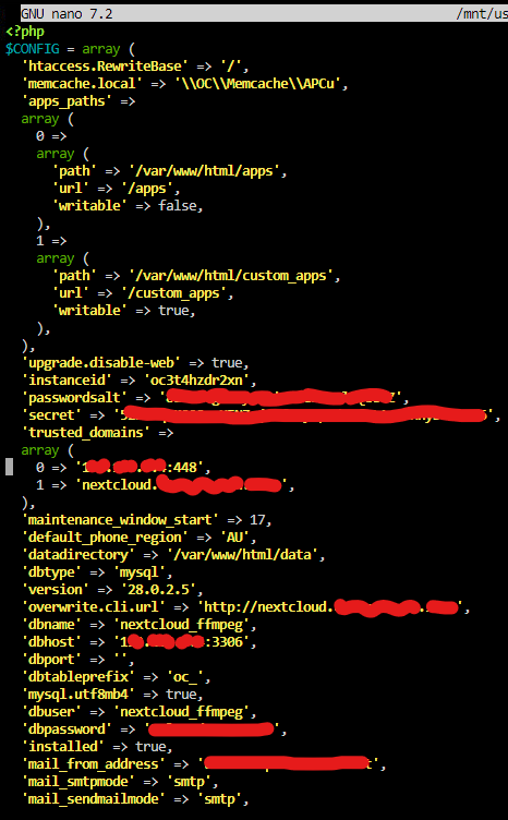

ceverson Posted January 6 Share Posted January 6 okay so any suggestions on how we fix it. ive tried reinstalling twice here is my config file and php file and my nginx config screenshot config php Log file for next cloud Quote Link to comment
Kilrah Posted January 7 Author Share Posted January 7 What's the problem? Logs doesn't seem wrong. Config seems to be missing an entry for whatever URL you're using to access it in trusted_domains. Quote Link to comment

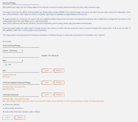

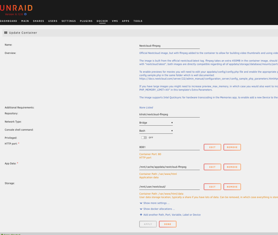

sinuz Posted January 14 Share Posted January 14 Every night i use the appdata-backup to stop, backup, check for updates and restart my nextcloud-ffmpeg container. Most of the mornings after i am greeted with an error explaining the data directory is readable by other users suggesting to change the folder permissions to 0770. The folder permissions as visible from within the container are drwxrwx---. The only thing notices that has changed is the owner of the data folder(volume) in the docker container, when i change it back with chown www-data:www-data data (from within the container cli) the error goes away. Perhaps relevant: the data volume is mapped to a different share ("nextcloud"). Any suggestions on debugging this issue? Quote Link to comment
Kilrah Posted January 14 Author Share Posted January 14 Is that share on a zfs drive by any chance? Quote Link to comment
sinuz Posted January 14 Share Posted January 14 Both appdata and the data share are on my pool which is indeed formatted with zfs (Unraid 6.12.6). Quote Link to comment
Kilrah Posted January 14 Author Share Posted January 14 (edited) It seems when creating ZFS mountpoints unraid always sets the permissions in a certain way that's incompatible, noticed that when trying. https://forums.unraid.net/bug-reports/prereleases/unraid-os-version-6120-rc2-available-r2310/page/5/?tab=comments#comment-22816 Maybe putting the data share contents one folder deeper could help. Edited January 14 by Kilrah Quote Link to comment
sinuz Posted January 15 Share Posted January 15 (edited) Thanks! I moved my data one folder deeper. I'll report back if it works Update: after about a week and multiple tries to reproduce the problem everything is still working, moving the data one level deeper solved this issue Edited January 21 by sinuz Quote Link to comment

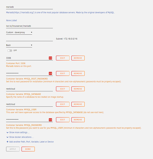

cruzerkk Posted January 22 Share Posted January 22 6 hours ago, Kilrah said: Seems like it could be an error with the database. Yeah. Looks like it is looking for a specific table and it is not finding it. "An exception occurred while executing a query: SQLSTATE[42S02]: Base table or view not found: 1146 Table 'nextcloud.oc_appconfig' doesn't exist" Any idea where nextcloud.oc_appconfig is expected to be present or defined ? Also, I'm not facing this issue when using the linuxserver respository. Weird that I followed the exact same steps and seeing this error only in this repo. Is this something within the mariadb container? I wonder if this has something to do with the /var directory being used. A couple of differences I noted between the linuxserver's container (which works) and this one is that: 1. When I opened the Nextcloud webUI for the first time and set up my admin credentials and mariadb info, the Data Folder provided was different. For the linuxserver repo it was just /data and for Kilrah's it was set to : /var/www/html/data 2. Also , in the container settings I see that there is an extra setting for "App data" present with container path set to "/var/www/html" and Storage has container path "/var/www/html/data". I did not touch the /var directory when working with linuxserver's repo, as far as I remember. Could this be something ? Sharing screenshots for comparison of container settings linuxserver: kilrah: Quote If you haven't enabled redis in the config yourself it shouldn't be related. No, I haven't done anything with redis. So looks like that's ruled out obviously, in light of the Database error above. Quote Link to comment

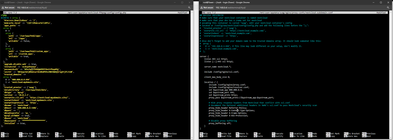

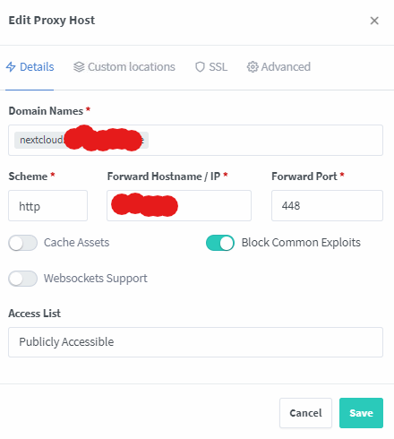

Daver1 Posted February 24 Share Posted February 24 First off, Thankyou @Kilrah for all your time and efforts on this version of NC and all the support you have provided!!! Wondering if you may be able to give me some help. I'm and absolute begginer with all this. I have the below error. Originally i had an issue with trusted domain so i added the trusted domain to my NC .config file I alos changed the overwite.cli entru but have since changed that back to 'https://000.000.0.0:448', Im using Nginx proxy manager for the reverse proxy. Quote Link to comment
Kilrah Posted February 25 Author Share Posted February 25 Could be that overwrite.cli.url needs to be httpS:// Quote Link to comment

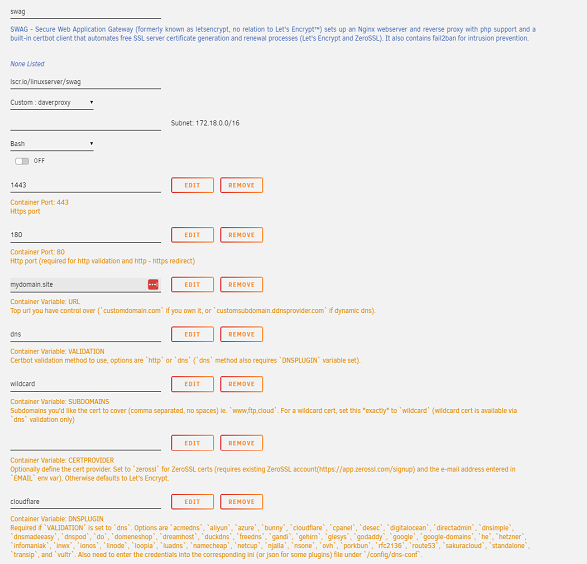

Daver1 Posted February 25 Share Posted February 25 (edited) 1 hour ago, Kilrah said: Could be that overwrite.cli.url needs to be httpS:// I actually tried both ways.. I am either missing something or my unraid system in holding onto to data from previous installs... since my last post above I have taken the following actions: 1. Deleted dockers: nextcloud-ffmpeg, Nginx Proxy Manager and Mariadb. 2. Run Appdata clean up. 3. Deleted my nextcloud share (using MC) 4. Used MC to check apdata is deleted. Re-installed nextcloud-ffmpeg following Spaceinvaderone video. I have the 502 bad gateway error.. I have tried the fix suggested in the video, it seems that my reverse proxy is not redirecting me to the nextcloud container. Edited February 25 by Daver1 Quote Link to comment
Kilrah Posted February 26 Author Share Posted February 26 I don't know SWAG much but you usually want upstream_proto as http. Quote Link to comment
Daver1 Posted February 26 Share Posted February 26 Hello!! we have progress! thank you, now on to the next issue ha ha. Quote Link to comment
Daver1 Posted February 26 Share Posted February 26 I have navigated this issue by adding the below line to the nextcloud config file. 'check_data_directory_permissions' => false, Quote Link to comment
