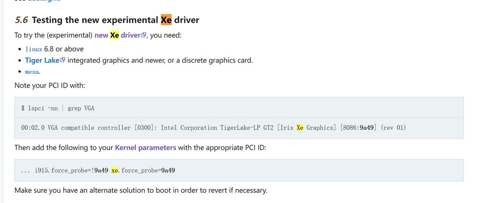

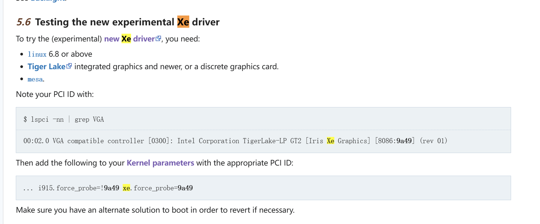

My unraid version is 7.0-beta2, maybe this method works on 7.0-rc1.
I didn't fully tested so you should backup boot drive first.
Enter termial, then type lspci -nn to get PCI ID
03:00.0 VGA compatible controller [0300]: Intel Corporation DG1 [Iris Xe Graphics] [8086:4908] (rev 01)
Then type those command:
vi /boot/config/modprobe.d/i915.conf
option i915 force_probe=!4908 (change to your pcie id, "!" is needed)
save the file, then:
vi /boot/config/modprobe.d/xe.conf
options xe force_probe=4908 (change to your pcie id)
then reboot.
After that, intel_gpu_top is didn't work, but you can see /dev/dri folder isn't empty and hardware transcoding works fine.
more details: https://wiki.archlinux.org/title/Intel_graphics

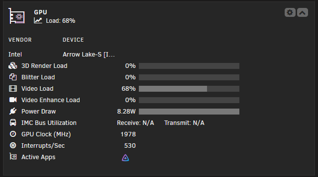

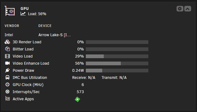

I have my Ultra 7 265K iGPU working with the Unraid 7 release with a custom kernel 6.12.9.
I assume this would work with the Arc GPUs as well.
It transcodes with my Jellyfin docker on stable, but need the beta version of Emby.
I used this guide https://gitlab.com/stefan99353/unraid-custom-kernel/-/blob/main/README.md
but used kernel 6.12.9 and Unraid 7 release.
It took a bit to get everything to compile, but it all seems to be working.
If anyone wants the updated files to try let me know.
NO WARRANTY or promises of course and I believe you can't use it if you use ZFS.
Now that it's compiled it's pretty easy to try, just drop the files on your boot USB drive replacing what's there and boot up.
Save the original files first and you can revert back if there's an issue.

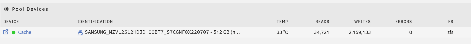

I really want to give it a try, but there's one issue: my pool device is ZFS and specifically set up for Docker. Do I have to change the ZFS format?

I'll be honest, I'm not sure. I've heard that ZFS support lagging behind on kernels is likely why Unraid 7 stuck with 6.6.
I'm just passing along warnings I've read while researching getting my iGPU working, I don't want to break your unraid with my build.
Maybe someone else can chime in with more info.
I can send you the files to try if you'd like, but I'd make extra sure you have backups; particularly of the cache drive.
When I had a failed kernel build I just had to put the old kernel back to fix my Unraid, but I can't promise all failure modes will be that simple.
