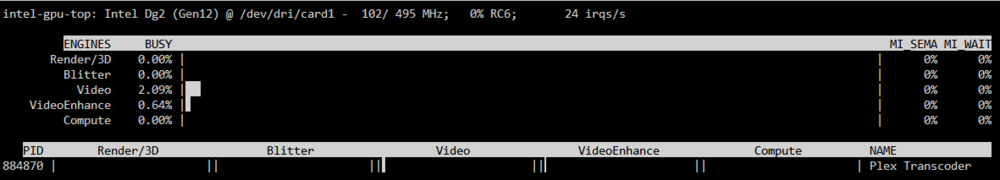

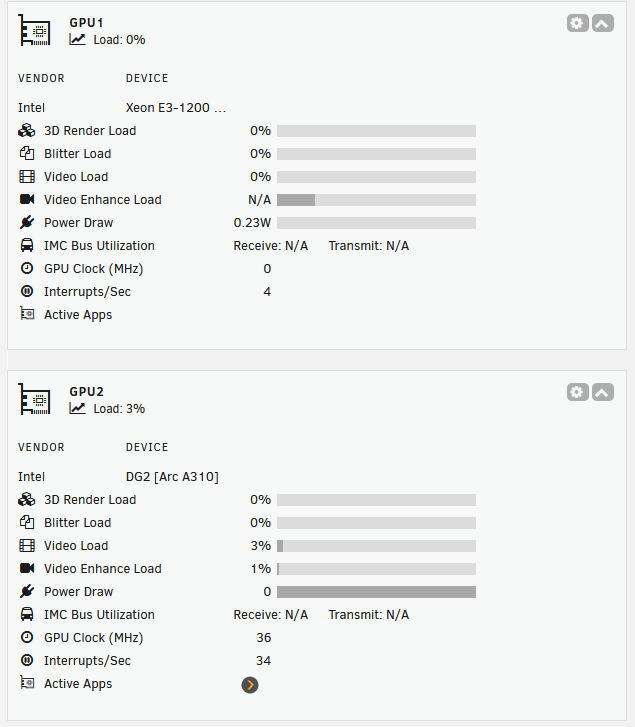

Hello, is it any way to see Arc 380 power draw? With nvtop I can see that GPU is there, without any stats
