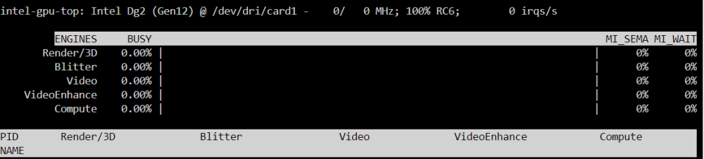

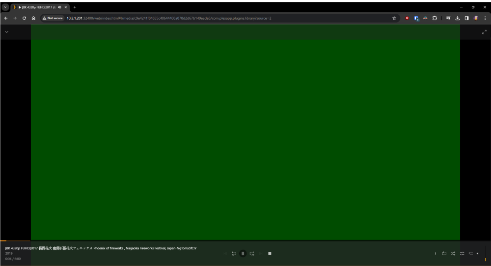

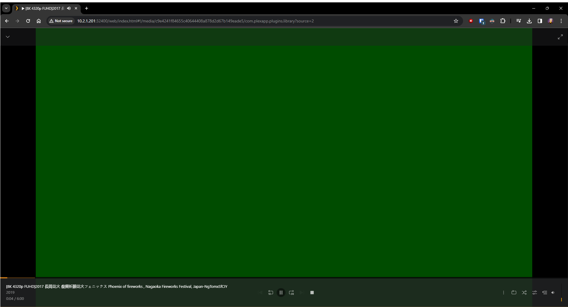

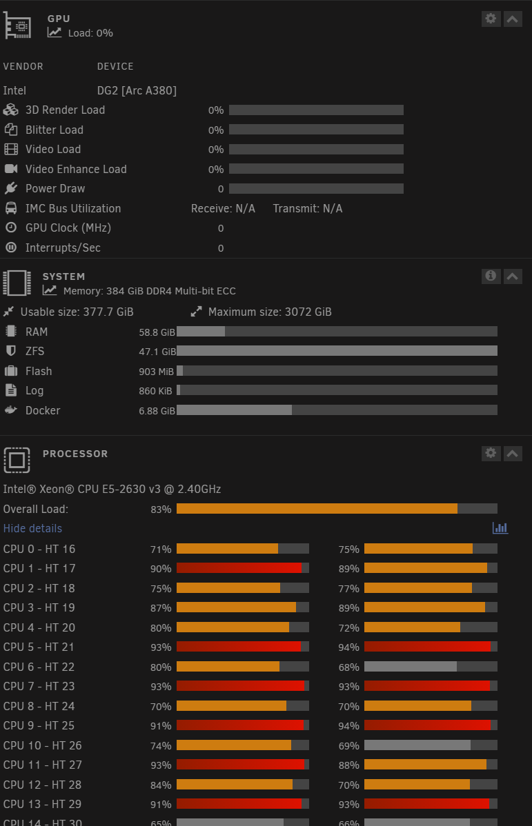

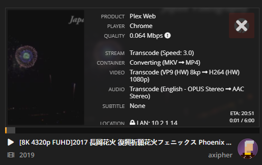

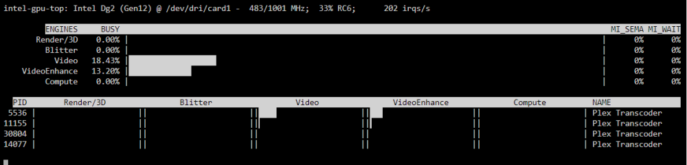

Just installed an Arc A750 in my server to upgrade from the 9700k iGPU.  The server also happens to have a GTX 750 Ti that I was using for a VM that I had seen reports of the Thor2000 custom kernel not playing nicely with Nvidia-Driver-Kernel.
I'm on Unraid 6.12.8 and used Thor2000 driver: https://github.com/thor2002ro/unraid_kernel/releases/tag/20240310 (
Linux 6.7.9-thor-Unraid+ x86_64)
My process:
  • Uninstalled Nvidia-GPU-Plugin
  • Shutdown server
  • Copied the bz* files
  • Installed GPU with same model HDMI Dummy Plug in the iGPU
  • Booted system
  • Updated GPU-Stat to show new DG2 GPU
  • Deleted all codecs from Plex Appdata folder
  • Added /dev/dri/renderD128 as a new device
  • Started Plex Docker
  • Changed Transcode Device to DG2
Initial testing was great, hardware transcoding now of AV1 content to H264, 1080p content typically transcoding at ~11x the framerate which is amazing.  GPU-Stat also show the usage properly.
Second set of tests on 4k content worked great as well, including VP9 and AV1 SDR and HDR content.  To note, I still have HDR tone mapping disabled in Plex since my Computer and main TV support HDR already so no need to tone-map.
Third set tests on 8k content was where it all fell apart.  Previously, my i7-9700k would struggle along to software decode 8k content then use the iGPU to hardware and very very very choppy.  With the Arc A750, it shows it as hardware transcoding now, the audio plays back flawlessly and the seek bar no longer skips and the transcode buffer looks to fill up quickly, but all I get is a solid green video output.  This applies to VP9 and AV1, SDR or HDR 8k videos.
If I switch Plex Transcoder from the Arc A750 back to the iGPU, it will Software Decode AV1 8k and Hardware Encode to H264 with some hitches as the software decoder can't keep up, but it at least works on all my 8k files.
It's just something with the Arc A750 that falls flat on its face when trying to Hardware Decode 8k Content, SDR or HDR.
My process:
  • Shutdown server
  • Booted system
I've just spun up Unraid on an r730xd and ordered an a380 and I'm having a ton of issue. I can see the card, I can select it for transcoding in Plex, I can see it on the dashboard as a GPU, but for the life of me, I can't get it to transcode anything. It just idles at 0% across the board and pegs my CPU's. I've tried everything:
1. Updated the kernel to 6.9
2. Installed Intel-GPU-Top
3. Updated GPU-Stat to show new DG2 GPU
4. Deleted all codecs from Plex Appdata folder
5. Added /dev/dri/renderD128 as a new device
6. Changed Transcode Device to DG2
7. Tried plugging in a monitor while the server is running
8. Tried disabling the onboard gpu (igpu does not show up on dashboard but shows in system devices)
You think I need a dummy VGA for the onboard gpu? I'm out of options here! I need a card for transcoding badly since my family use this server remotely and it's buffering like crazy for them.

First off, I must point out that I'm not an expert on Plex, Unraid or Arc, but this is my experience.
Also I can't remember if there are certain sub-title formats that will force CPU encoding, so make sure to try testing on something and turn off sub-titles just to make sure that isn't messing it up.  Audio might get CPU transcoded still, but that is a tiny load and shouldn't affect a server, especially yours with that many threads.
I'm currently Unraid 6.12.9 with this kernel from Thor2000: Linux 6.9.0-rc1-thor-Unraid+ x86_64.  I believe it was from the 20240331 release: https://github.com/thor2002ro/unraid_kernel/releases/tag/20240331.  I'm pretty sure it worked on 6.12.8 though with the 6.7.9 kernel as well from Thor2000.
I had a 3-pack of HDMI dummy plugs from previous QuickSync stuff so I installed one in my ARC GPU from day one, so I have note tested without it installed.
For my Plex config, I have a device setup as just /dev/dri.  I believe I tried going direct to /dev/dri/renderD128 or  /dev/dri/renderD129 but it sometimes wouldn't work so I just put in /dev/dri and then selected the card in Plex.
But since my system has a Intel i7-9700k, I have two Intel GPU's installed:
- Card0 is the 9700k iGPU and is linked to Render128
- Card1 is the Arc 750 DG2 and is linked to Render129
And inside Plex itself, under transcode settings, make sure to select the DG2, since I can select either Intel GPU there.  Then a restart of Plex docker is likely required:
Both show up in GPU Stats for me and while Transcoding, I see the proper DG2 get used:
Thanks, I went ahead and ordered an HDMI and VGA dummy just to see if that helps. I'll also try removing /render128
My hope is that with the VGA dummy, the onboard GPU shows up in the dashboard. It's weird that it shows in devices, but not there. I'll also try rolling back to the kernel you are using (I'm using the latest one which is one revision newer). Trial and error I guess! R730xd's seem to be a bit finicky, but I have 60TB of SSD's, dual Xeon processors and 365GB of DDR4 RAM and it would be a waste not to take advantage of it. I was using ESXi with VM's, but I really wanted to switch to Unraid and run a GPU passthrough for encoding.
Yeah, I would first try just changing the Plex Device to /dev/dri and seeing what GPU's you can select in Plex and then testing again.
Most reports I read indicated that the HDMI dummy plug is mostly needed for the iGPU to be used and not so much discrete GPU's, but also, does not hurt to have the dummy plug.  I'm not sure how it affects power consumption though, I know just installing my Arc card increased my power draw by a little over 15 W on my server so I'm assuming it's the card's idle power draw.
I can't see Linux kernel 6.9-rc3 breaking anything Arc related over 6.9-rc1, but if you can easily roll-back to the same version as me, at least it might be easier to troubleshoot.
