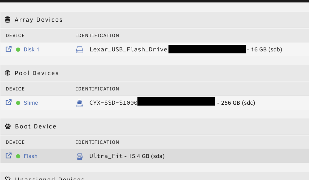

1 - If you're using a ZFS Pool, no trouble. ZFS manages any Parity/Cache operation. Leave a "dead" storage in the array to start container.
2 - If you're using the SSD within the array, the TRIM shall break the parity, so it's not functionnal.
Trim doesn't work with SSDs assigned to the array, so there might be some performance degradation over time, but parity doesn't break.

I find gyto6's note interesting, "1 - If you're using a ZFS Pool, no trouble. ZFS manages any Parity/Cache operation. Leave a "dead" storage in the array to start container.".  That sounds like there may be some instructions somewhere that would be helpful to people like me with respect to ZFS so direction to where we can learn would be appreciated.  The "dead storage" sounds like a drive that functions like a parity? drive or maybe not.  How would the dedicated "dead" drive be formatted?

Is it a matter of time until unraid supports ssd drives?
SSD drives are supported, the only caveat is that they won't be trimmed if used in the array, so some write performance degradation can occur, alternatively and if you don't require much flexibility expanding/removing devices, use a zfs pool for the SSDs, better performance since it can stripe the devices and has trim support.
