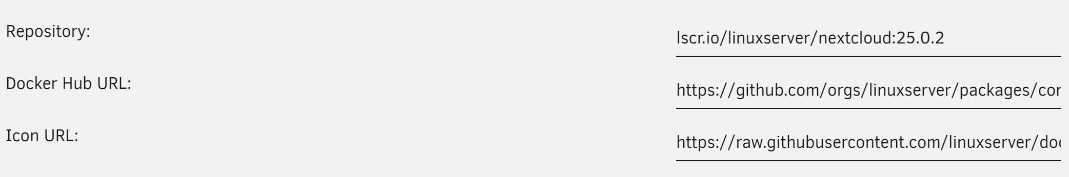

Asgard Posted March 25, 2023 Share Posted March 25, 2023 Thank you @startsomewhere & @g1an7 I was able to solve the issue with your help by switching back from lscr.io/linuxserver/nextcloud:latest to lscr.io/linuxserver/nextcloud:25.0.2 After booting up, nexcloud was in maintenance mode and I could apply the ooc upgrade command to upgrade all plugins. As you can see, without switching back to nextcloud:25.0.2 I was not able to get into maintenance mode before, cause of the "This version of Nextcloud is not compatible with > PHP 8.0," Error Message Thank you very much for sharing this solution. Quote Link to comment
Florian_GER Posted June 1, 2023 Share Posted June 1, 2023 On 3/25/2023 at 10:27 AM, Asgard said: Thank you @startsomewhere & @g1an7 I was able to solve the issue with your help by switching back from lscr.io/linuxserver/nextcloud:latest to lscr.io/linuxserver/nextcloud:25.0.2 After booting up, nexcloud was in maintenance mode and I could apply the ooc upgrade command to upgrade all plugins. As you can see, without switching back to nextcloud:25.0.2 I was not able to get into maintenance mode before, cause of the "This version of Nextcloud is not compatible with > PHP 8.0," Error Message Thank you very much for sharing this solution. Thanks that solved it for me ;) Quote Link to comment

Eurotimmy Posted November 29, 2023 Share Posted November 29, 2023 I found I had this same reported issue today (29 Nov 2023) - Additional info from 25 June 2023 - - Upgrading from the Admin Web UI is no longer supported: https://info.linuxserver.io/issues/2023-06-25-nextcloud/ This is how I got back to running just perfectly (based on the above info). 1. Edit the 'nextcloud' config via the Unraid UI (change "Repository" to "lscr.io/linuxserver/nextcloud:25.0.2"... 'Save' and this will restart the container on image 25.0.2 2. Did as described at the beginning of this thread by @g1an7 On 2/23/2023 at 4:48 AM, g1an7 said: Then went into the UI Terminal for UnRaid and ran to upgrade Nextcloud plugins: docker exec -it nextcloud occ maintenance:mode --on docker exec -it nextcloud occ upgrade docker exec -it nextcloud occ maintenance:mode --off 3. Edit the 'nextcloud' config via the Unraid UI (change "Repository" back to "lscr.io/linuxserver/nextcloud"... 'Save' and this will restart the container on the most current image (as of today that is 27.1.4) 4. Watch the log files of the nextcloud container... -----Start Output------ - - Migrating legacy install (this can take a while) ...) Initializing nextcloud 27.1.4.1 (this can take a while) ... Upgrading nextcloud from 26.0.1.1 ... - - Starting code integrity check... Finished code integrity check Update successful Turned off maintenance mode Resetting log level Initializing finished - - /config/nginx/site-confs/default [custom-init] No custom files found, skipping... [ls.io-init] done. -----End Output------ And now all is good again for me! Thanks to all contributing above. Quote Link to comment
