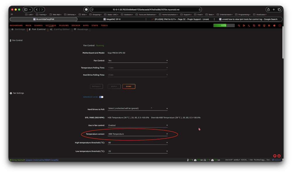

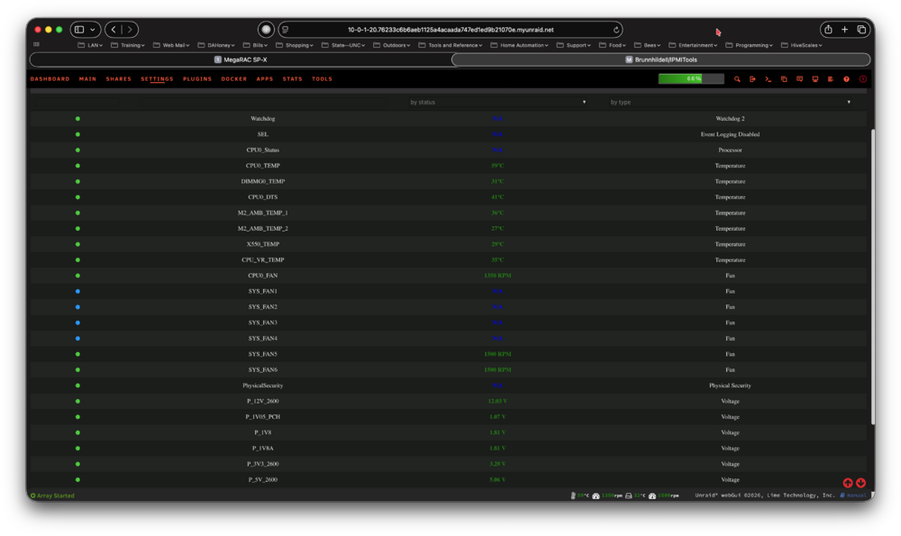

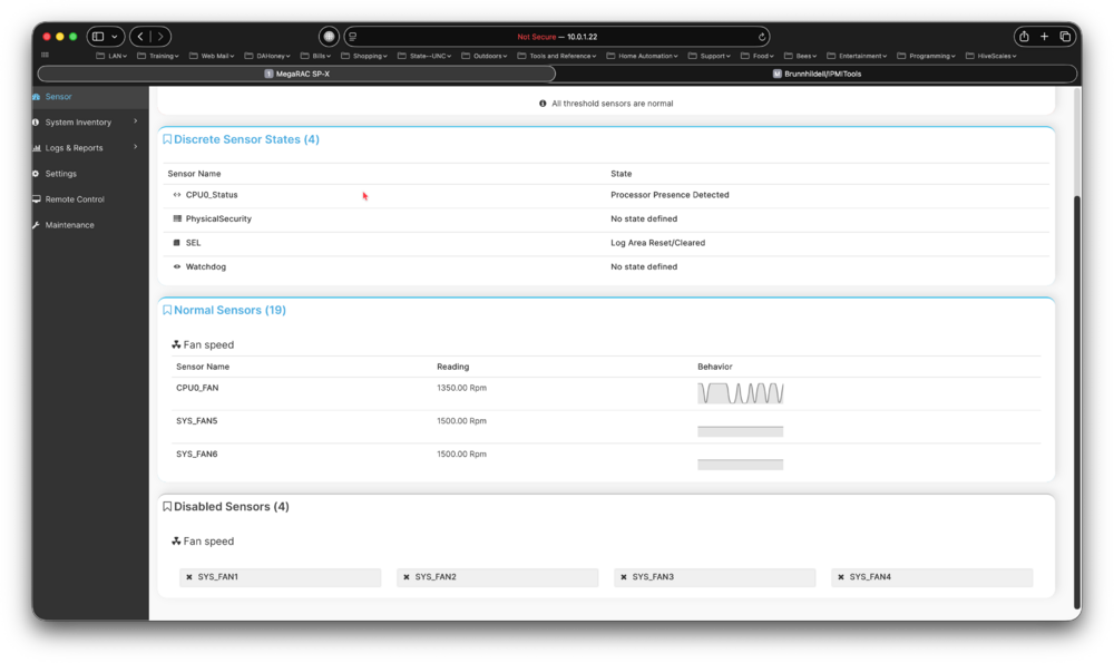

I'm seeing something odd in IPMI fan control settings on my MW34-SPO.
When I look at sensor readings Fans 1, 2, 3 and 4 all show N/A. All six system fans are configured the same though.
In the IPMI Viewer I see this-
SYS_FANS 1, 2, 3 and 4 all show disabled.
Maybe the X15 server only uses 5 and 6?? Or maybe I have something configured improperly?? I'm not sure where to look??

Sorry for the late reply they only use two headers for the chassis fans and one for the cpu
Thanks. I’m not controlling the cpu fan. Left that to the system.
